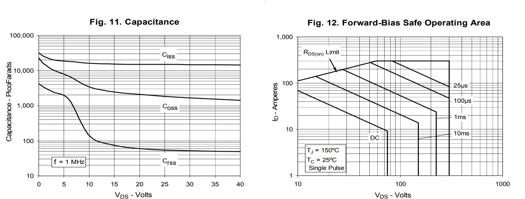

Looking at the SOA curve, we see that it is a 90 watt part at 30V, and
that assumes 25 deg C case temperature. With a 30V rail and an ordinary
heat sink you will probably enjoy safe bias currents at an amp or so.
Not that you shouldn't go ahead and try it....

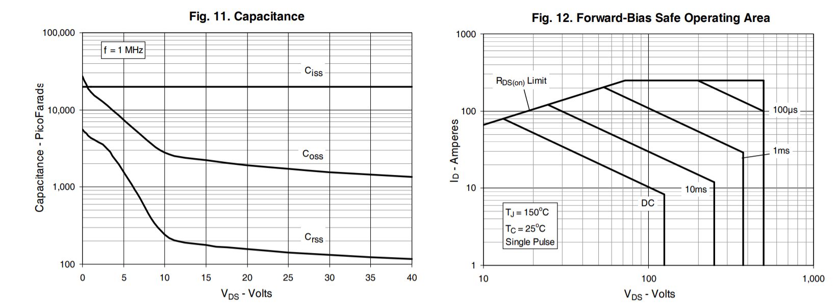

I get your point. The SOA is pasted here.
So, if the voltage is dialed back to 20V, then 7A is inside the DC SOA and 3A bias may be safe?
The other question is how small can the Aleph sense resistors be and the circuit still function as an Aleph?

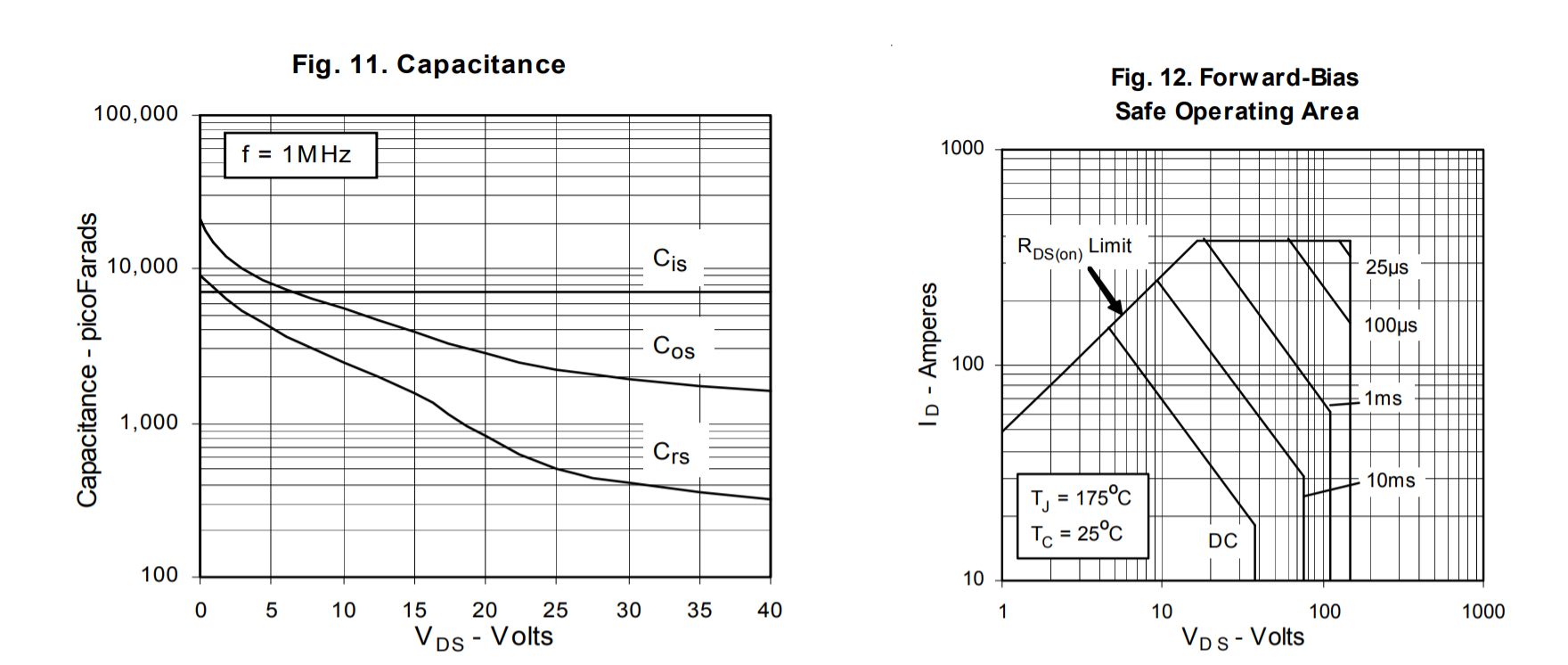

IXFN160N30T

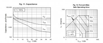

From and SOA standpoint, this puck may be a better candidate for a high current single device Aleph. It is the IXFN160N30T. The datasheet does not show DC SOA but the DC SOA should be not very far inside the 1ms SOA curve. 5A at 30V should be safe for this device.

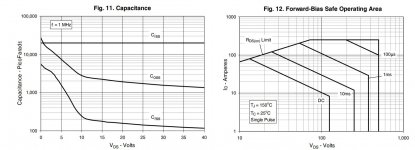

IXFN140N30P
This device looks promising. 700W DC Dissipation. 70A at 10V to 10A at 70V in a straight line.
In the 20V to 30V range, this part should have no problem being biased at 3A to 5A. 3A bias at 20V would be less than 10% of rated dissipation while 5A at 30V would be at 21% of rated dissipation. ....and.... it is not the most expensive puck on the ice rink.

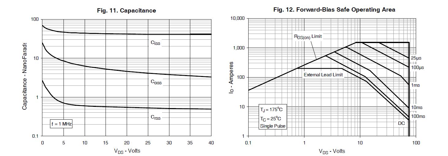

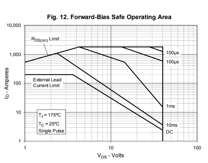

IXFN180180N15P
This one is almost identical to the one just above. This one has a DC dissipation 680W vs 700W for the one above. The SOA curve pasted here starts at 1V where the device just above starts its SOA curve at 10V.

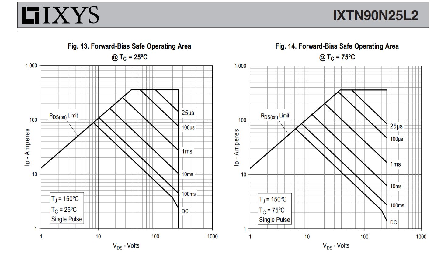

IXTN90NL25L2
Here is a third candidate. DC power dissipation 735W. Very similar SOA to the two good candidates above.
The interesting thing about this datasheet is that it shows SOA for Tc of 75 deg C. SOA decreases by almost 1/2 comparing 25C to 75C.

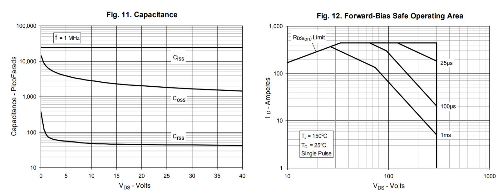

IXFN100N60P
Edit: part number IXFN100N50P
Here is the grand daddy of them all so far. 1040 watts DC dissipation.
At 30V Vds, the highest SOA current would calculate to 34.7 amps. That is about were the SOA curve is on the attached graph.
The capacitance curves are nicely behaved at 30V.
So far, this is the favorite for being able to bias it heavily.
