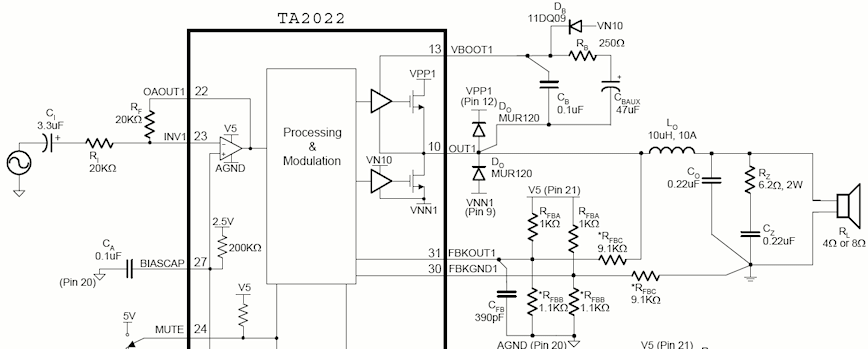

I bought not one, but two HLLY Tamp-90's. They are so NOISY with HISS that you cannot listen to them.

The datasheet says 150uV output noise for the application circuit given, so there is probably something wrong with HLLY implementation.

Since the problem is "hiss" and because this amp has a volume control, the first thing I would do is check the gain of the amplifier. This is controlled by the resistors on the input-- Ri and Rf on the data sheet. It's possible they have simply set the gain fairly high so that the volume control would have more range. So there might be a very simple fix--just reduce the gain so the noise from the input stage doesn't get amplified as much, and use a low-noise op amp if that gain is needed.

The Tripath reference circuit is designed to give a voltage gain of 18, which is a bit on the low side (1/2v signal on the input will only result in a 9V swing on the output). HLLY may have increased the gain to make the amp more versatile, and provided a volume control so that you can attentuate the input. However, any noise in the input circuit of the TA2022 will get amplified by the gain, so this MIGHT be the source of the hiss (although, as others have pointed out, there may be other causes).
The gain of the TA2022 is set by the resistors in the feedback loop for the input op amp and by the feedback for the modulator. If HLLY increased the gain, it is most likely that they did so by adjusting the feedback resistors on the input op amp--Rf and Ri on the attached schematic. You need to follow the traces from pins 23 (channel 1) and 26 (channel 2) and read the values on the tiny resistors that are connected to these pins. The input amp gain is simply Rf/Ri, and the reference design shows both resistors as 20K.
So get out your magnifying glasses and see if you can read the markings on these resistors.

a couple of things jumped out at me. First Rf/Ri dominates the gain. in the previous image both are 20kΩ so gain is unity. To reduce the gain, a resistor change would be required. and a capacitor change as well (although if the change is small perhaps capacitor change may not be required?)
to calculate Ci:
Ci=1/(2*π* f *R)
where: R = Input resistor value in ohms.
f = Input low frequency pole (typically 10Hz or below).
Also Cfb1 and Cfb2 should be 390pF and 560pF respectfully (not the same value.. an apparent source of audible noise).
So I guess a place to start might be with Ri, and Rf, followed by Ci. And check for the values of Cfb1 and Cfb2.. after that ?????

I did all the ******* cap add ons that they said for no result just a waste of time, i tried grounding certain areas with no result, even took the pot off and used it as a power amp for still the same bloody hiss. The only difference that had some result which was just an experiment was to make an l-pad before the speaker terminals, this reduced the damn hiss considerably.
Looked like they had too much gain for one thing and the board layout was probably not optimal, but these are just my uneducated guesses.
After weeks and weeks of emailing hlly with no success and getting vague responses and getting pissed off at them, i finally put in a dispute to paypal but i didn't want a refund and didn't want to pay to send the amp back because i wanted them to fix the problem for all rather than selling crap to the public.
What i fought for was for hlly to make a new bloody pcb and to reduce the gain. Well finally two days ago i received the version 2.2 pcb and hallelujia it is night and day the results. The hiss is all but obsolete and the sound comes in from a darker background now. So i am happy, just not so for having to do all this crap, but if it helps others well good.
So in essence, i would if anyone else has bought one or considering buying one of these is to make sure you gat the version 2.2 board inside as this is now a very good amp with it in. And the build quality is a plus.
