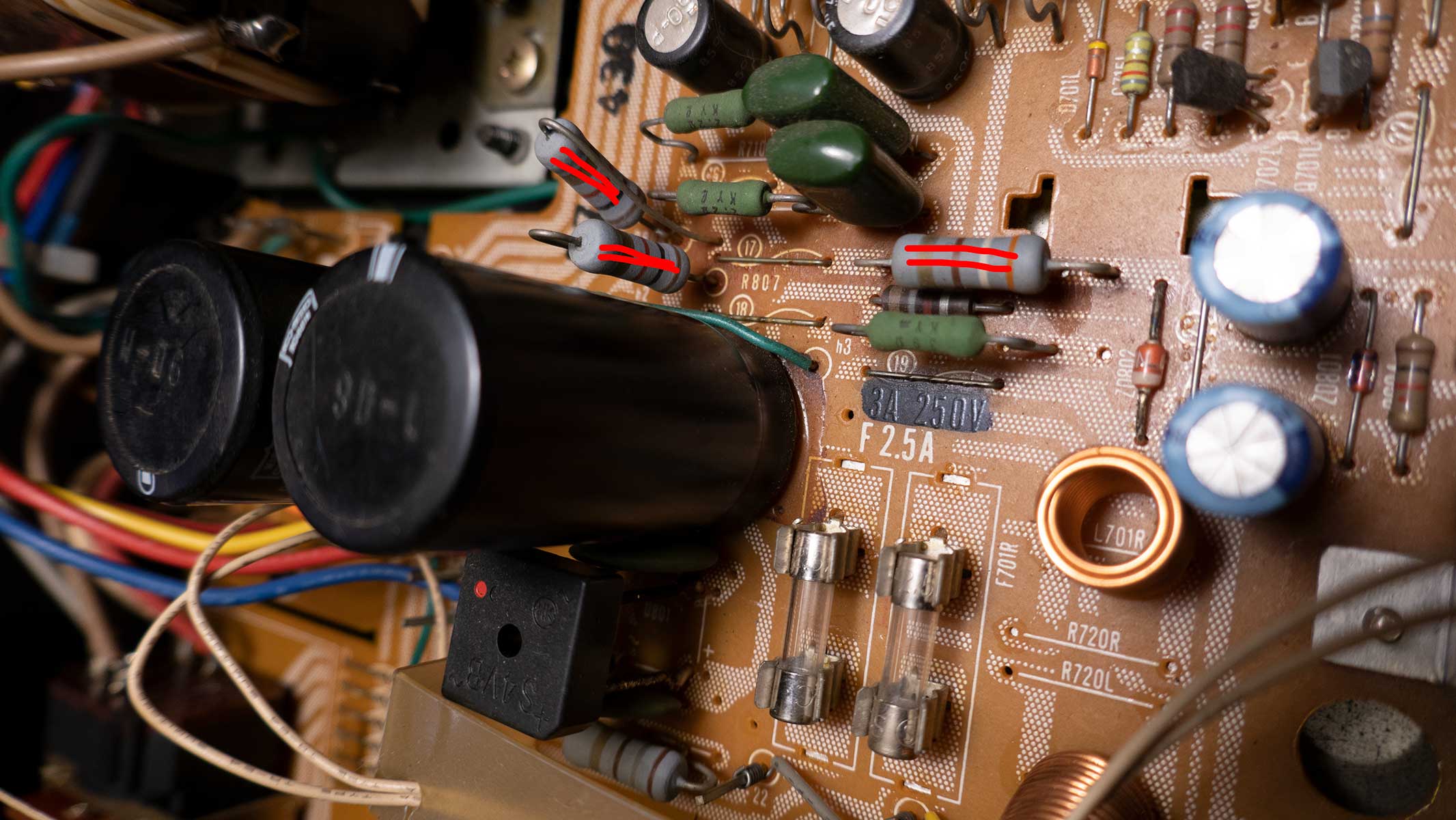

I got this receiver as not powering up. However it does power up, but I get 25V DC on both channel output(speaker) terminals. With headphones I can hear faint radio. And I did not attach speakers to blow them up!
Is it correct to assume that the Darlington STK00300's are dead-shorted? Or something else is possibly wrong?
Transformer puts out 2x25V AC and gets rectified to +/-34V. Output circuit breakers are not blown.

Also the 400R 1W resistors heat up in 5min but not to scorch. On the picture marked with red stripes.

Without a schematic and not being there to probe around, I can't really be certain, but I'm thinking it most likely is the outputs.
What test equipment do you have?
Having the same voltage on both outputs may also indicate a broken ground connection or a power supply issue (like a bad rectifier diode). Usually if the outputs are dead short you are seeing close to a supply voltage. It seems unlikely (though not impossible) that both STKs would have failed in the exact same manner.
So I would check supplies and try to find the feedback network and where its ground connection is, or alternatively find the input pair and determine the differential voltage between both inputs.
At least one of the marked resistors appears to be feeding a zener diode (ZD802), some dissipation is entirely expected there. You're good as long as the zeners aren't shorted.
Well, I got the service manual today and the main problem is fixed. There is a R709 100R fuse resistor that was blown(showed 24K instead). I replaced it with temporary resistor and all the V's are close to normal. Output speaker terminal show 0.26V and 0.4V. I hooked up my test (junk)speakers and I got sound.

Some of the V's are a bit too high. Maybe it is due to 220V transformer getting 240V. There's supposed to be about 30.6V powering most of the transistors, but I get 34V. Also left and right channel is a bit different voltage wise. Should I worry or leave it?
Also the 2W resistors are getting warm still. I did not run it for long so I don't know how hot these will get but usually I have seen these being about 50-60*C.
BTW I ordered replacements for transistors C548 that supposed to be flaky. These were very cheap(substitute BC549 1EUR for pack pf 10) so I may just replace these. Moreover someone has done some repair on one of these and damaged PCB rails.

This is not the first device I repair(it is the hobby of a sort) so Current Limiting Device is in my toolbox for long time already. I am in the stage with this receiver where all test-point voltages are acceptable - everything runs a bit(10%) hot due to our mains is 10% higher(240V).
I have some crappy car speakers I buy for 10cents a pair that I use for testing. Have not lost more than one so far. So when I hook these up the I get normal (radio)sound through the speaker terminals.

I made a serial of three 10W 12V (halogen)lightbulbs. When connected to speaker terminal there is nothing - no light what so ever.
I am a bit worried about the 2W resistors R805/6/7 getting hot(60*C) or maybe it is normal. And I did not replace the blown resistor R709 with fusible. Or should I?
Otherwise it seems to be working normally.
