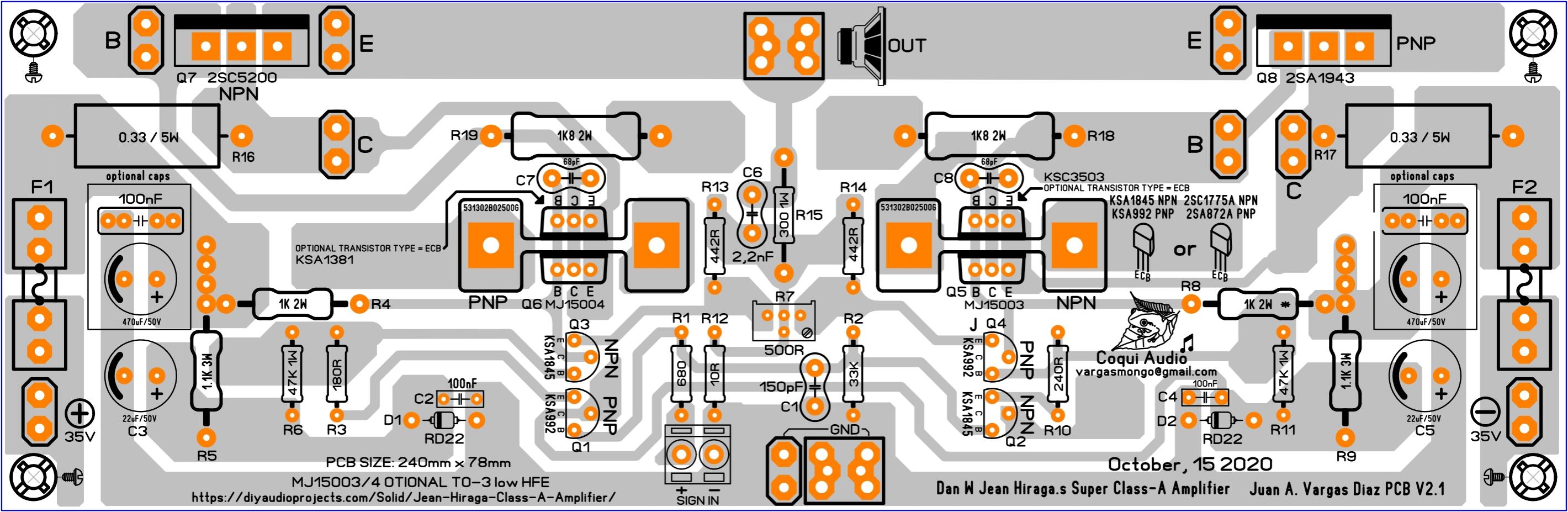

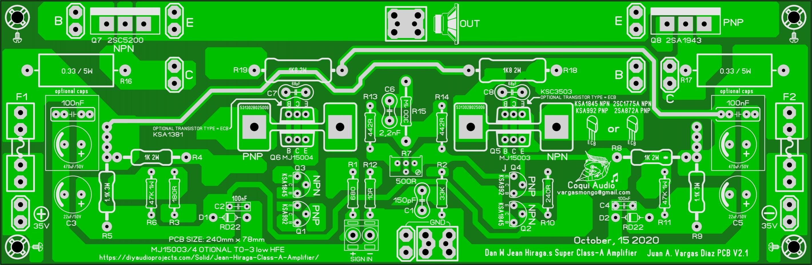

hi I'm looking for a section that covers bias on the Hiraga 30W class A this is a prototype PCB I made I chose those modern transistors but I'm not sure if I can use the values from this website I need advice oh this PCB is double layer
and here is the website link Jean Hiraga's Super Class-A Amplifier
Hiraga's circuit relies on very high Hfe input diamond circuit with A872/C1775. The bias is achieved by the input emitter resistors 180/240 ohms as well as 47k feeding then. If alternative transistors needed, BC550c/560c or A970 /C2240 can also considered.
