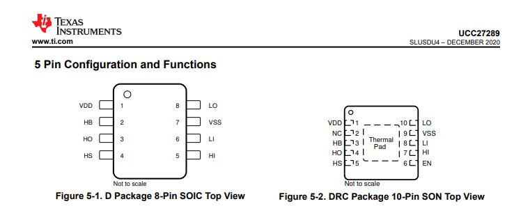

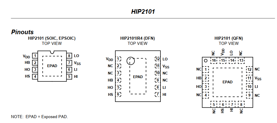

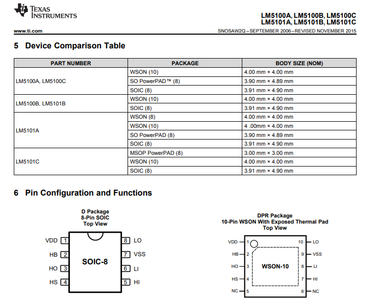

P peeby Member Joined 2020 2021-05-01 9:34 pm #3 2021-05-01 9:34 pm #3 Octopart suggests a UCC27289DR. Pinout is different. P Perry Babin Member Joined 2003 bcae1.com 2021-05-02 12:25 am #4 2021-05-02 12:25 am #4 There are some diagrams that are used to show function and others with accurate pin configurations. Yesterday, they were recommending the 5101. How are the pin configurations different? Attachments IC003.png 49.7 KB · Views: 87 IC002.png 70.5 KB · Views: 80 IC001.png 33.1 KB · Views: 81 You must log in or register to reply here.
