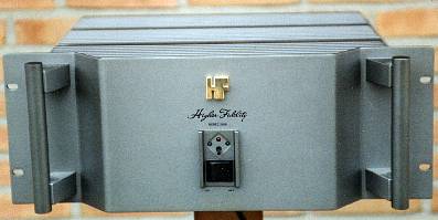

What does the EQ-3003 look like?
It looks like a million bucks😀

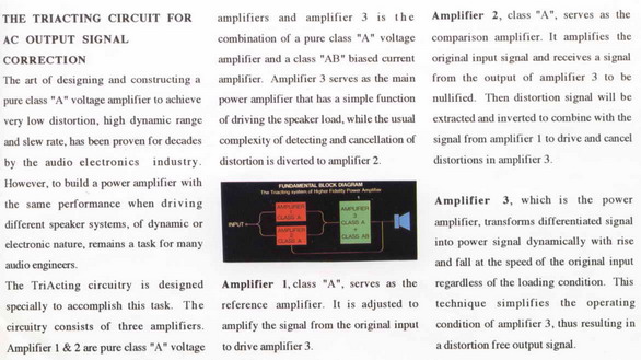

Interesting info in this brochure:
http://www.angelfire.com/az3/dimitri/images/HF-01.pdf
