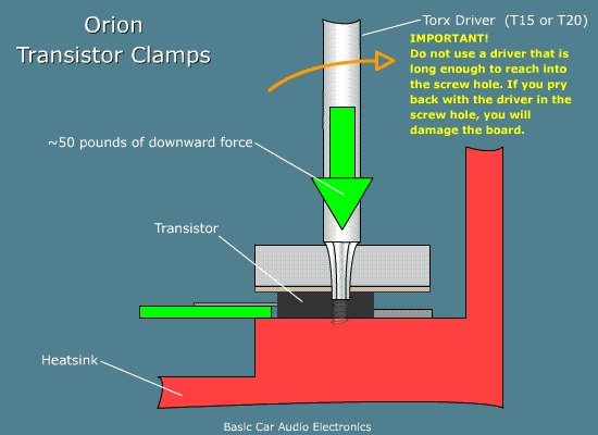

When you remove the clamps, try doing it as shown in the attached image. Start close to the end of the clamp and work your way to the other end.
The fluid is electrolyte and it's corrosive. All of it needs to be removed with a cotton swab and a good solvent like acetone. Read the warnings on the acetone container if you've never used it.

Wow! I was editing my post to let you know I got the clamp off, and meanwhile you posted the instructions on how to do so.
Is there any reason I should take the clamp off the other side?

If the transistors are not stuck to the insulator, it will be easier to work on out of the sink. If the transistors are too difficult to remove from the insulator try to repair it in the sink.
I'd suggest replacing all of the power supply transistors if even one has failed (other than the power control transistor). It's imperative that all that are running in parallel be matched. Both sets of transistors were subjected to the same conditions. If they didn't fail, they were likely pushed to the edge and may be weakened. The parts are less than $1 each.
On the second amp you can see if replacing the cap will get it going but it's likely to have more damage.
Be careful with the insulators. If they are torn they will need to be replaced.
When taking the screws out you may see some tiny metal shavings near the screw hole. If 1 tiny fragment gets under any transistor, it will cause the amp to fail again.
All of the double-sided tape needs to be replaced. All of the old tape must be removed from the transistors AND the clamps. A bench grinder's wire wheel works well (don't use the abrasive wheel). When replacing the tape, leave the backing on the tape so it doesn't stick to the transistors.
