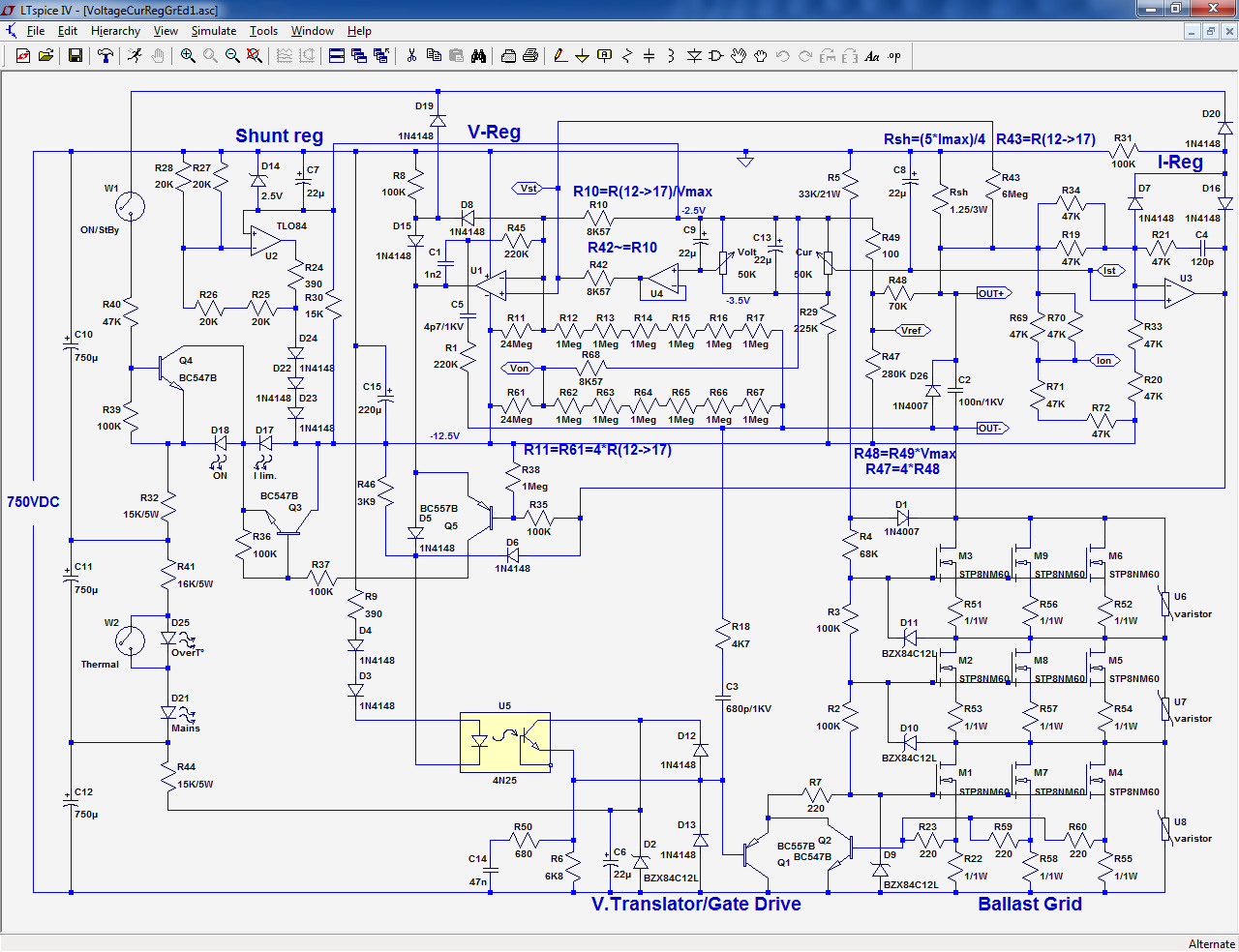

Well well, so 1 amp isn't large? At 300V, it's still 300W... different people, different points of view (and if it has to be clean++, that means purely linear).So current is not a large need but something that would have 1 amp available would be nice.
Note that I have such an animal in my files, problem it's not in electronic form, and it was basically for my own use, thus not very understandable by somebody else (even I, after 5 or 10 years would probably have difficulty putting the pieces together).
I can tell you for sure that a good HV lab supply is not something exactly easy.
Ill try to see if there are useful bits I can post.
In the meantime, you can have a look at a project I have posted, it is a mix of a switching pre-reg with a linear post reg; it achieves 0-400V and a 1 amp capability, but not at the same time: total power is limited to ~60W IIRC.
It does work well, and if it is well done, it combines the effectiveness of a switching supply (on the cheap) and the cleanliness of a linear supply.
Edit:
After all, I have something in electronic format, but this one is a real monster, a 0-700V 1A one, but it gives you an idea of what to expect...
NOT SOMETHING FOR BEGINNERS!!!

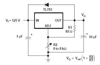

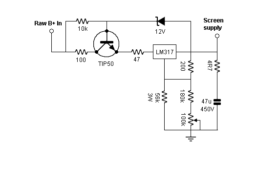

Here is another circuit you could modify. Or if you could live with a 120v reg. you could use this. I know both of these have a minimun output of 1.25v but if you just had to have 0v output a cheap fix might be just 2 diodes in line with the output to drop the voltage about 1.3v .
Usually there's a capacitor to ground on the adjust terminal, with a discharge diode between the adjust and output.
