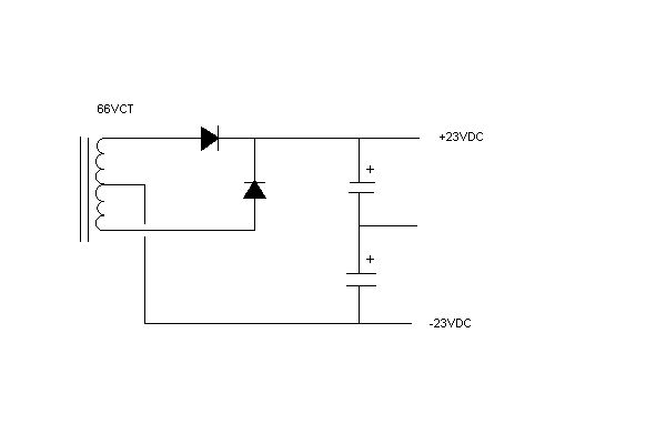

if i make half wave rectifying instead of full wave, how can i estimate the dc out?? would [ (VAC/.7) - .7 ] /2 be good?? in that case it would be +/-23VDC... if this works, in most gainclose i always seen people using simply 1000uf caps, what value caps should i use??

something like this perhaps??
i am using multisim to simulate and for some reason when i put in an electrolytic capacitor the simulation did not come up right so i had to create these 1000uF non electrolytics...
the scope is showing vac in (top) and vdc out (bottom), the meter is showing vdc rms.. i guess just a high current diode would be fine?

Unlikely this will work. You can't create a solid ground reference from two capacitors.leadbelly said:I think this is how it'd work:

with no load the dc out will be your usual ac*root2
if the caps are big enough to charge then supply the current during the missing alternate cycles under load it will stay up close to above but current thru diodes will be at least double the average draw
when the caps run out before the next cycle starts the voltage "ripples" so the average measured by a meter
is lower, depends on the draw
ps paulb is correct - correct reference: the one way symmetric diagram *using only half (ct-one side) of your winding* on the link joensd

Hi Chris, I agree with others. 33VAC would be too high after rectification and filter. I built mine with +/- 38 volts and it drive My Apogees Stage without problem. It sound gorgeous on my stages as a matter of fact, though I think you have to mate it with a smooth and laid back, usually Tube and/or non-feedback solid state preamps. It may turn hard with the usual high feedback preamp. You can certainly use just one side of the tap, then use it as a single supply design as in the National Application note. Hope it helps
leadbelly, the transformer is already center tapped so i would use the circuit i posted on each tap to make +/- voltage..

No, you can't use all 3 taps and have it work. Reread davesaudio's post.

i reread davesaudio's post but i still dont understand wh wouldnt the below circuit work?? using all 3 taps for +/-. i simulated a center tap by tying the two vac sources together
negative voltage has diode in other direction
