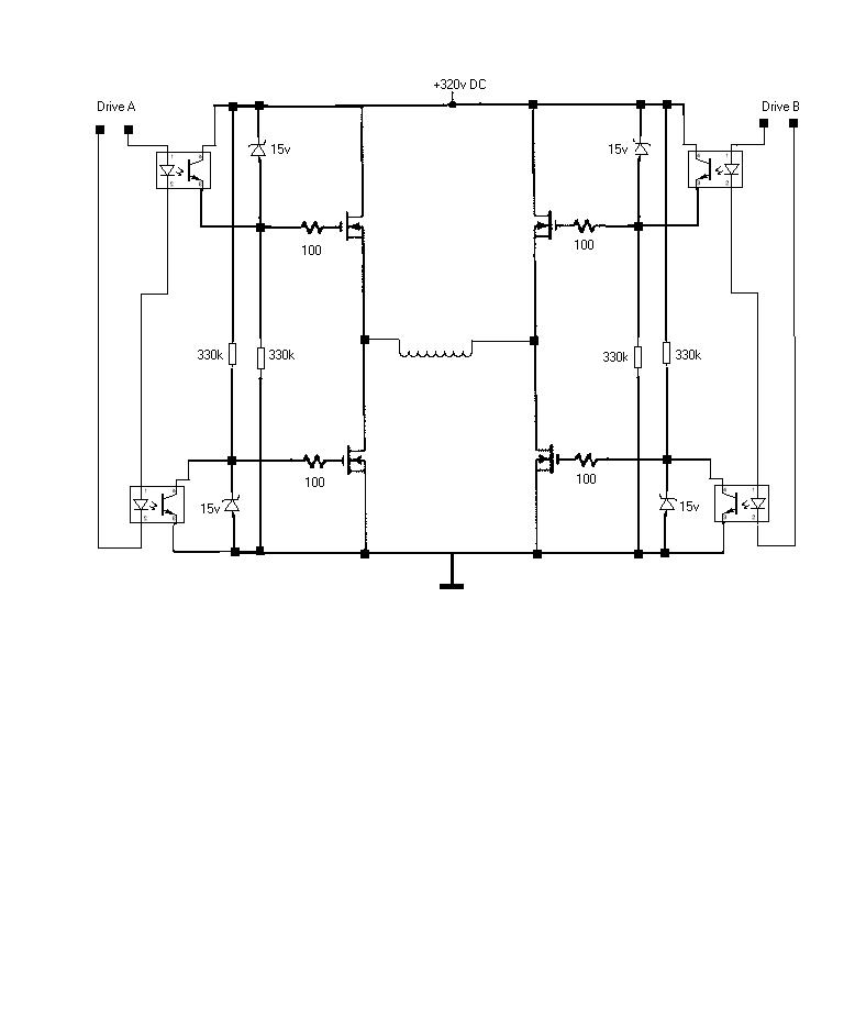

The high side is all wrong, it could drive a P-channel MOSFET instead but then both sides would turn on at the same time...
Optoisolators are slow and one way or another you'll need some kind of bootstap power supply to charge/discharge the upper side, its easier with gate drive transformer or a gate drive IC.
Optocoupler seem to be quite fast in this application . Im having a lack of ir21xx series ic here and I also hate winding transformers. This is the only reason for a sudden forced design...
