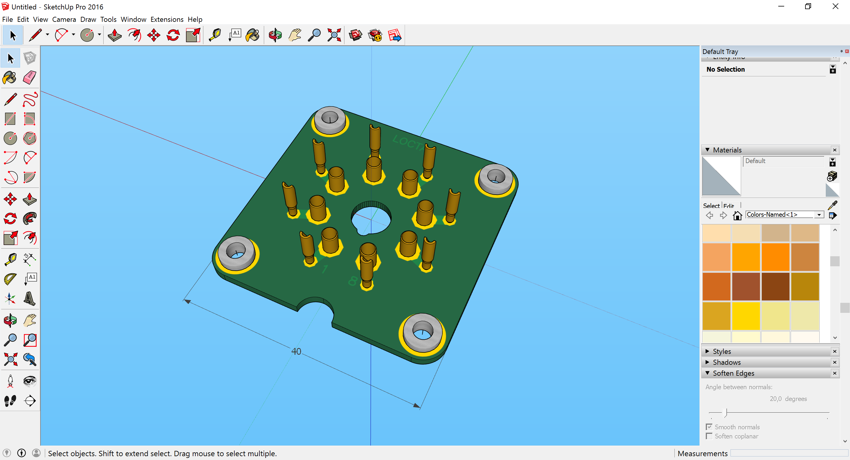

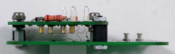

Consider using K&K AUDIO/Keven Carter's PCB with sockets soldered in and isolation as part of the package.
I had tried some of the sockets available and find the "feel" of the pins inserted into his board to give the most confidence of a sure fit without the feelng the pins are being stresed.
http://www.kandkaudio.com/wp-content/uploads/4P1L-socket-board-top.jpg
Might not work for everyone but for those it can one can say this is an elegant solution.
