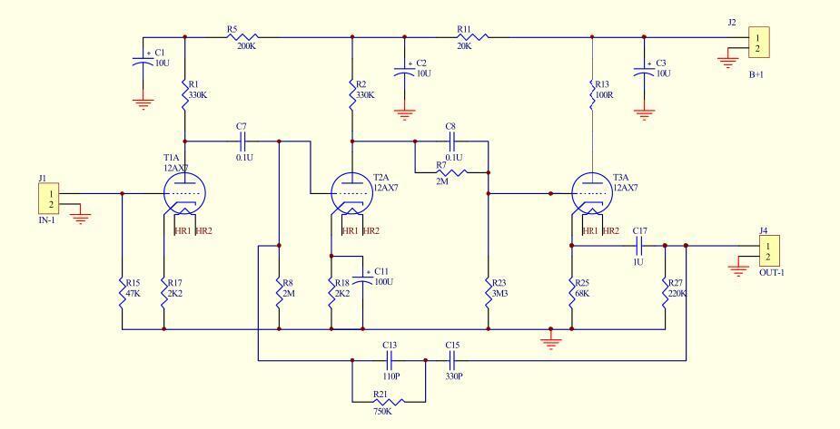

That's way too high for an MM pre. I'd definitely look into reworking it to a more reasonable 35-40 dB of gain, rather than attenuating what has been unnecessarily amplified. Do you have the schematic?around 55dB
Does the pre-amp have a volume control or is it just a black box? If it has try turning it anti-clockwise, it usually works. 😳
It's a Chinese EAR 834p without a gain pot (gold and black circuit board).
The gain is useful for high output MC.
Try placing a 47K resistor between J1,1 and T1a grid, effectively attenuating by 6dB, if still too loud then increase resistor to say 100K. If too low then decrease the resistor value until suitable volume reached.

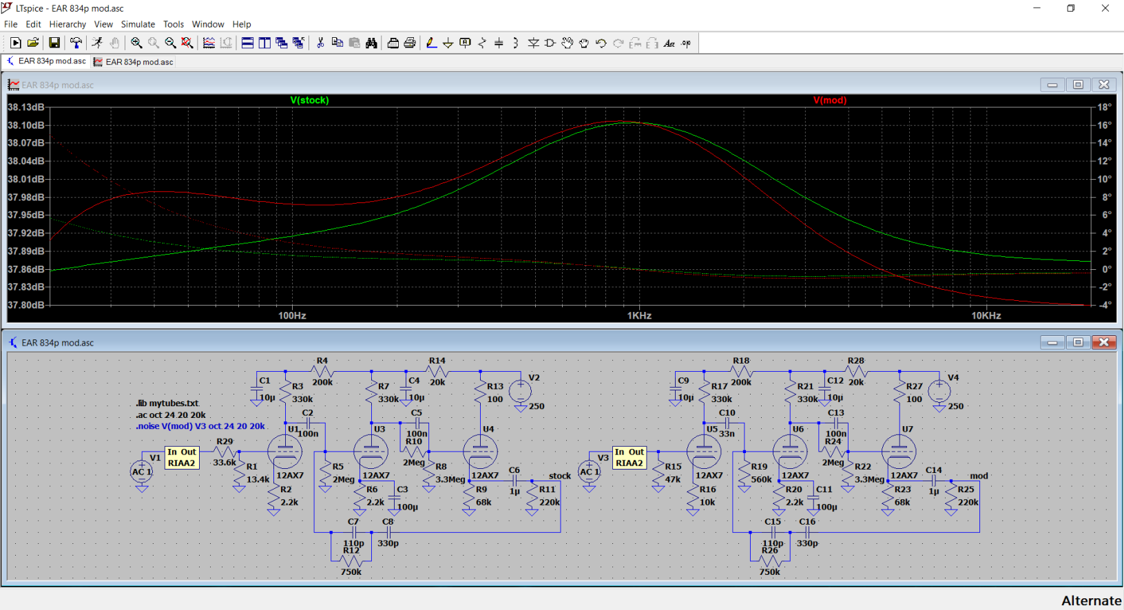

See attached. I get an actual gain for the stock circuit of ~49 dB, this may be due to the 12AX7 model I've used. The 250V supply is just a guess. Anyway, by replacing:
R17: 2k2 -> 10k
C7: 100n -> 33n
R8: 2M -> 560k
The gain drops by ~11 dB to ~38 dB, which is pretty standard for an MM pre. I've simulated the stock one with a voltage divider at the input adjusted to match the gain of the modded one so I could compare the curves better. The stock RIAA accuracy is +/- 0.13 dB, the modified one is +/- 0.15 dB, so negligible in practical terms (note the dB scale on the graph). In terms of noise, the stock + voltage divider gives a 20-20k RMS noise of ~361 uV, the modded one ~99 uV, so around 11 dB better, as expected.
You may want to give this a try, it's just half a dozen components and easily reversible if you don't like the result. Use a good quality PP cap for C7, like a Wima FKP.
