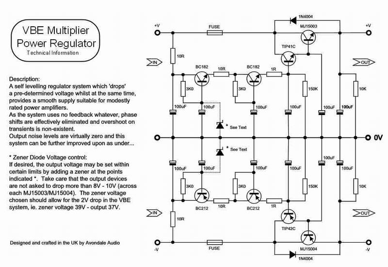

Amplifier regulators
Here you are. I'll have to dig up the component values. (post those later) But, the schematics give some idea of the circuit complexity. In the article they note the results (max power output, distortion etc) on a Reg. Williamson power amplifier. The unregulated version put out 44 watts (8ohm) and 52 watts (4ohm). With this regulator it put out 62 watts (8ohm) and 81 watts (4ohm) . Distortion decreased by better than 50% over the unregulated version.
Now I know that many feel that specs mean nothing, but, the numbers at least give an idea of operating performance.
Oh yes, the power devices of the regulator must be properly heatsinked.
