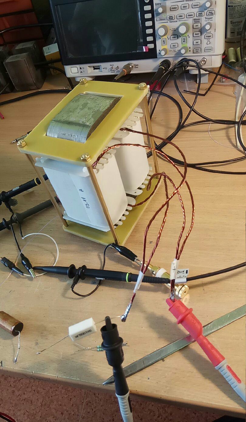

These are some of our products. The last two images are the housings in which we place our products, respectively aluminum and steel.

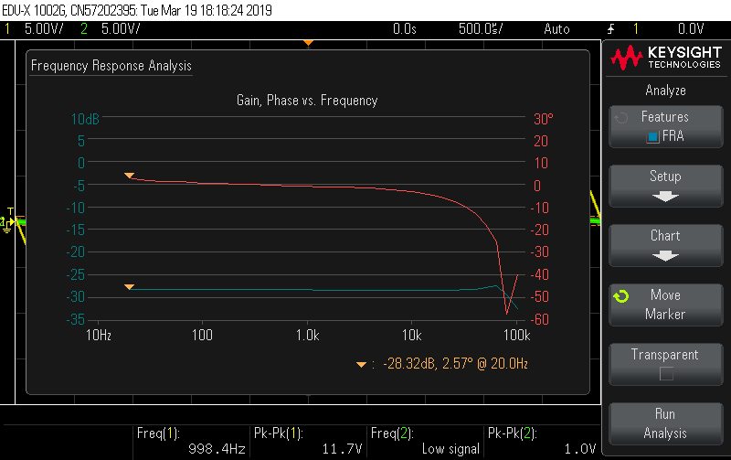

New real High End output transformer SE for 300B or similar tubes with nanocrystalline core.
QSN10-31
Inductance of the primary coil: 26.157H
Turns ratio: 24.2
Primary impedance: 3.5kΩ
Secondary load impedance: 6Ω
Bandwidth (-3bd, secondary grounded): 20H - 73kHz
Leakage inductance: 3.1mH
Parasitic capacitance: 3.58nF
Primary DC resistance: 137Ω
Secondary DC resistance: 0.099Ω
Price: 550EUR with VAT, Promotional price: 385EUR with VAT
