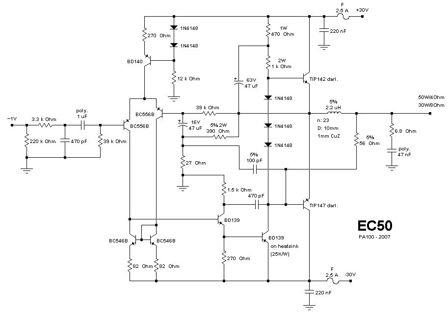

Placing
Green lines are wire links, blue line is the heatsink of BD139
http://forum.audiodiy.hu/download.php?id=2058
2.2uH coil is air-cored, 23 turns of D=1mm enamelled cooper wire, on 10mm former, length is 24mm
Amp performance: THD and IMD <0.01%, ...50W, 20Hz...20kHz

Lumanauw, see the following links for working method of my amplifier:
http://www.google.com/patents?id=t6I7AAAAEBAJ&dq=3970953
http://forum.audiodiy.hu/files/ec50_m_460.jpg
Be careful, the attached schematic is only a test version, a prototype, It's not a final version!
There is a fault in the circuit and on the PCB-placing: the three 1N4148s in serial need to be three 1N4002s in serial!!!

Hi Donk,
Where can we see a final version of the schematic and PCB layouts?

have you ever realized the final version of your amp?
If yes, what about stability?
