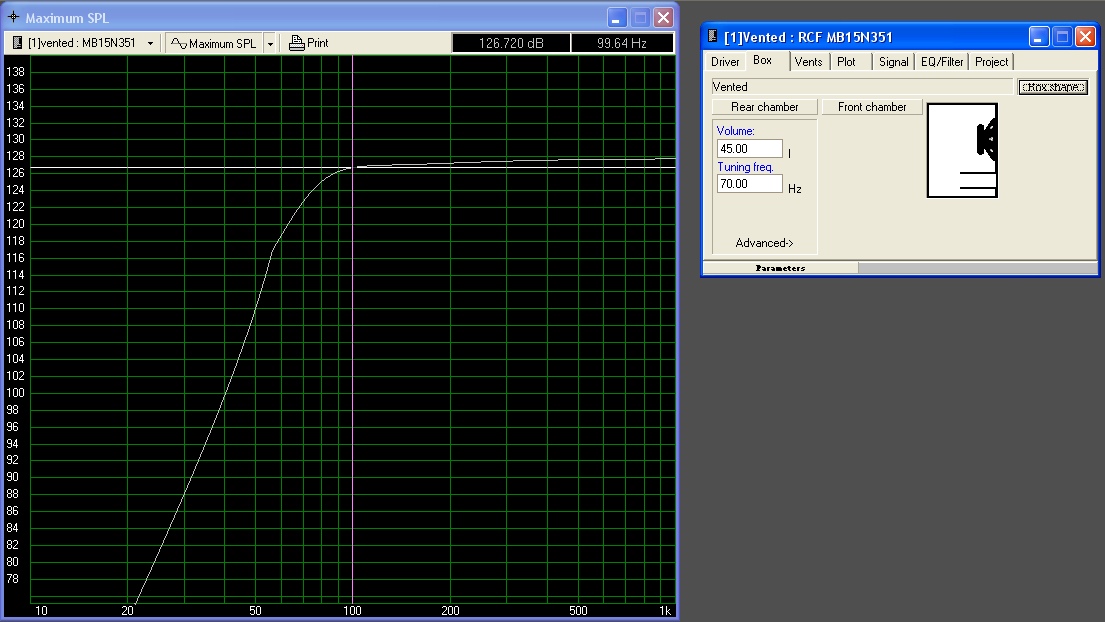

The woofer will logically be installed in a vented enclosure. Around 45L tuned at 70Hz looks nice. Not much low bass, but suitable for crossing to subs and enough for smaller venues I'd think:
attachment.php
