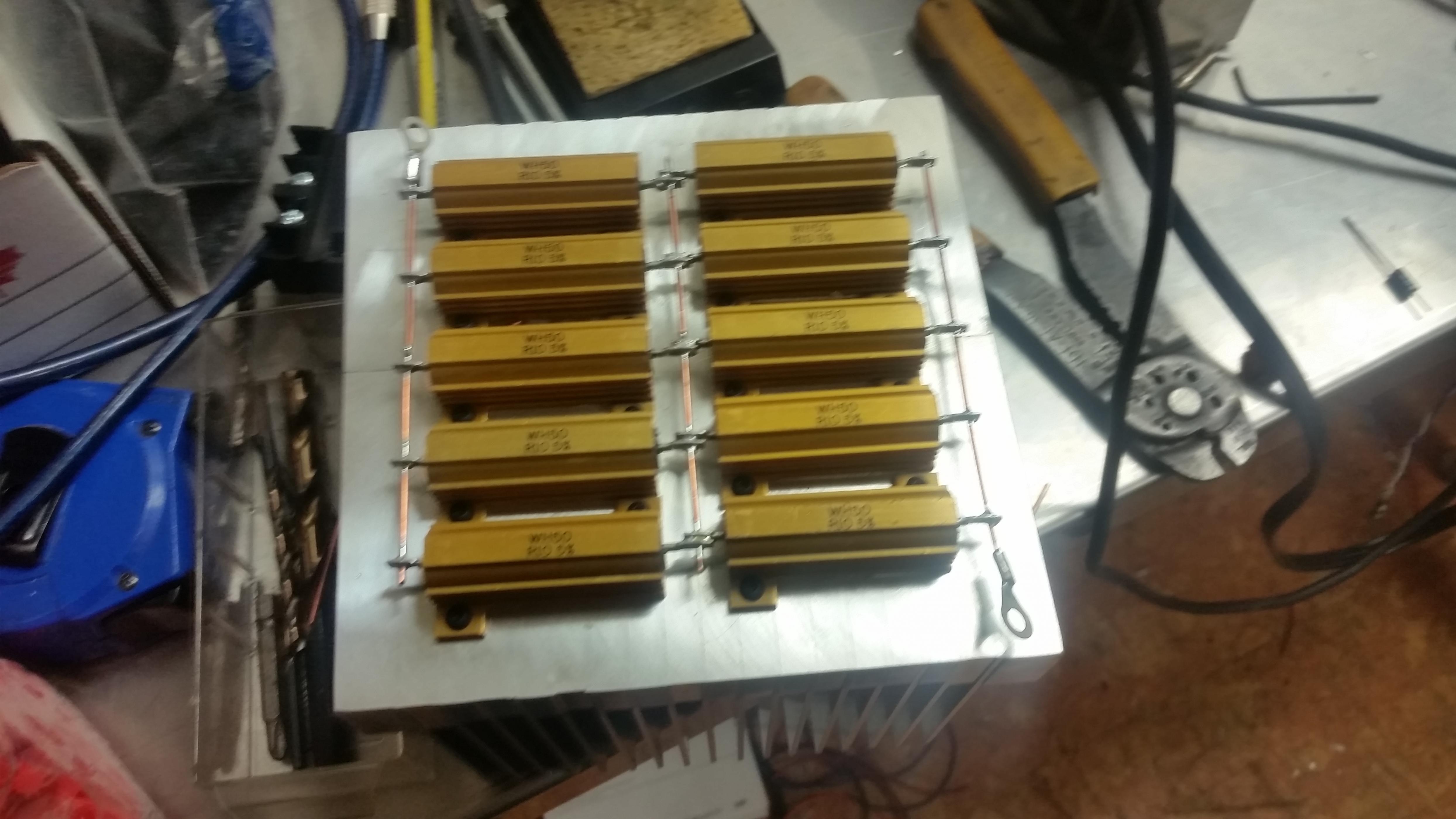

does anyone have any links to good deal on high power resistors?
I looked on Ebay and found that you can get 100W rated 1R power resistors for about $2.50 each. These can be screwed down to a heatsink (and should be for the full rating). If I was putting together a resistive test load I would just buy 16 of these that can be placed in series and/or parallel to give me a high power load. Make sure that these are the low/non-inductive type. Most high power resistors are wirewound ceramic embedded elements. By winding the wire in a certain way the inductance is mostly cancelled out. Otherwise you are limited to 3W or 5W metal film resistors and getting rid of the heat is not as easy since they are not designed to be heatsink mounted.

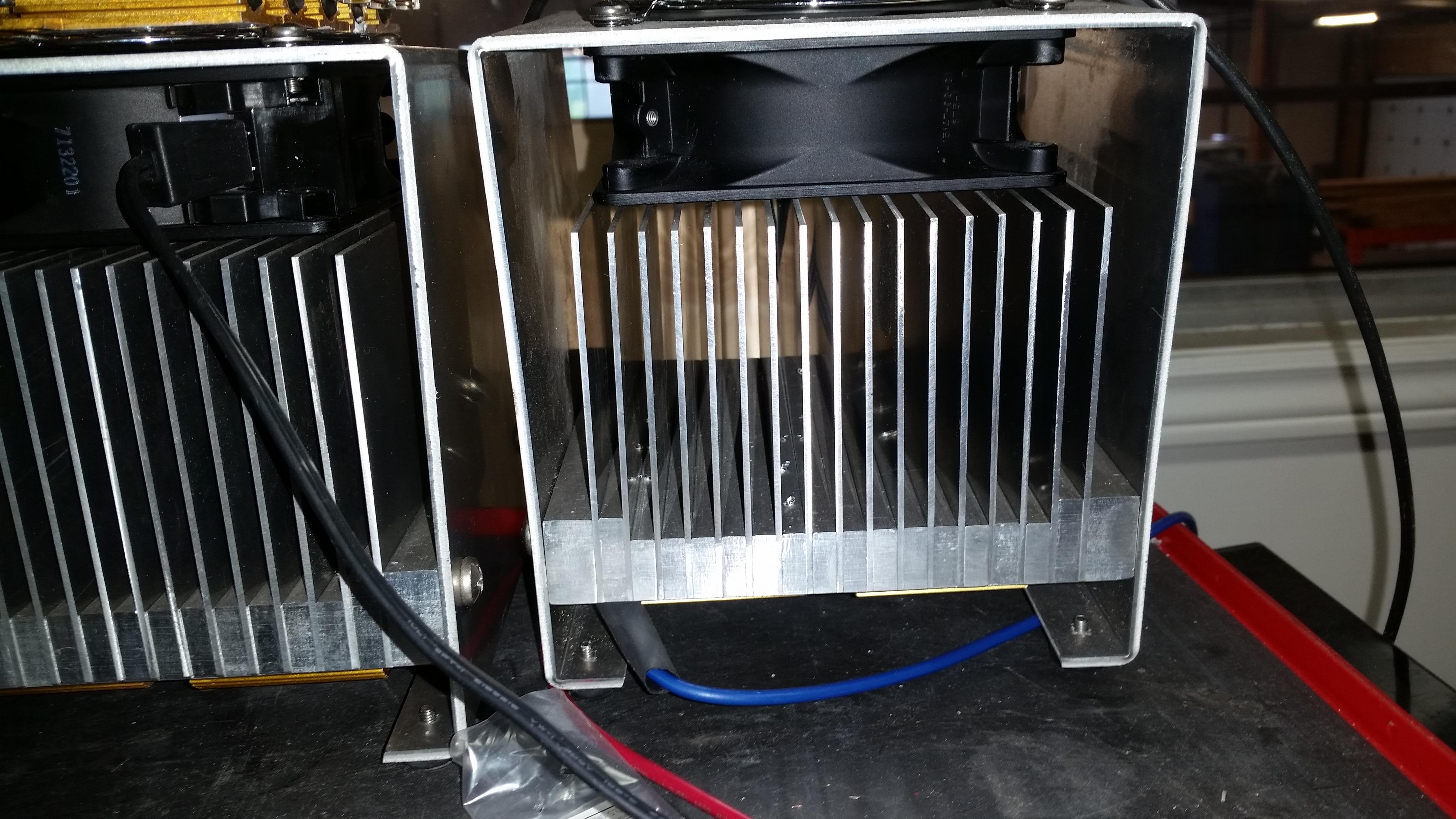

I did as CharlieLaub is suggesting with 10 50W resistors. Newark/Farnell has blowout sales regularly. The dump stock ridiculously cheap sometimes. That's where I bought mine.

Get yourself a few of these, plus large glasses of water to put them in then you won't need any fans.
