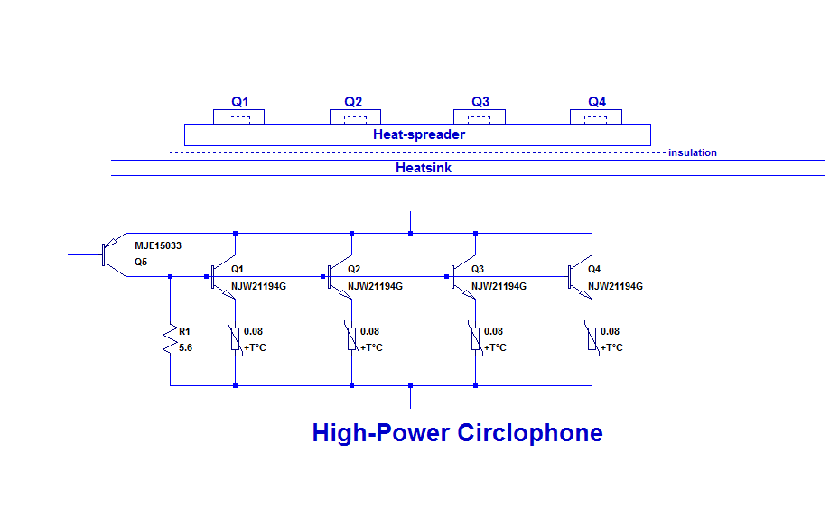

Now, let's get into the heart of the matter:
I have examined the question, and I think I have found an acceptable solution: one that is safe and effective but also preserves the Circlophone sound character.
Not everyone likes the sound of the C, but if someone builds a bigger version, he probably wants to keep all of its peculiarities, including the sound character.
It would of course be possible to just add largish emitter resistors for a safe paralleling, but the sound would be "anonymized", just like any other class AB amplifier.
The solution has three components:
-Matching of the paralleled transistors
-Use of special, PTC emitter resistors
-Mounting of the transistors on a common heat spreader to minimize inter-transistor Rth compared to the thermal resistance of each transistor to the ambience
These measures go against the Circlophone spirit of simplicity, absence of matching, tolerance and ease of mounting, which is why I shall develop them in a dedicated thread, because I do not want to confuse would-be builders and lead them into thinking that a 1kW C is going to be as easy as a 30W one.
In the meantime, here is a first preview of the method:
796834d1574445299-little-cheap-circlophone-hipocirclo1-png
The most intriguing aspect are probably the low value PTC's.
Using PTC's is advantageous, because they behave in an opposite way compared to the transistors. When the current increases, they heat up and increase their value, just where it's needed.
Thanks to that compensating behavior, they can be much smaller than a regular resistor and still have a good balancing effect.
The 1,000$ question is: where to source those miracle components?
This is DIYaudio, and we are going to make them ourselves, in the true DIY spirit, and it is much easier than you might think.
That's what I am going to describe in my next post.

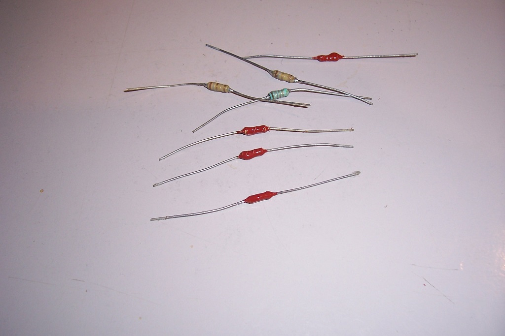

The resistors are just going to be home-made wirewound resistors.
The + tempco problem is a very easy one: most common metals have a positive tempco of 0.3~0.5%/°C, which is perfectly suitable here.
Copper for example has a tempco of +0.4%/°C and is very common, but it has one disadvantage: a good conductivity, meaning a relatively long length of wire, which is unpractical.
Steel also has a comparable tempco and a much larger resistivity (and tensile strength), but where to find high-quality, consistent and easily solderable steel wires?

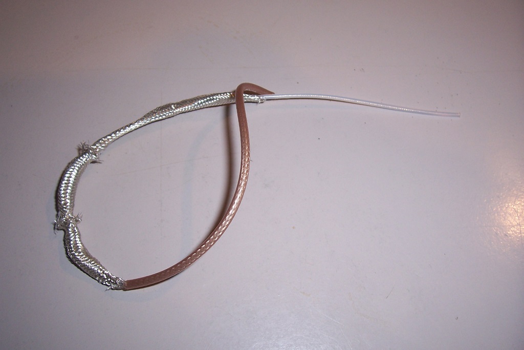

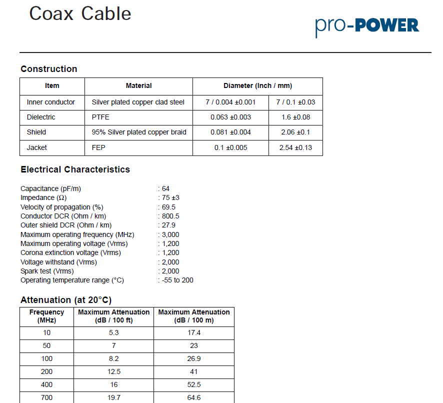

The answer has a name: RG179 (for example).

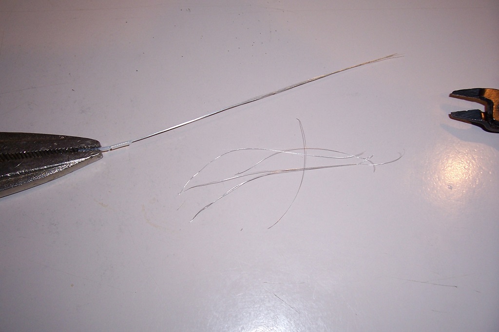

This coaxial cable has a stranded, silver-plated steel inner conductor, of 7 x 0.1mm:
attachment.php
Here it is, partially stripped:
attachment.php
attachment.php

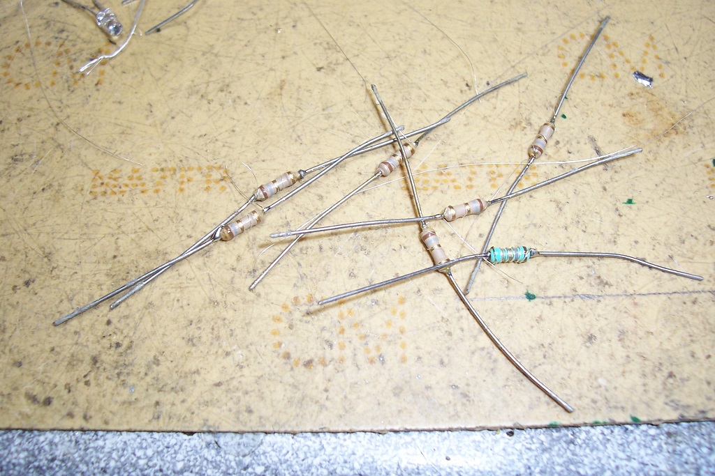

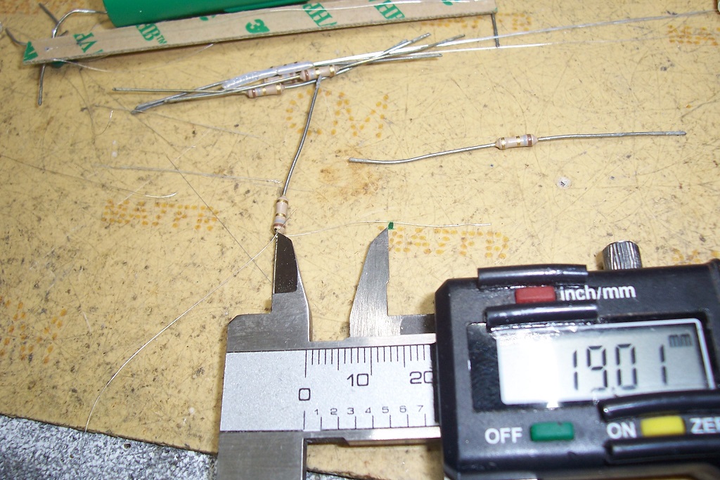

The next step is to measure the resistivity (45mΩ/cm), compute the length required (19mm), and wind that length on a suitable support, here a 1.8Ω CR25 resistor:
attachment.php
attachment.php

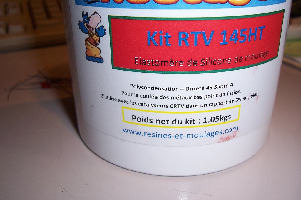

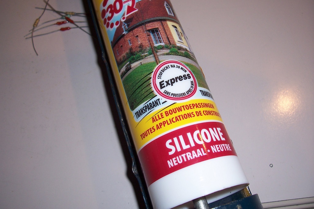

The final step is to dip the PTC in a suitable coating (high temperature).
I have tested two types of silicone: one is a general purpose, one-component neutral RTV (transparent), dispersed in an organic solvent (toluene)
attachment.php
, and the other is a 2-component, high temperature RTV 145HT (red).
attachment.php
attachment.php

Good and expensive could be counter-productive: the thermal compensation needs very low transistor to transistor Rth, so a spreader made of thick aluminum or better, copper, is essential and transistors can be mounted with silver compound, but the common thermal resistance plays an important role in balancing, and if it is low enough to compete with the transistor to transistor Rth, that's not good.
In addition, the area of the spreader is much larger than the sum of the individual transistors, meaning the thermal resistivity of the interface is much less important (within reason).
If the thermal resistance of the interface is between 1/5th and 1/10th of the heatsink, it will have a moderate to negligible impact on the global result, and will allow a quasi-isothermal heat-spreader necessary for a good balancing.
Normally, an ordinary silpad sheet should be OK, if the spreader is not too small.

Yes, I mentioned that as an example, because that's what I had handy, but any similar product would be OK.
That said, 1 meter of cable translates into 7m of silvered-steel wire, and since an individual resistor uses a bit less than 2cm, you could theoretically make 350 resistors for $7.
Even if your production yield is 10%, each PTC would end costing 20 cents for the wire. Add the same amount for the support resistor and coating, and you are at < 50 cents, which sounds tolerable.
I made some tests on the finished products: the cold resistance is comprised between 77 and 88mΩ: less than +/-10% tolerance centered on 82mΩ, not too bad for a quick and dirty attempt.
The absolute value is unimportant: what counts is the matching, and ideally we would like 1 or 2%, which is easily attainable by better techniques and/or sorting.
I measured a 86mΩ sample at various currents:
Code:
  I(A)     R(mΩ)
   0        86
   1        92
  1.5       97
   2        107
  2.5       122
   3        148
The variation is exponential: very slow at the start, increasing its pace at higher currents.
This is understandable: the formula P=R*I² is a first reason, but in addition R increases at higher currents, increasing the dissipation.
This means that these PTC will only work "statically" at low currents (which is better than nothing), and they will become really active at 2A and above (for this example).
This explains why other measures: matching and thermal coupling are still necessary for low currents.
The PTC effect will kick in at higher currents, and prevent thermal runaway.

In free air, such a straight wire fuses at ~2A. Here, the wire is in contact with the supporting resistor, and is embedded in the coating, meaning the current capability will be significantly higher (in a naked, isolated wire, the PTC effect would become apparent at much lower currents).
I will make a destructive test later, to assess the coated version.
Why did I use such a low value resistor as mechanical support?
To help damp possible VHF resonances caused by the 10 or 20nH of the winding. Probably not important with LF transistors
And here is appropriate RTV silicone in smaller container.
It might be too thick in its original form. If it is the case, you can dilute it with a small amount of organic solvent to ease the application.
I have made a destructive test on one of the samples: at 3.5A, it begins to smoke, and at 4A there is brutal increase in resistance, but no actual fusing.
For these examples, the sweet spot is around 2A. For normal operation (max output current rms), each one should see a little less ~1.8A.
That way, if one of the transistor diverges and goes over 2A, it will quickly come back on track.

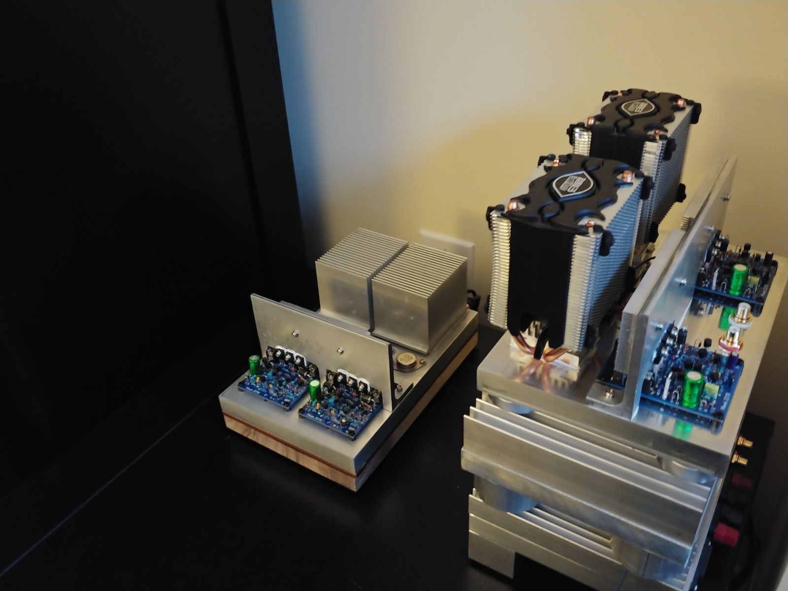

My speakers have nominal impedance 6 ohm, so I guess 300-400W peak
power, with 4 pairs, and 800W transformer will have to suffice 🙂
In my previous builds, CCS transistor (small NPN, replacement for R21) was running hot, perhaps with higher rails I will use MJE340 or something similar.
Also, if I was redesigning the PCB, I guess maybe I would add a trimmer in the CCS to adjust idle current.
But as it is, I think my current PCBs (still have 16 of them 🙂) will work just fine.
Here is a pic with both Circlophones visible.
It's amazing how cool the amp runs with these fans.
They barely move, yet they cool very efficiently.
Actually just one fan would be enough..
For the High-Power amp, I plan to also use CPU cooler fans.

Since there are now emitter resistors, it might be possible to add an output protection, probably something useful for amplifiers of that size
I have made a quick, 111 milliohm test sample using 25mm of wire.
Here are the resistance vs. current values (after thermal stabilization):
Code:
Current (A)    Resistance (mΩ)
   0                   116
   0.5                 123
   1.5                 131
   2                   147
   2.5                 175
   3                   229
It begins to smoke at 3A (with ordinary silicone), but even after several minutes at that level, there is no visible damage.
The sweet spot (where resistance begins to increase more rapidly) is somewhere between 1.5 and 2A, which means that the initial extrapolation of 1.5A was correct.
Note that a great accuracy is not required: it is just a protection against thermal runaway, and as soon as the current increases beyond the average, it will become limited by the PTC effect.
Matching, both for the transistors and the PTC's is more important
I'm ordering the cable...

https://www.amazon.com/MEECOS-RED-DEVIL-1352-Fireplace/dp/B002JFSVGE/
Perhaps this kind of high temp cement would work better than silicone?
Certainly, if it remains perfectly neutral wrt. the metal of the wire

Would this silicone sheet we good enough for the spreader/heatsink
barrier?
Yes, the thermal resistivity is 0.833°Kcm²/W.
With 10cm², you would have 0.0833°K/W which is about right
That looks like an inrush limiter. It might not do anything until the transistors are already severely out of balance.
So what would really happen if you just used regular emitter resistors? With a CFP, they are really in the “collector” circuit. Which doesn’t degenerate the stage in the same way as if they are in the emitter of the PNP. Yeah, it’s not the same, but you never get something for nothing. It may be worth trying to see what the results are. Many of the large transistor types have multiple emitter ballasts inside the die anyway, so it’s effectively like multiples in parallel with resistors.
