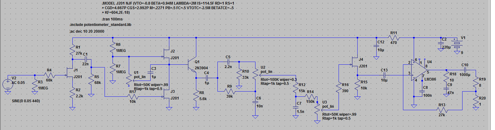

As a first project I've designed and built a little battery powered practice guitar amp for myself and it seems to be oscillating. Sort of a thin, high pitched, tearing screech that varies in frequency with the sound from the guitar. The frequency also varies when I touch the controls. However, if touch the input jack or even touch the PCB the noise just disappears and it sounds great.
I'll post a schematic later when I have some more free time but basically it consists of a couple JFET (all J201s) gain stages (a simple common source followed by a "mu-amp" stage), followed by a Big Muff tone control into an LM386 output stage. It's non-inverting so I'm guessing that's conducive to oscillation as the output is in phase with the input. What's the standard for guitar amps anyway? Should they be inverting or non-inverting?

Post pictures and a schematic. Be thinking about some kind of metal box to put it in. Also it might be that you can reduce the gain just a bit and solve the problem.

I fixed it! Turns out I had the input jack wired backwards! D'oh! 😱
