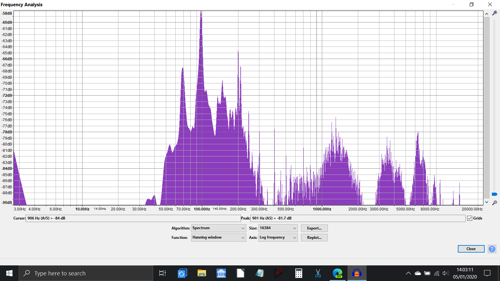

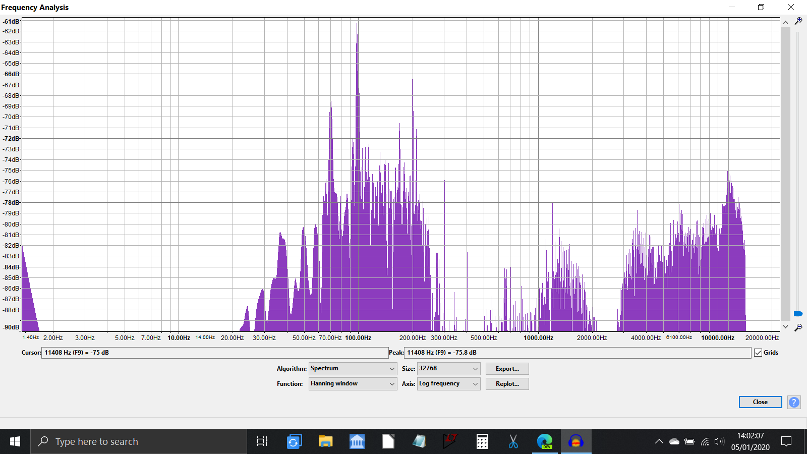

I see a fluctuating sound around 12kHz on the 'scope, perhaps there is ultrasonic oscillation and this is an artifact from it, perhaps its interference getting into the amp, either from mains or as RFI.
What is the sound source, or is it indepedent of that?

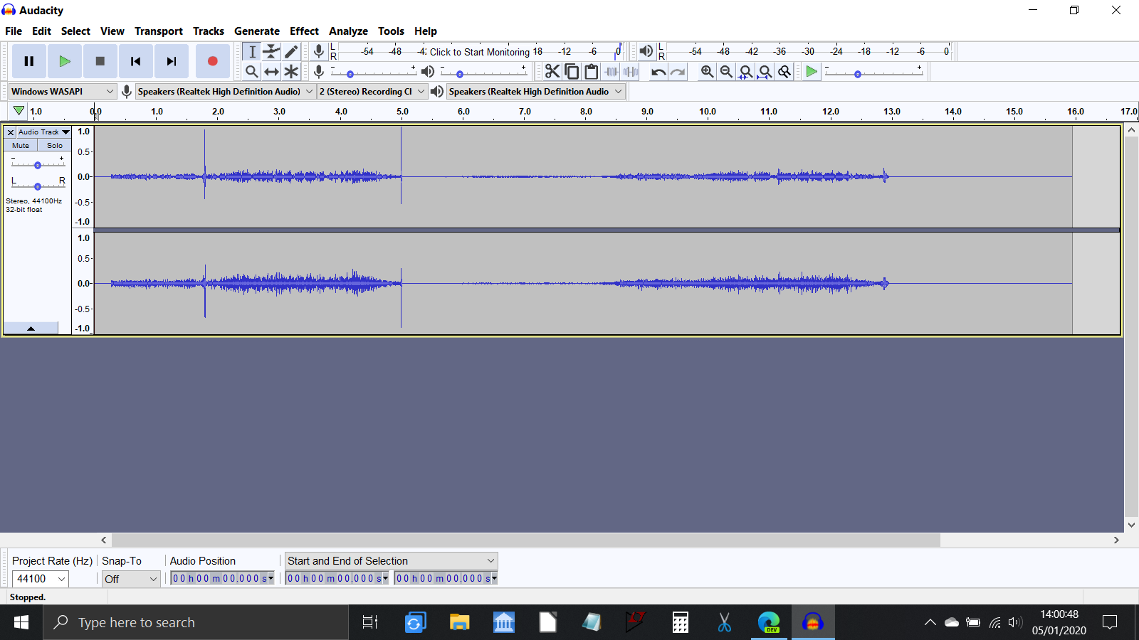

Hard to say really and a plot of the spectrum shows a lot going on. The second FFT is from 6 to 8 seconds (the quiet bit). Could be anything... start by fitting shorting plugs to the inputs and have nothing but speakers connected.

Hi Mooly,
The quiet passage is when the phone is moved away from the speaker to demonstrate the noise coming from the amplifier/speaker.
What you asked was done. Only the left side input was terminated, CD input was selected and left input was terminated and exactly the same noise, no difference!
