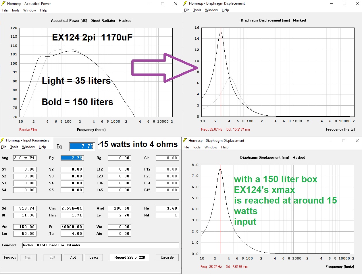

A capacitor may rarely act as a textbook highpass filter with a speaker system.
A series capacitor can be used to "boost" and flatten a sealed box which would normally be too small. The "boost" happens when the combination of cap reactance and speaker input impedance is lower than just the box / speaker alone and for that to work, the amplifier needs a low source impedance.
EX124 in a 150 liter box with 1170uF series capacitance hits xmax with around 15 watts input.
In the sim below I show a 35 liter box with 850uF.

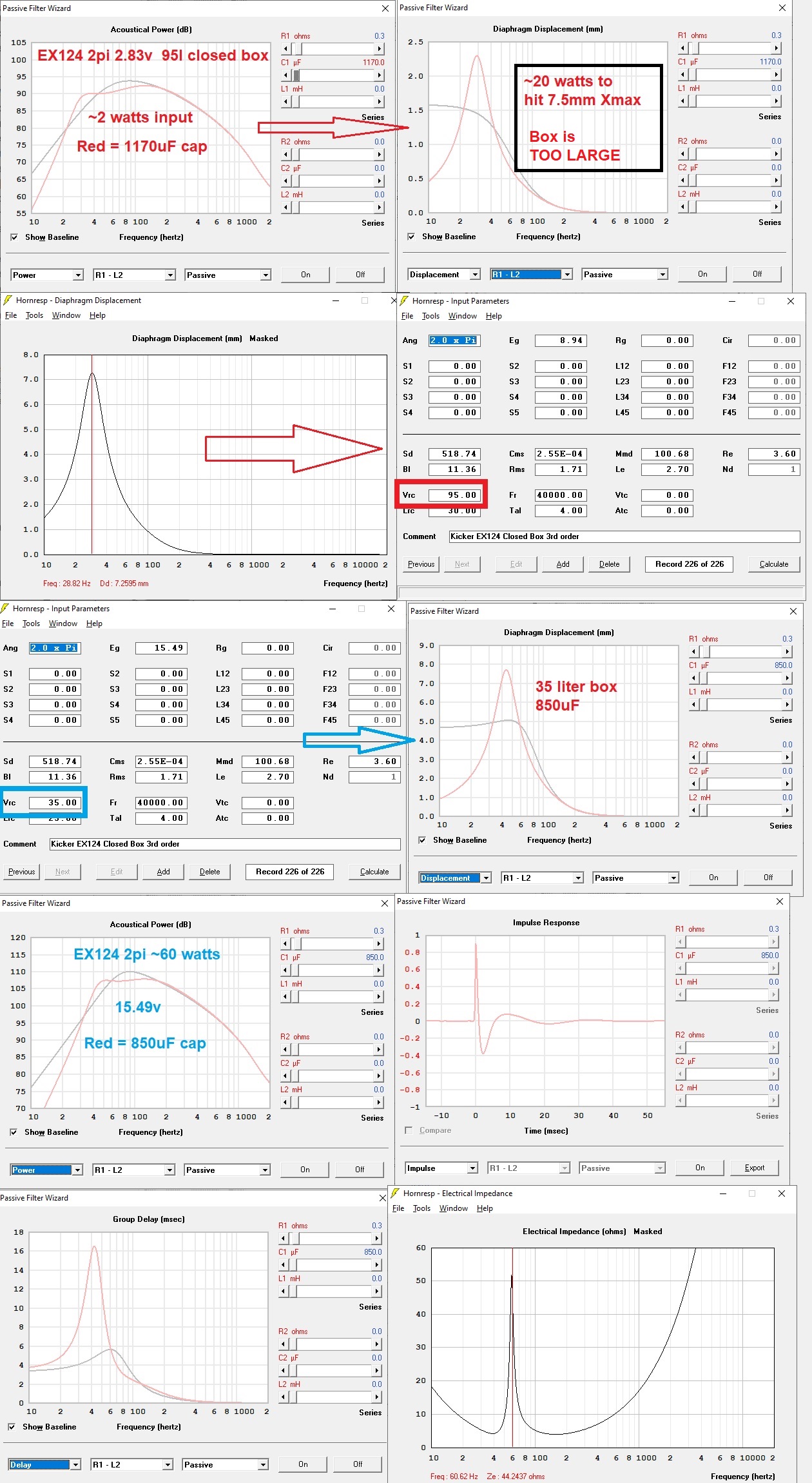

Let me re-open Jeff Bagbys program and run the numbers again as I think I was happy enough with a 90 litre box
I get 70watts at X-Max when using ~1100 uF in a 90litre box but X-Damage is about double the X-Max so peaks of 150W could be OK and that would be ~110dB.

I'd be happy with the 27Hz F-10 in this simulation
The intended midrange needs at least a 30 litre enclosure so these were never going to be small boxes.
27Hz would be great and even cover a lot of theater organ CDs. I wonder why the big difference between Jeff's program and hornresp? (did
I make a bad entry ?)
Series Capacitor considered just a 1st order filter?
First Order filter wont reduce cone excursion below tuning frequency
very well.
It can help a little.
* edit* Cone excursion seemed to resemble a closed box in the horn response graph.
then I realized you guys were modeling a closed box ...
very well.
Yup, and that's going to be the "feature" behind my next build (once this lockdown is over). 1 cu.ft. boxes holding 12" drivers that can get down flat to 30 Hz. Perfect combination of driver parameters and series capacitance.
Shoot for a Qtc of 1.1, and use preferably a Qms between 7 and 10. High Xmax required.

Folks see electric filter theory, a capacitor gives a 1st order highpass, and conflate that into using it on a woofer. However a woofer's impedance is NOT like the resistor the filter theory presumes. SoA capacitor may rarely act as a textbook highpass filter with a speaker system
- Excursion might be reduced some, which I'd observed
- But it doesn't really work, as I found out when I had to redesign a passive filter which was for adding a subwoofer passively to a fullrange amp and "highpass" the satellites.
- I suppose if the frequency was low compared to the impedance peak at resonance maybe it might work-but it wouldn't cut so much excursion either.
- My recollection was the capacitance + impedance peak made an ugly load to the amp. @freddi, (1) What frequency "should" be the corner frequency of the capacitor you modeled? (2) Can you show the impedance curve with/without the capacitor? I'd be very curious.

I know it's driver dependent but the high value cap as a first order High pass can work very well in a small sealed box. I just wasn't sure that this driver*box combo was worth using with one.
