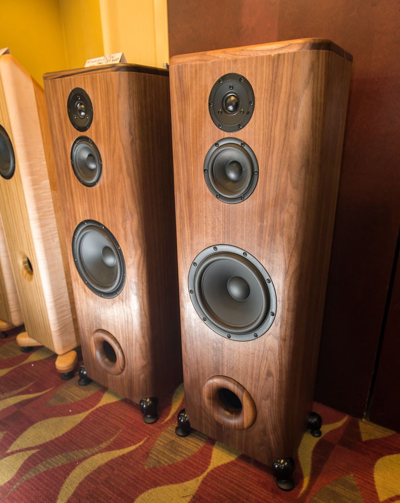

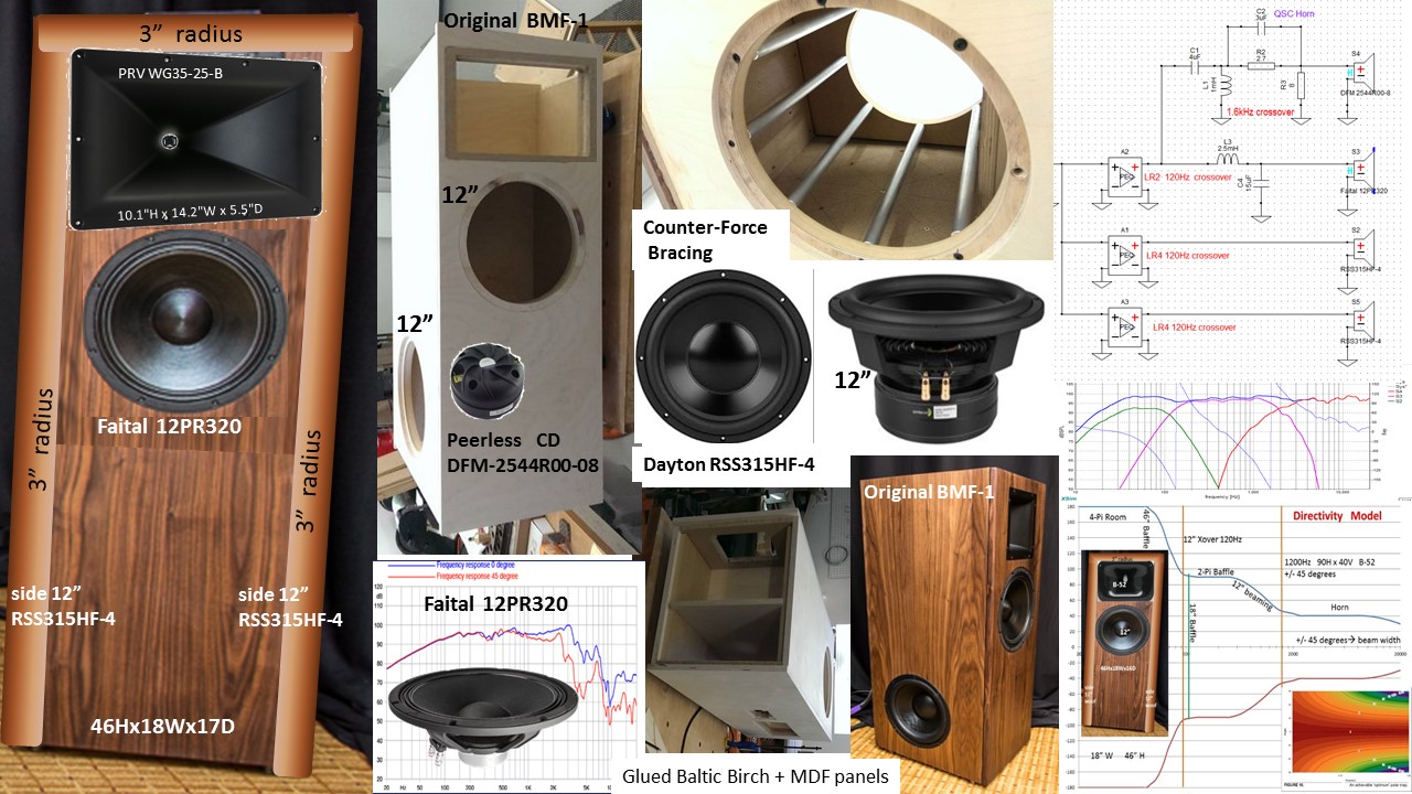

The 22" W-I-D-E Sonus Faber Elipsa form factor would support a sealed 12" woofer. There are a few 12" woofers like the SB_Acoustics SB34NRX75-6 which produce deep 36Hz bass in a tight transient SEALED 3+cuft cabinet.
The Sonus Faber Elipsa cabinet has poor volume efficiency. A 22" wide rectangular cabinet with 2" - 3" radius on the L+R+T edges would have good directivity, and also provide extra volume for a sealed woofer. Look at the Satori based speaker named "jintani" build by Javad Shadzi as an alternative cabinet shape.
Tweeter = SB_Acoustics Beryllium dome SB29BAC
--reviews agree that Beryllium sounds better. Detail of hard dome with unique natural smooth tone.
midbass= SATORI MW16P-8 for 100Hz-1.65KHz
--small 6" midrange with Sd = 118cm^2
--"MW" version in sealed 0.7cuft volume has Qtc=0.6 and Fsc = 57Hz
------crossover at 1,650Hz produces constant directivity up to (30-degree off-axsis, up to 10kHz).
------crossover to woofer below the 200Hz baffle step = use M-to-W SPL overlap to smooth BSC
--Sensitivity (2.83 V / 1 m) = 87.5db
woofer = SB_Acoustics SB34NRX75-6
--tight transient SEALED 3+cuft cabinet.
--Sensitivity (2.83 V / 1 m) = 90db

I don't (and won't) have a Facebook account, and so have only heard Javad's name - I haven't actually seen any of his designs. The Jintani is pretty much exactly what I'm working towards, aside from the somewhat pedestrian aesthetics. If there were a kit for the Jintani, I'd be very tempted to pick it up and massage it into my target form factor.
But yes, the Elipsa has the downside that it looks big and dominating, but really doesn't give you nearly as much volume as you'd expect. This is a big part of why I ended up (tentatively) settling on the RSS265HO - they're pretty much the best small-box woofer I've run across. Since I'm crossing actively to the woofer, efficiency isn't a concern, and I can throw enough power at it to make it workable.
As for ported vs sealed - I'm still on the fence to a degree. My original plan was to use 2x RSS210HF in sealed cabinets (I'm running a single per side in 1 cu ft currently, and they work very well). The practical problem is that this doesn't make great use of available amplifier capability. In series they are an 8 ohm load which reduces available power, in parallel the impedance is too low. I do plan to compare the subjective impressions of the ported RSS265 vs the sealed RSS210. Picking up a 2nd TPA3255 amp board to drive the 2nd pair of woofers might be viable, but switching to a sealed RSS315HF is also a possibility, although the aesthetics might be a bit odd with a 5" mid. Using a 6" with the 315HF would basically be revisiting Pete Schumacher's Byzantium concept.
