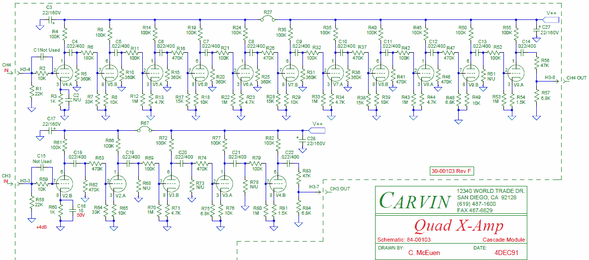

CARVIN QUAD X-AMPLIFIER SCH Service Manual download, schematics, eeprom, repair info for electronics experts
This thing is totally quiet at max gain.

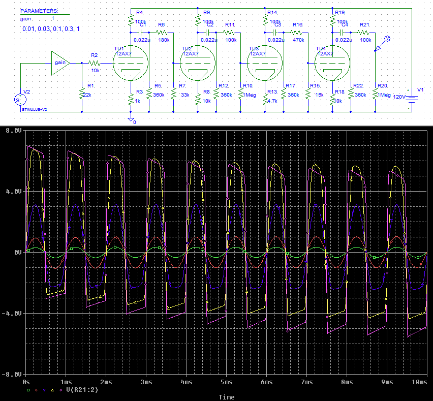

Attaching the more obscene part of Carvin's vile plan.
The eleven cascaded stages, with interstage loss, might be a good FM limiter. I'm starting a sim of this plan but both my fingers and my sim are tired tonight.
edit-- sim chokes on 8 stages (eval version). Here's 4 stages, drive levels 10mV to 1V peak.

I'm contemplating how to get a "hyper-clean" sound and this is fascinating. Particularly the sets of pairs (each pair having a "normal" stage; an attenuator; then a cold clipper) and the absence of cathode bypass caps. I wonder if the bias shift (in your simulation) has an audible effect?
Now i remember that I built(11 years ago) only the 5 stages circuit and compared with many 2 stages high gain circuits, like Mesa(soldano-slo100), it had no noise but a considerable level of drive...I never had the balls to clone the 11 stages...hopefully 2 X "nothing"= " nothing" +3db...everybody liked more the Mesa(soldano) sound for drive though...the main difference was in the voltage supply, Carvin had 3 times lower supply than Mesa...so it worked a bit as a starved anode too...

Unfortunately they put so many drive mods on an amp who had one of the best clean ever...Clean players aren't really dead about drive...so they discontinued it for the right reasons.
A small review that tells a lot to an electronics engineer:
"Channel 4: Grosse distortion, but not Hi-Gain so far. Good sound, quite versatile, especially thanks to the équalo. A good distortion lamp, but ultimately lacks personality"
as channel 4 lacks high gain usual hum...the hum is the one that makes the high gain "recognizable high gain", Carvin has no hum in high gain...just distortion and a lot of it!

In the case of my "clean" chain I think I'll need each pair set closer to "clean" but with similar gain/attenuate so that all even stages clip at the same time, first into cut off (for lotsa 2nd) and then it's a race between the odd stages and grid cutoff.
I think.😱 Maybe I want grid bias in the odd (warm) stages first 😱

Carvin preamp has a lot of low quality semiconductor on the signal path too...

Fascinating. ..... I wonder if the bias shift (in your simulation) has an audible effect?
The bias shift is done before 10mS. At guitar time-scale and pluck transient, I suspect bias-shift has "no" audible effect.
I would not say the chips are low quality. They are low-spec by audiophile standards, true. However at guitar level and bandwidth, the '558 have been a mainstay of guitar electronics. They work. I might chose a different chip, not sure; but it isn't a bad choice.
Anyway if those tubes do anything they ought to overwhelm the chips.
My suspicion is that you want "layered" clipping, not all-at-once. However only the breadboard can tell for sure.
the njm4558 is widely used and appreciated for its trashy sound in Polytone where some people try opa2134 for a cleaner sound...but here we have countless 4558 in series everywhere.It sounds like a "fine choice"...Now...for a drive circuit you don't want a trashy nonlinear stage before the drive circuit because you won't be able to trim the final products in the eq section.There are lots of fet switchers too and then.... should we wonder why people say that the drive section lacks dynamics?
