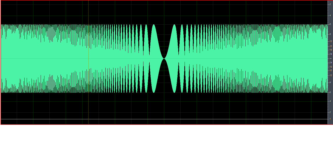

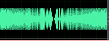

HF tone interference test: SHOCK RESULT
I've just carried out an experiment on thid and can't understand the result.
I used my old cool edit software to simulate the effect of a continuous hf tome
TEST 1 - 11khz tone mixed with a second sweeping tone starting and ending 100 hz either side. RESULT: a rough gobbly sound as the two frequencies crossed.
TEST 2 - 11kHz(+-100) sweep mixed with 22kHz (inaudible to me)'carrier' RESULT:- No audible effect on the 11kHz tone despite the wave map clearly showing measurable interference.
TEST 3 - two inaudible frequencies beating together (22kHz) RESULT: NO SOUND despite the wave map (appended 10 second sample screenshot) showing all sorts at audible frquencies I could hear absolutely nothing.
so;
As long as the carrier frequency is inaudible it has no effect whatsoever on audible tone. I can,t believe what I'm saying!

This is the first time you've realized that something you could measure was inaudible? 🙄
