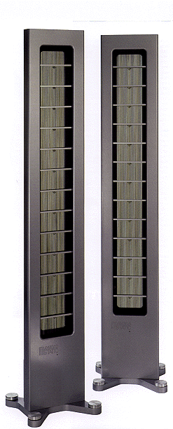

Why don't you make an Elektrostatic loudspeaker?
A friend of mine use to listen to Led Zeppelin, Rage against the mashine, Charly Antolini but also to Clasical (organ) music.
His ESL's can handle everything! He uses Hawk Audio A50 Amps.
I have ESL's myself and believe me they do go verry loud.
Best of all, they are semi transparent. you can look through it.
The Wife Accepting Factor is tremendus. They are about 5 cm (50 MM) thick! And they are verry precise and they DO sound warm.
I't cheaper to build than a conventional speaker!
Think about it, if you need more information, just ask or mail me.
Audiofanatic😉

I use electrostatic speakers to,
original acoustat panels in a new enclosure.
For the low frequencies (subwoofer) I use the Peerless XLS10.
This combination sounds like you want, with powerfull and deep Bass.
The WAF factor is high as everything is not big and the woodwork and grille is matched with the colors of the livingroom.
So I also think you should consider electrostatic speakers.

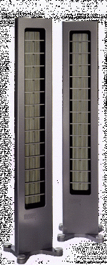

Hi Audifanatic,
To explain a little more of my experience with some old M-L Aerius speakers, I bought them 2nd hand from a hifi shop. They were having problems with the speaker so I got them cheap but after getting expert local advice from a local ESL maker and cost from M-L factory in USA, I decided it was not worth it. The factory was going to provide a new set of panels with a cut-off circuit. I am not an ESL expert but this was my experience. The local ESL maker said he had repaired other old M-L speakers with the same problem. Perhaps this is only a problem with early M-L speakers.
I recognise the ESL picture posted (silver colour panels) here, as it was reviewed by Hifi Plus magazine. If you believe them, they said it was great in some areas but had some major problems. Looks great however.

These ESL's have IMHO only major problems! You can't play loud, you can't listen to Led Zeppelin or Charli Antolini.
I do find them cute though, but they sound horrible!
