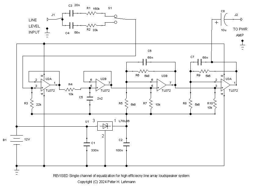

C. Equalization. I need to do some more thinking about how I came up with the equalization that was implemented.

In trying to figure out what would be the correct equalization for my speaker, I think I know how to correctly determine that, but I'm not absolutely certain.
See what you think. Below is a pdf that I have been referring to.

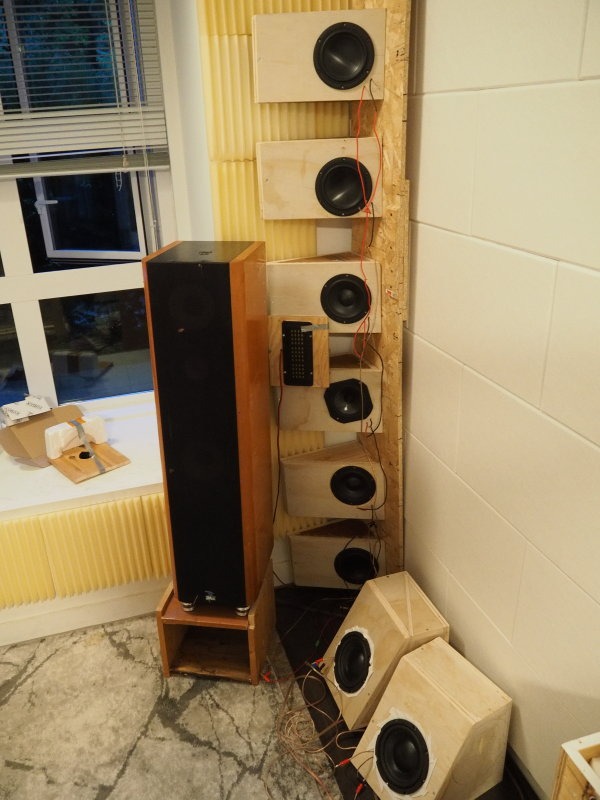

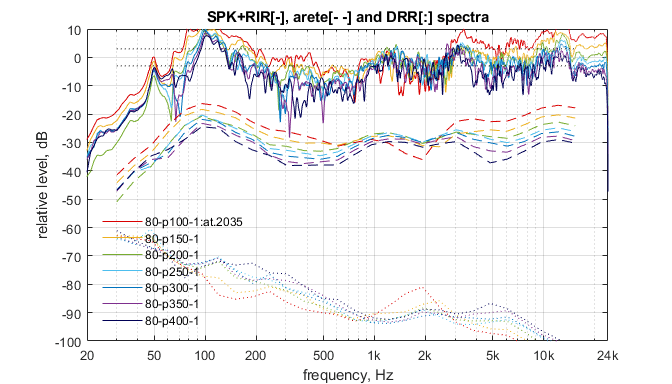

I also use 6 woofers, 5.25" each, 91dB/W@1m, spaced 1'. This is how it works depending on the distance, in my living room, from 100cm to 400cm:
It does not work anywhere nice with a single tweeter (or horn) because the tweeter intensity falls -6dB per distance doubling (here I used a focused array).
So I used a 200mm tall ribbon. It is better ... but it looks like I need 2 of those.
This family of curves looks more equalizable. Otherwise, the tonality would fluctuate greatly depending on your position (including the ear height). However, I need to play more with the drivers' positioning to make it more ... "coherent". it is not as straightforward as it looks.

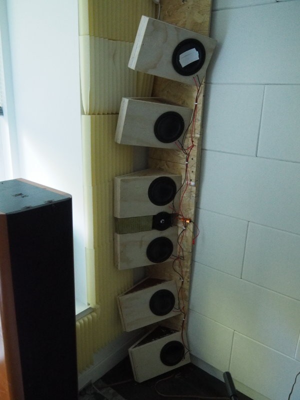

BTW, I experimented with near-field beamforming (which I called focused above) arrays which you did not like much, uneven positioning, a variable number of drivers, mixing drivers, and two vertically spaced subwoofers. Let me know if any of these interests you.

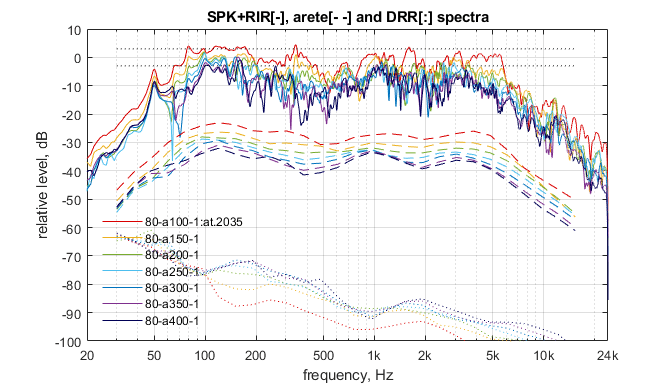

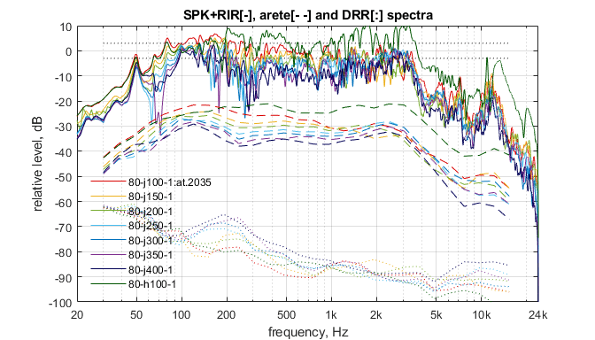

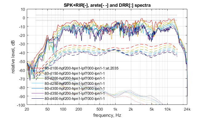

Jim, do you know anything about the rise of the low frequencies in arrays placed in the corner? This is the picture I get quite consistently:
The dark green curve is of one speaker in the corner, at ~85cm high, at 1m. It is somewhat flat over the 80...3000Hz range. The rest are of a concave array at various distances (100...400cm), the same 85 cm high. You can see a strong line source behavior at 2kHz, gradually receding into a more relaxed point source-ness at 250Hz. But then, it again becomes more line-source-like by 100Hz, and there is a gain. This gain is not the room gain per se because the dashed line is taken as the top of the ridge of the normalized wavelet transform (window length ~1/freq). I am quite puzzled. Have you observed anything similar?

My original thinking in making maximum gain of the shelving low-pass filter including op amp U3B of the equalizer equal to 12 dB was really flawed. See the circuit diagram of my equalizer attached to my first post. Fortunately I deleted it from my first post quickly or else I would be really embarrassed.
So anyway here is the reasoning behind what i think it should be which is 6 dB. The shelving low-pass filter is intended to compensate for my speaker propagating in a flawed manner or incompletely as a line array for frequency < 1,3 kHz.
Where Griffin's critical distance is equal to 2 meters (where my listener sits) or greater, output level of my speaker equals 100 dB at 1 meter distant from the speaker. At 2 meters the level is 97 dB
As Griffin points out in the paper that I provided a link to in my first post, where height of the line array is fixed, then critical distance is directly proportional to frequency.
Where the critical distance is very much less than 1 meter, then output level of my line array equals 97 dB at 1 meter and 91 dB at 2 meters. The difference between SPL at 2 meters (the listener's location) where my speaker propagates as a line source or line array is 6 dB. One of the things that the equalizer is to accomplish is to fill in for the loss of SPL in the frequency range where my speaker functions only partially as a line array.
Thus maximum gain in the bass range of the shelving low-pass filter including op amp U3B of my equalizer should be 6 dB, not 12 dB. I've changed the filter to produce a maximum voltage gain of 2 at 100 Hz. See the attached revised circuit diagram.
The shelving low-pass filter of my equalizer including op amp U3A is for baffle step compensation.
