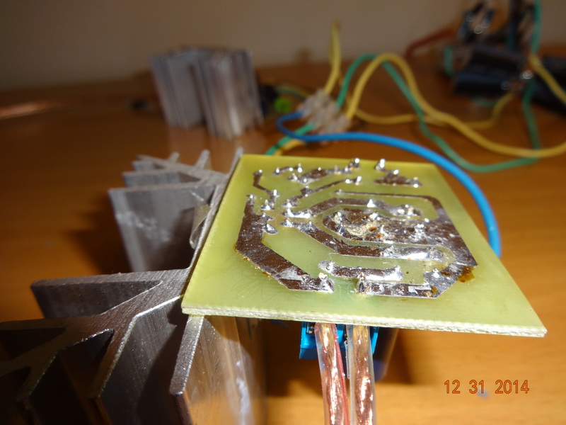

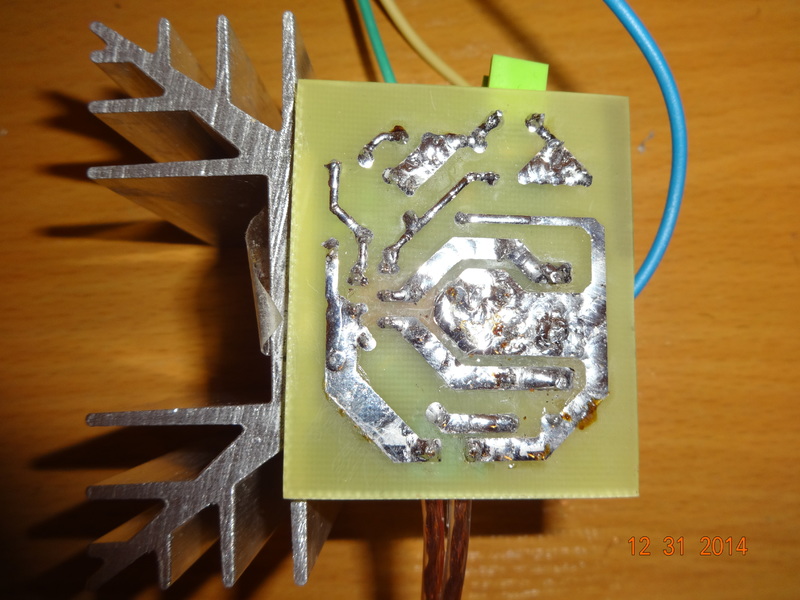

Hello, I have built a LM1875 amp, on this pcb:
It is 2 pcb's and PSU assembled on air. It has been running fine for a week, but then I had to move it (it still doesn't have a case). And after moving it both chanells started to have high DC voltage at the outputs.
When the volume on my source (laptop) is below half (which was normal for listening before) I measure 17 V DC at the outputs and 0 V AC.
When I turn up the volume even more, DC voltage starts to drop and AC voltage appears.
Maybe someone knows what might be the problem?
BTW: PSU looks fine I measure normal +-18V coming from it.

Something has broken during the move.
A broken wire, or a broken solder, or a broken trace. Or maybe a loose strand of wire has shorted across a couple of pads/traces?
You need to check more thoroughly.

Your problem may be different but I built this same circuit for two amplifiers and had troubles with both, mine ended up consistently blowing the fuses on the negative rails in both cases, and it was maddening.
Turns out the problem was the LM1875s weren't adequately insulated from the heatsinks. Since I fixed that no problems.
