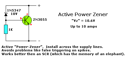

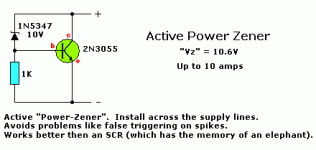

Yea, that crowbar circuit will work fine, I cant seem to locate that link, can you please supply me with it in a post, I've seem one with a zener and transistor once but cant remember where
EDIT: i finaly founded it
its called "Active Power Zener"
http://sound.westhost.com/appnotes/an007.htm
no, that is a negative version of your positive regulator.
It is a zener with a bit of muscle behind it.
It is called a "crowbar"
When it triggers it shorts the top to bottom of the triac.
That blows the fuse in the supply line, hopefully before anything is damaged.
No man, this device filter out all the voltages above the zener and short circuit it, and maybe that will be able to blow the fuse, I don’t want to use a triac, maybe I cant make it like with if the voltage get to high it flips a relay and disconnects the 28v DC from the rest of the system, this function can be useful for my UPS I’m busy building, I want a under power and over power disconnecter
