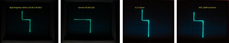

I was testing a small semiconductor tester purchase very cheap at my local surplus and I came across a Zener like curve on a Radio Shack 5mm High Brightness White LED (276-0017)
It shows a 2.5V forward voltage and a 7V reverse voltage. I tested a bunch of other generic LED's and those all show a diode looking curve with each LED's respective forward voltage.
I also plotted a small signal NTE159M transistor and it displays similarly to a zener (no surprise).
This High Brightness LED must be built differently. Is this common with the newer, brighter LEDs? Could the LED be used in reverse voltage as a 7V reference?

I took out a small 100x microscope and I was able to see he structure from the side (top is very difficult due to the lense). The high brightness LED is definitely different, it has 3 wires vs the one wire on the regular LED's. I have been doing some searches but haven't really found anything describing what I am seeing.
you have misread/misinterpreted the results.
At low current the forward voltage is lower than Vf@ rated current.
The device behaves a bit like a very high resistance with Vf rising rapidly as If starts from zero nA to say 1mA
Then the device starts to pass significant current as Vf nears the knee in it's Vf vs If curve.
Now the diode starts to behave as a small value resistor in series with a fixed voltage or back emf.
This looks very similar to a Zener and to a normal diode. The difference between them, is at what voltage the knee occurs.
This applies to all LEDs, not just white, or blue, or red and not just to high brightness but to all brightness/light output.
It's why LEDs are used as cheap voltage references. Once Vf is above the knee the effective resistance is low and that back emf is the voltage reference. Just like Zeners.

Based on your comments, you clearly do not understand Zeners. Vf is practically immaterial for a Zener, it is the reverse breakdown voltage that matters. This has a very sharp knee and very high slope compared to the forward voltage curve. What avincenty observed is a very low reverse breakdown voltage on the super bright LED, comparable to a Zener, and in contrast to a normal diode. I think that normal LEDs typically have a low reverse breakdown voltage, but maybe not as low as 7 V.
The pictures are all under the same drive conditions. On the scope the horizontal is accurate at 5V/div. Vertical center is 0V Current is not calibrated as I have not looked at the value of the current sensing network.
The fact is that the super bright LED is different in construction and based on the produced curve must have a different equivalent circuit.

I am currently running a test in the bench. Variable Power Supply + to 1K resistor to LED to ground. The regular LED, reversed biased did not go into breakdown until it hit aprox 100V on the PS, it then killed the LED.
The Bright LED has been running as a zener of 7.3 volts passing a current of 25ma. I am going to leave it overnight, then raise the current until I blow it.
Well...... I did a search on the part number and found a thread that mentions that the extra internal connections is for a ESD protection diode. It t is a built in protection zener after all. Also found a structure diagram for a different product that must be similar in construction.

Andrew, I don't think anyone else here is talking about the FORWARD curve, but the REVERSE bias situation!
Used as a zener, a LED, BJT-Veb etc is never forward biased so that part of the characteristic is not relevant.

Curious. First generation LED datasheets from HP etc, specify LED breakdown voltage backwards as 7 v. I don't have datasheets on anything newer, as LEDs with leads come from surplus houses now without a part number. Radio Shack stocks no electronic components smaller than a cell phone in this market.
First gen Optoisolator datasheets from HP also have a 7v backwards breakdown, whereas the toshiba optoisolator datasheet I looked up had no breakdown voltage specified except across. So I have been carefully putting 1n4007 in series with any optoisolators I use that might be subjected to back voltage. Is this silly?

ALL diodes - LED, zener, rectifier or otherwise have a similar reverse characteristic. The differences are in how sharp it turns on in reverse and at what voltage. The limit to how much current it can take in reverse is limited only by temperature rise - hence, the power dissipation rating of a zener.
LEDs tend to have low power dissipation capability and low reverse breakdown voltage (a few times the forward voltage). They get hot when you crank up the forward current, don't they? This means they're relatively easy to overload in reverse - the current capability is several times less than in forward mode just due to power dissipation. And since they break down at less than 10V so they're not very good at blocking, either.
High brightness LEDs vary in construction. Ones that have a high Vf either use a SiC die like the white or blue ones, or possibly several AlGaAs dies in series/parallel to get more light output in the red and green. I've seen Vf's at 5V, which is 3 in series. If a zener is used for protection, it probably has a higher Pdiss capability than the LED itself and the reverse voltage is always known.

I ran the LED in reverse with 100ma (.73W) running thru it for around 4 hours. No apparent issues, barely warm to the touch. The curiosity is, if this protection diode is designed for ESD protection, would that be of benefit over a regular zener? And make it useable in audio circuits such as for biasing small tube driver and power stages?
Found a picture that shows the internal wiring I had mentioned previously.
