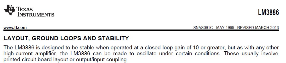

Seems difficult. First of all the LM3886 is decompensated and can't be run at unity gain like the circuit you linked. So you'll need extremely well matched resistors to set the gain=10.00 of each one. Second, the ballasting resistors R1 and R2 probably need to be less than 15 ohms if you're driving a 4 ohm loudspeaker at the output. This means the class-A bias current (=Vdiode/(R1+R2)) will be uncomfortably large unless you abandon the diode and build a precision level shifter with a much smaller voltage drop.

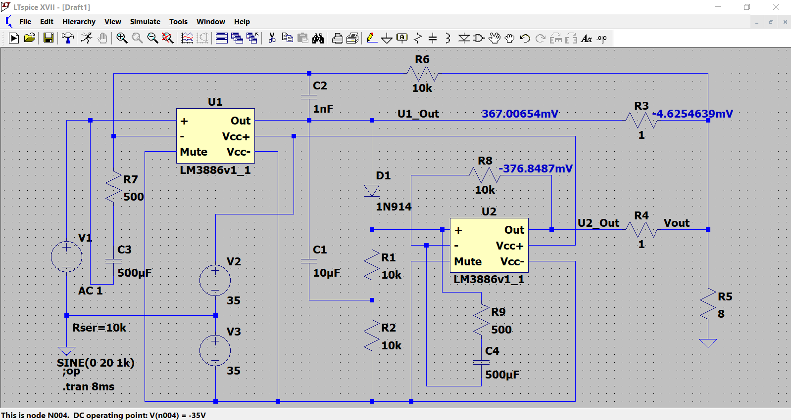

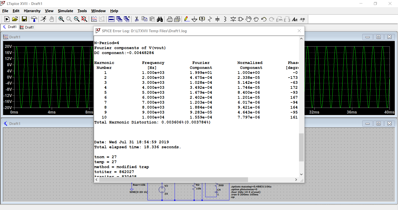

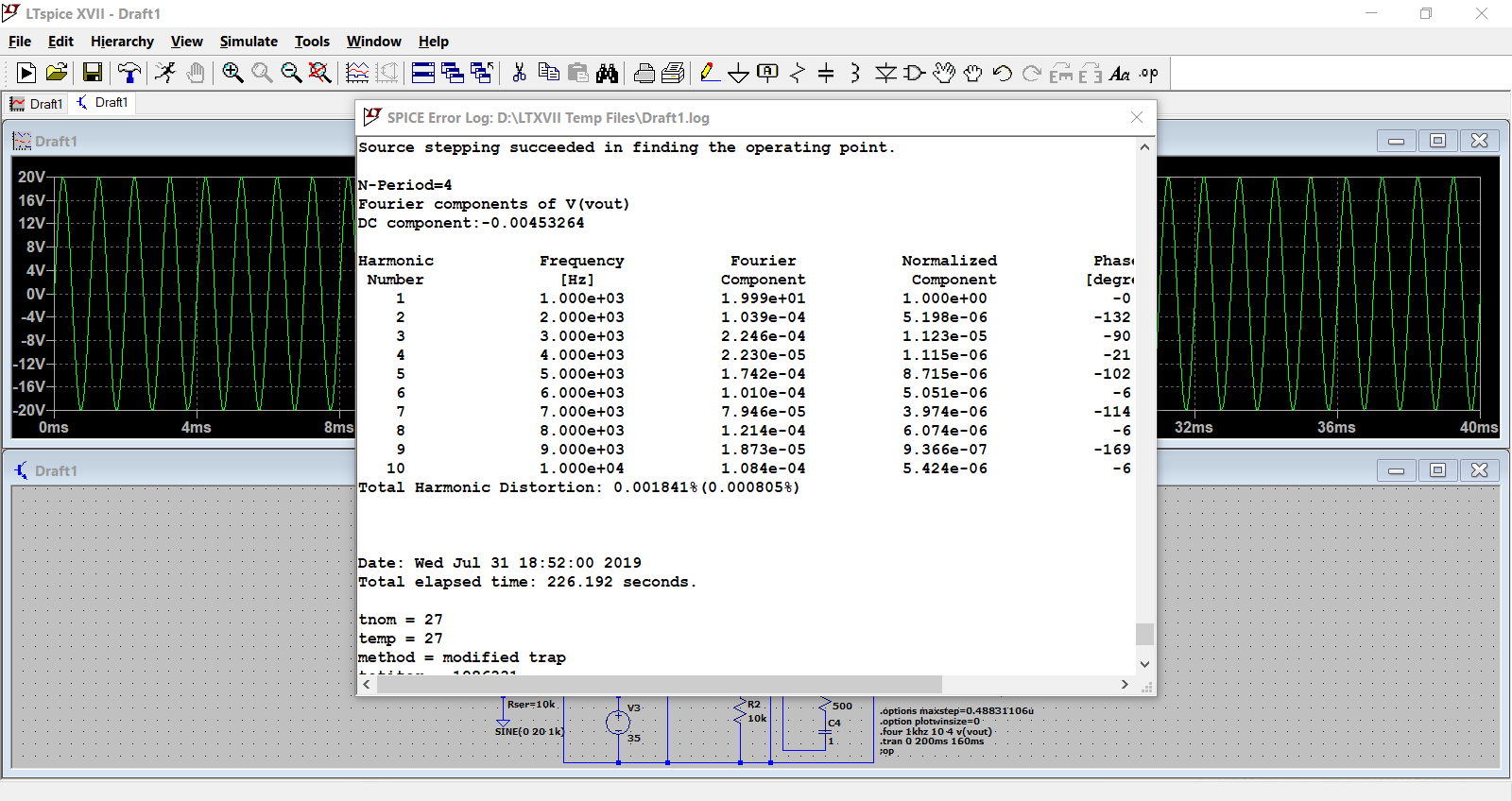

With +/- 35V supplies that's ~13 watts of class A dissipation in each of the two LM3886's. Gulp!
In the left chip U1 the output stage pullup carries 370mA more current than the pulldown.
In the right chip U2 the output stage pulldown carries 370mA more current than the pullup.
🙂 gulp indeed.

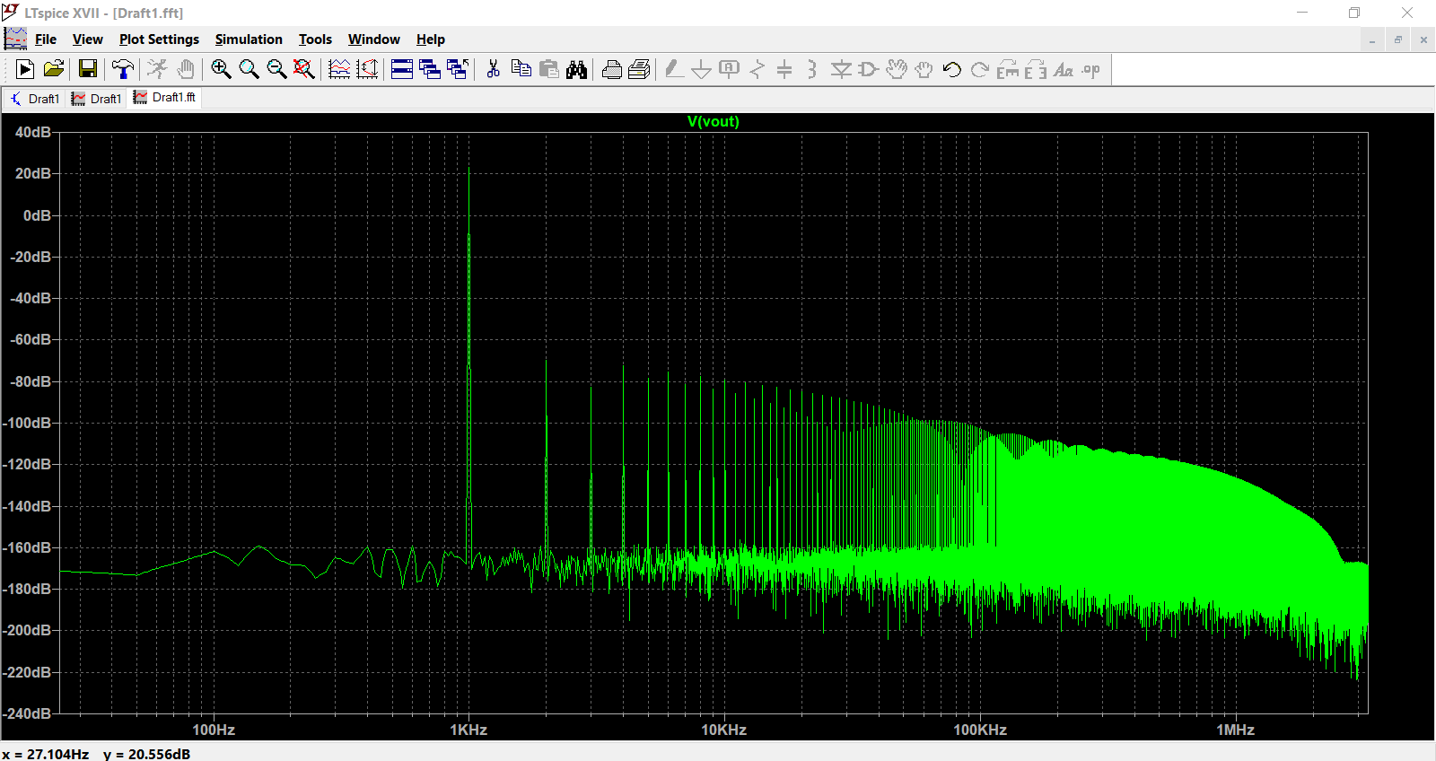

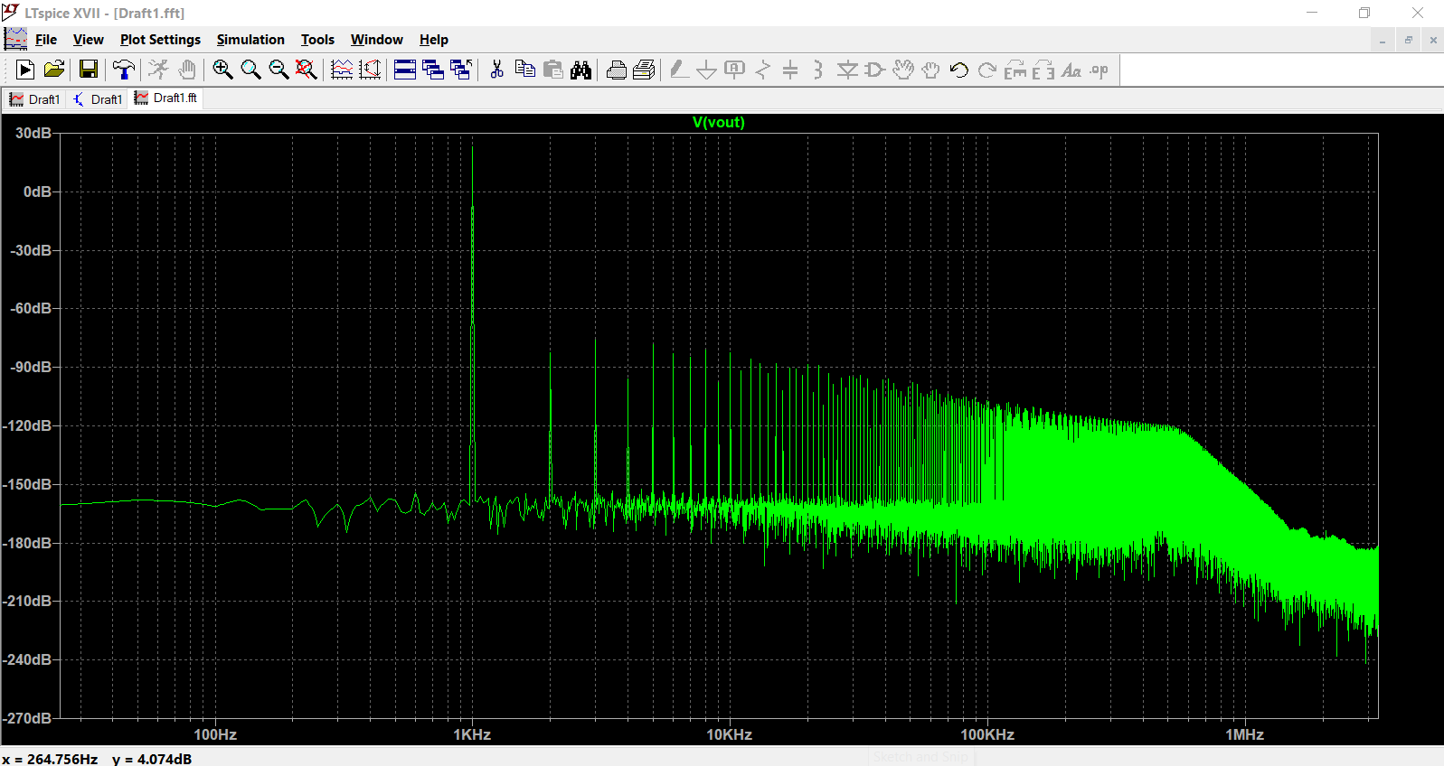

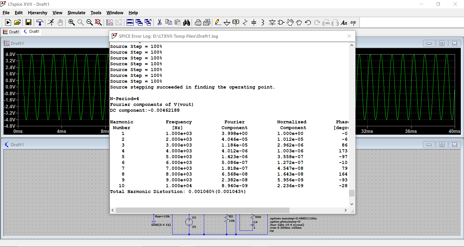

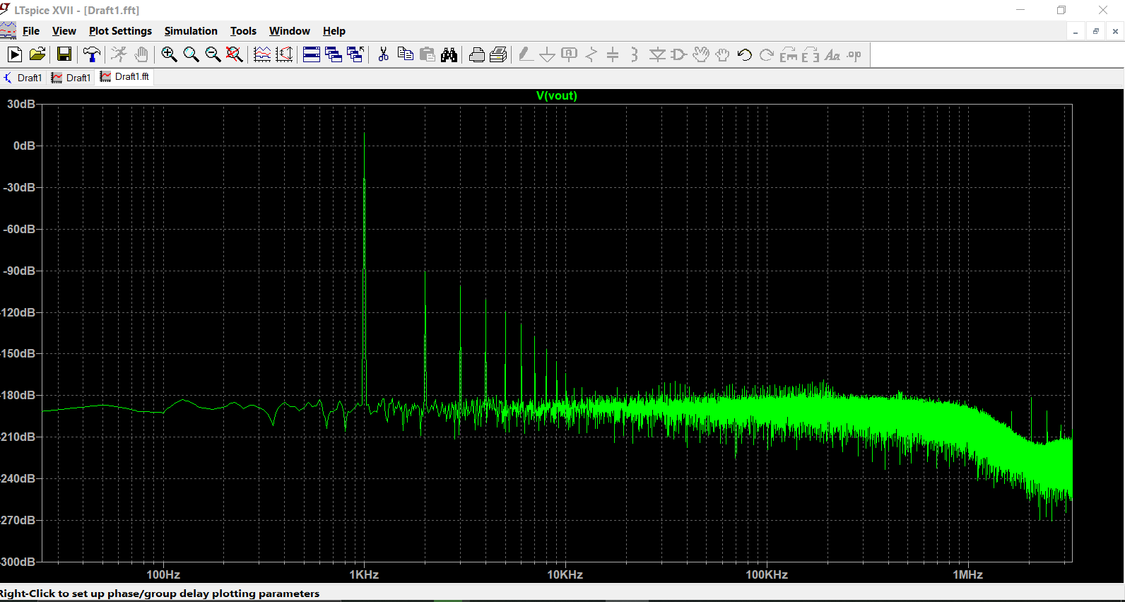

This shows the set up with the two chips (first images) and then just one chip used normally. So it does kind of lower distortion. I also should have used a more appropriate value for the 1nF.
The FFT shows 'odds' predominate in the twin chip version.

Mooly adjusted the diode bias by: doing nothing. The cost was 13 watts in each of two LM3886's. The benefit was: simplicity. It functioned properly in simulation.

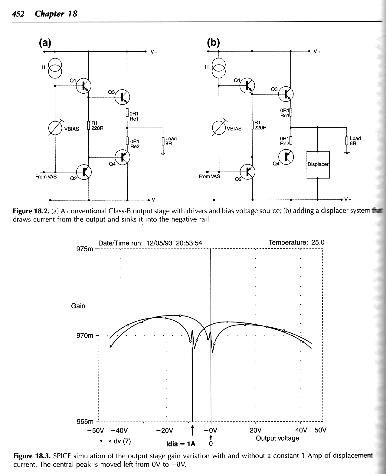

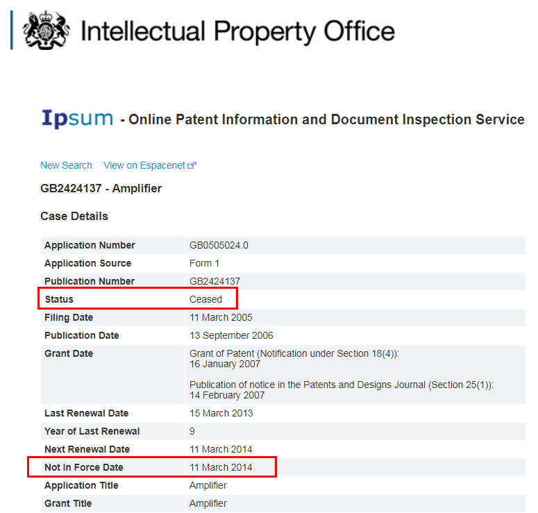

Sounds a lot like Douglas Self's "XD" crossover displacement. The patent appears to have "ceased" / "expired" .
