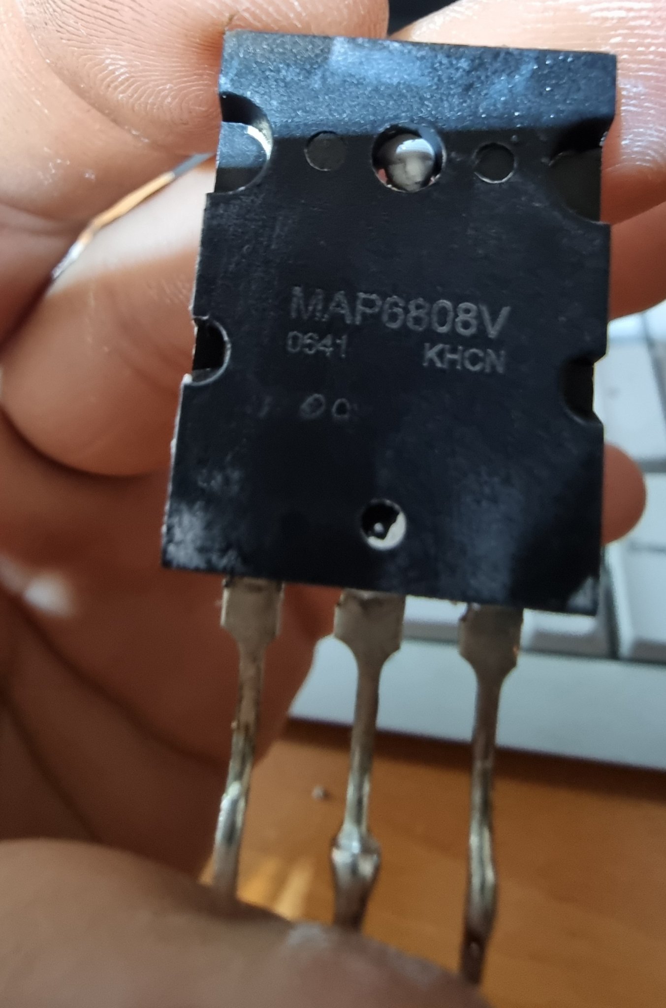

After looking into it, I found out that the heart of the problem, was 4 Mosfets. Now the following question is: What shoud i replace them with. I searched by the serial number, but I couldn' find any. I was looking for some alternatives, but, without any luck... All that I was able to find, were from Aliexpress...
I tested the remaining 12 Mosfets, but they all seem to be within their parameters.
This isn't an FET. It's an IGBT. If you can find a datasheet for it (I could not), compare it to something like the irgp4063.

After reading some more, I found a similar post with the same problem, it was a Hifonics ZXi 1501, that used the same tranzistors: MAP6808. From what I understood back in the days they were using IGBT tranzistors either from Toshiba GT20D101 or Musitech, I googled them up fast but not a lot of options for me to purchase either.
What should I be searching for next ?
Find a datasheet for a known working replacement and compare to the available IGBTs.
If you haven't tried it, Octopart can sometimes give possible alternates.
