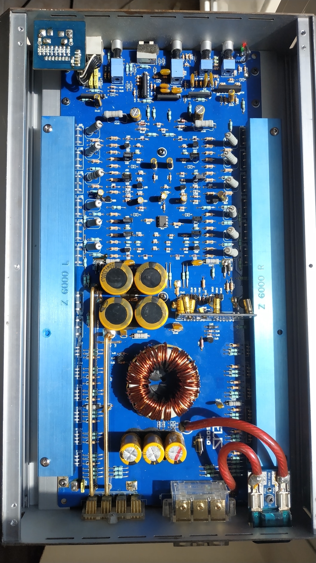

here it is
I don't know this amp but the RCA shields with the circuit it appears to be using generally connect to the non-bridging speaker terminals. It could be a broken solder connection on the RCA jacks (or elsewhere), a broken wire, a connector not plugged in completely or even a broken trace. Check the areas around the small RCA board first. You want to avoid removing the main board if possible.
