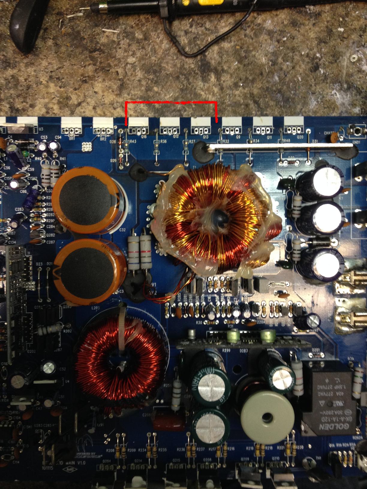

Hifonics HFI 1000.1D
amp had a blown power supply ..
I replaced the drivers A1275 and C3228 with BD139 and BD140
I replaced all gate resistors 47 ohm
I also replaced all fets IRFZ44N'S
When i power it up the amp draws excessive current and 3 of the fets get red hot within 2 secs..
I swapped driverboards froma differnt amp and removed the rectifiers still same issue only 3 of the fets out of 6 get red hot within 2 secs..
Any ideas on what to check ??

Ok i found something wierd going on with this amp..
For the first 3 fets that burn up i checked the voltages on the pads of them..
For 2 of them everything is fine..
but there is 1 of them that measures off heres the voltages i get on the pads..
Gate pad:4.41
Source pad:13.89
Drain pad:11.61
the other 3 fets that dont burn up i get the folloing
Gate pad:4.41
Source pad:0.00
Drain pad:0.00

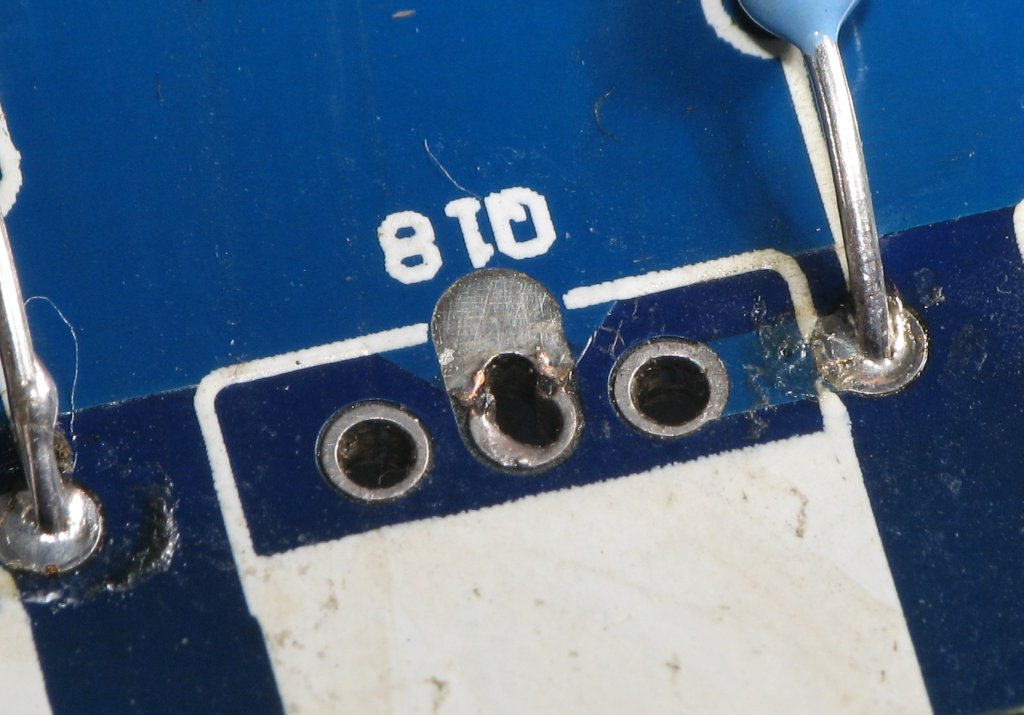

Now that i fixed the broken solder connction on the transformer and also fixed the vias issue Reconnected top of the board to the bottom of the board on pad 3 of 2 of the fets..
I get the following voltages on the pads for all 6 fets..
Leg 1:4.41
Leg 2:13.89
Leg 3:0.00
Since i fixed the broken connections i looked for solder bridges between the pads and found none but the amp likes to blow fets no matter what spot i put them in
Yeah theres a short in the transformer somewhere..
If i find the short and fix it.. can i use the IF3205's in this amp with 47 ohm gate resistors and the BD139/140's?
Only reason i ask is because i dont have enough Z44's since i burnt alot of them up trouble shooting this amp
That's what I use in all of the hifonics amps of this type.
With the limiter in series with the B+, you may be able to see an arc when the short is made/broken when twisted. They typically short either where the terminal windings first make contact with the body of the transformer or where the terminal windings make the first turn over the top of the transformer.
