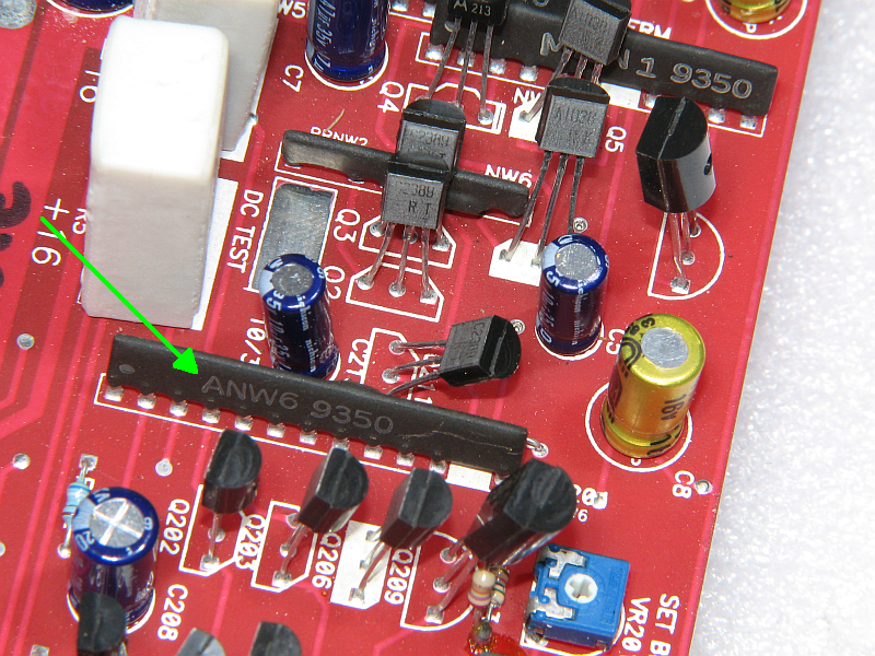

Have you monitored the DC AND listened to the audio at the time the amp shut down? Just because there is initially no fault, that doesn't mean that something in the audio circuit isn't changing. I don't think this amp uses them but some of the encapsulated modules in other similar amps caused intermittent problems. Something similar could be happening here.
I will test the amp with a speaker.
Encapsuled modules are not in, just a driverboard:
I can't tell what you have but the modules that I'm referring to are like the one indicated by the arrow in the attached image. The ANW6 was the one that caused the most problems in the amps I repaired. You can replace the modules with discrete components if you can find the diagram for the module.
These are in, I thought they were just resistor nw?

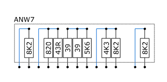

Earlier, I stated that ANW6 was the most problematic. It's was actually ANW7.
The modules varied but the attached diagram shows what the ANW7 was. The 39 ohm resistors appeared to be changed to 120 (or vice-versa). OThe modules had diodes as well as resistors. The biggest problem with the ANW7 was that the 8.2k resistors on the ends began to have leakage to other components and that caused various problems.
