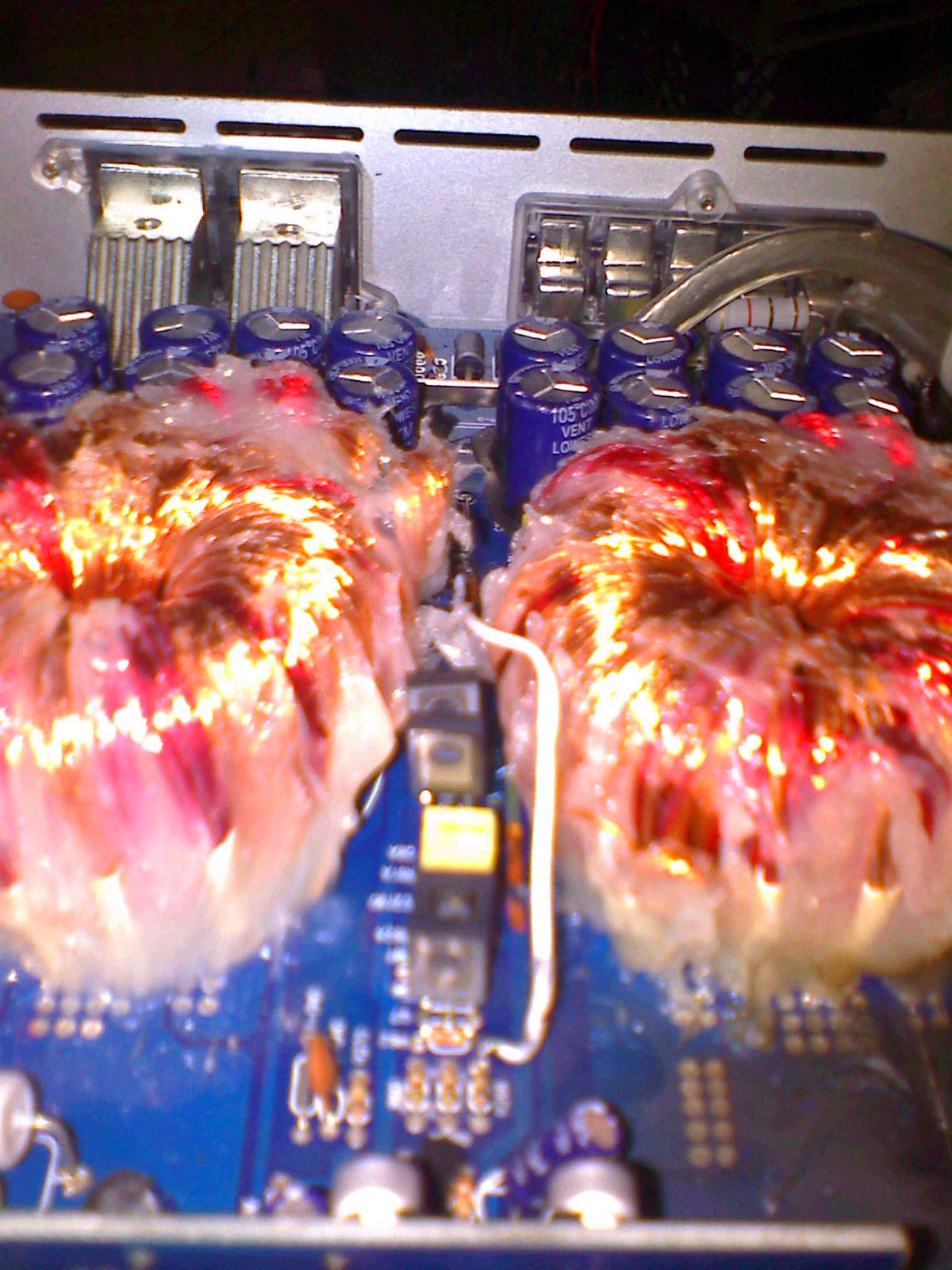

I have all the fets removed and got the BD 139 and BD 140 drivers in place. The voltage at each gate pad reads +4.15 and -8.8 volts. Is this correct? I will post pics of the waveform by the weekend if I can get a scope. Also should the zener diodes at each end of the mosfet banks be replaced? Not sure if they are good but i didn't replace them last time and the amp worked flawlessly until the power supply melted down again.

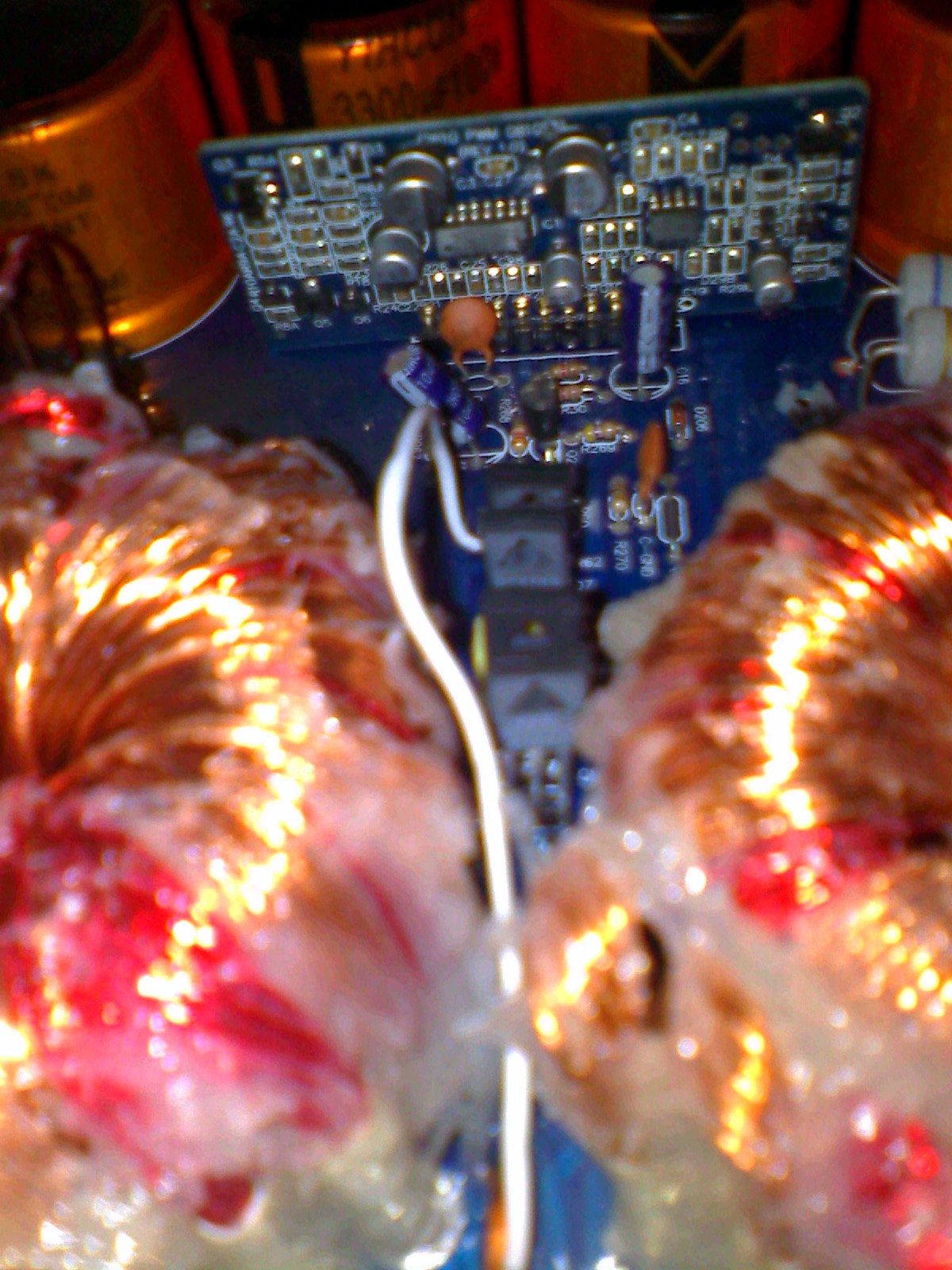

If you're referring to the power supply drivers, there shouldn't be any negative voltage. Post a photo of the area of the board where the drivers are located.

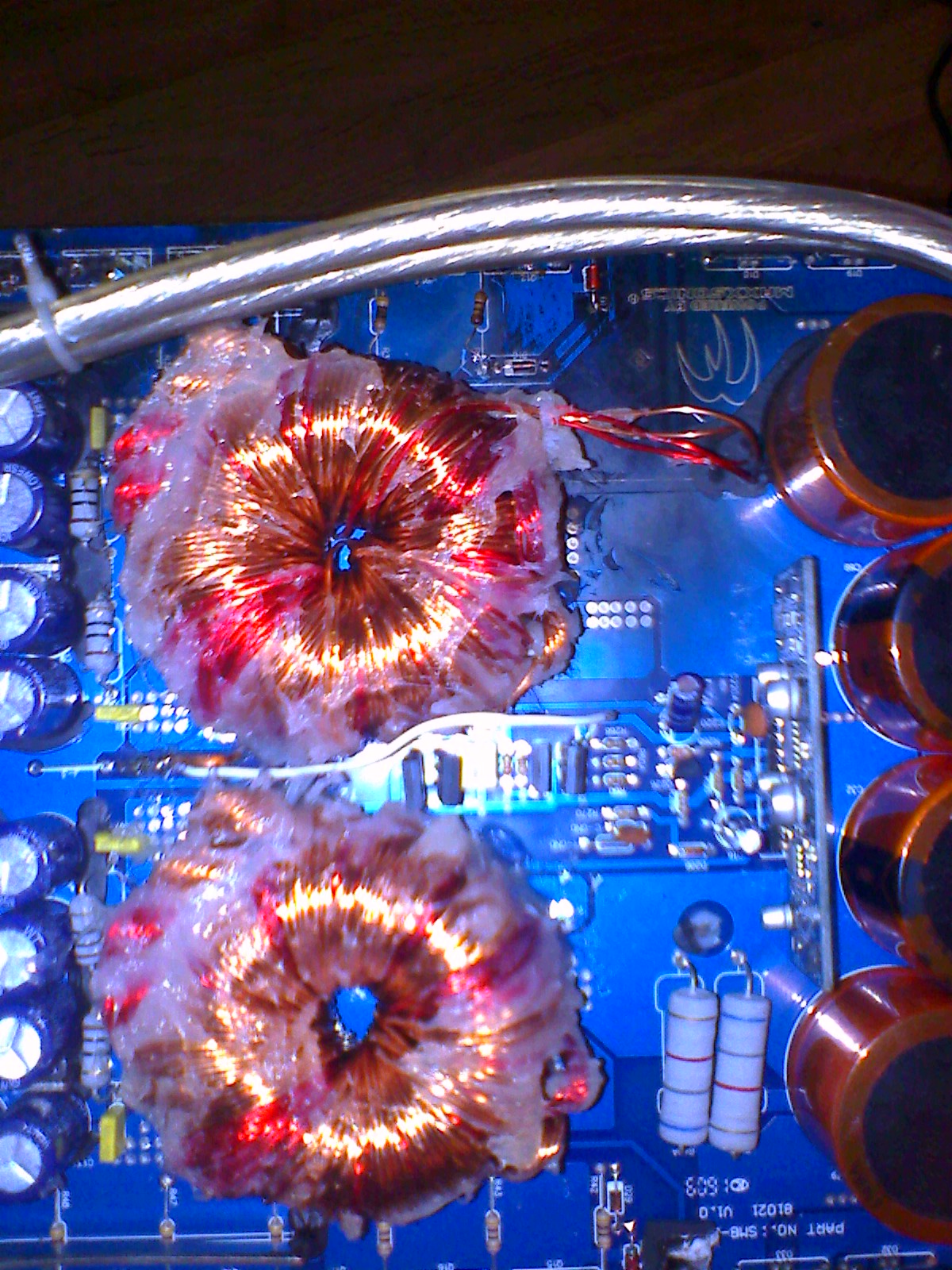

They are between the toroid transformers. The white wire is ground that burned a trace going to the PWM board and the driver transistors. I believe it was due to the drivers shorting out. Correct me if I'm wrong though.
Yes with positive lead of DVM hooked to B+ and Black lead touching the Gate pads of the fets there was 8.8 volts. With the black lead hooked to ground there was 4.15 volts. Not sure if this is supposed to be but a waveform would definately clear up any confusion. Will get that posted asap.
Place the black meter probe on ground terminal and red probe on the legs of the drivers -- 1 leg at a time.

Place the black probe on the amplifier's main ground terminal and the red probe on the gate pads.
Black probe on ground and red on gate pads showed 4.15 volts. I also only removed the fets that showed signs of damage: blackened and cracked which was only on one side of the amplifier's power supply. The other side's fets all had a shorted gate but appeared fine. This gave the other side of the fets ground causing the meltdown. The drivers may have been fine but i replaced them anyways. Now I put two good fets back on one side of the amp and it powers up and i get 73 vdc on the output rail. Now to just put all new fets in and we're good to go. Where can I get genuine IRFP064N that are from one batch and not from china. The previous one were chinese which is probably why my repair failed again. This is a well designed amp but cheap components are my downfall at this point. Thank you guys for all the help. I really appreciate it. Im only 19 so im still learning electronics but its my favorite hobby of anything 🙂
Ok black probe on amplifier ground starting with driver closest to PWM board:
BD 139
E: 4.08 V
C: 12.35 V
B: 4.12 V
BD140:
E: 4.08
C: 0 v (gnd)
B: 4.12 V
Does all this sound about right Mike?

Well They all checked out to be within tolerance at 46.5 to 47 ohms and I am getting 4.15 volts at each gate. Is the -8 volts I was getting with positive lead on the B+ terminal and the black test lead on each gate pad used to turn the mosfets "off"? I know the rising edge of the wave turns them on and the falling edge turns them back off correct?
