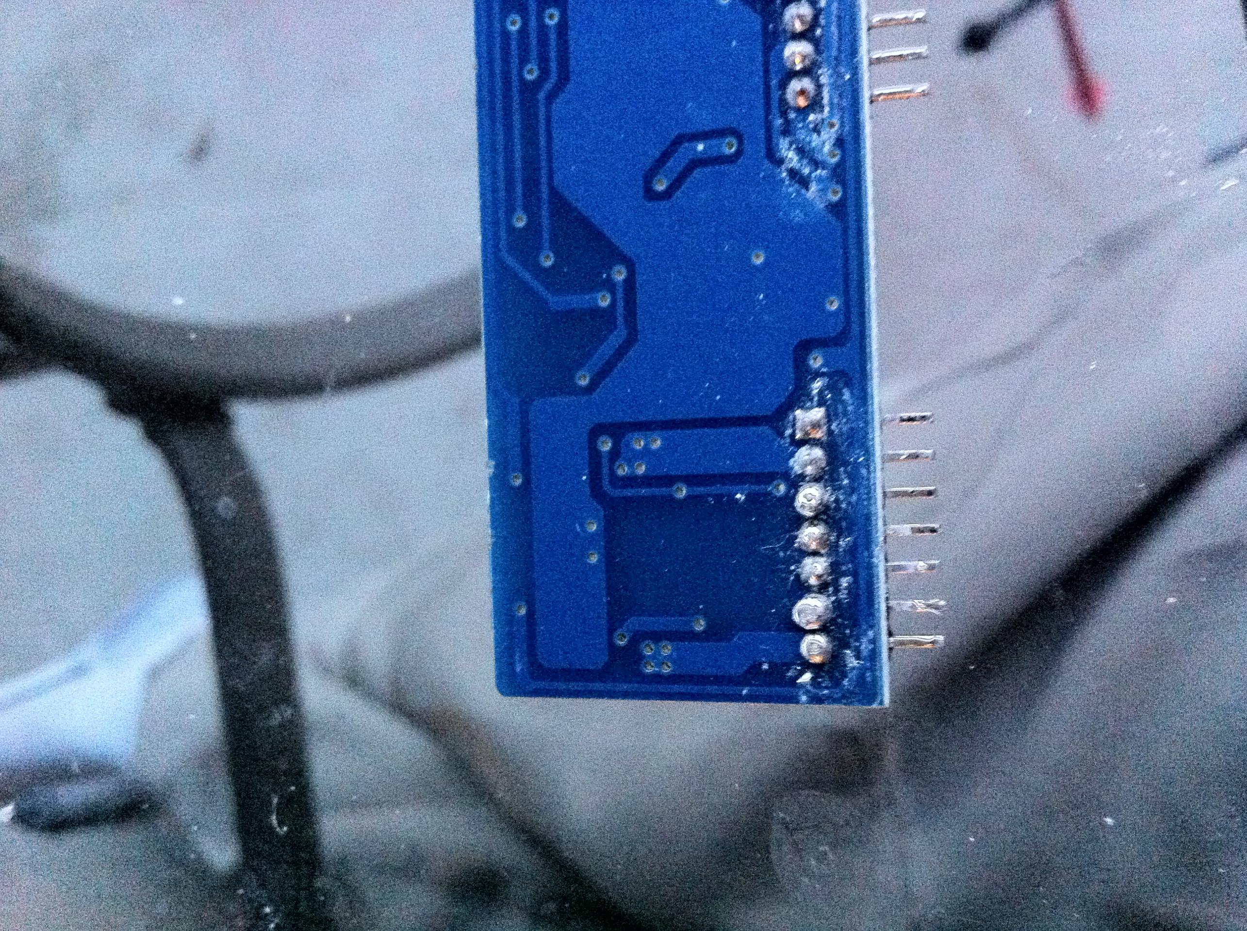

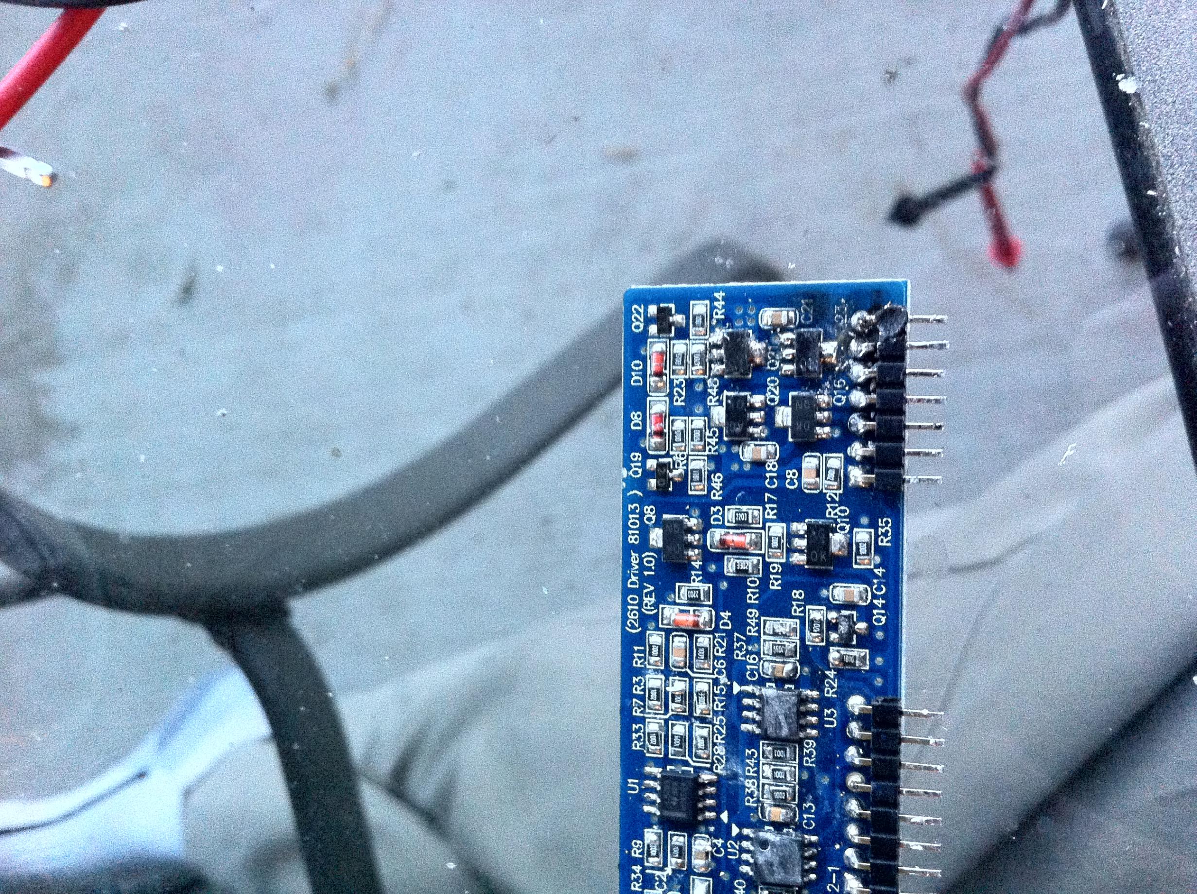

I've only repaired 6 other amps but they have gone smootly but this one is being a PIA it's my fault though. I read on your website that you need to be careful when the amp is powered up and you check voltages. Somehow I wasn't careful enough and I made a mistake that I'm learning to never let happen again. I crossed the lead with R22 and 22 (the end pin on the vertical board) and there was a spark, then the amp went into protect. I'm really sorry Perry, I appreciate your help a ton and now I made a mess of this one.
I'll tell you what I checked:
R22, C54, Q23 and Q21 out of board, Q16 Q20 Q22 in board, on the other side of the board the transistor opposite Q23 out of board because they were connected, continuity of circuit board connections around spark, resoldered pins on bottom of board. After doing all of this I reinstalled the board and the amp still went into protect. I then took out the board again so I could keep testing.
Could you please help me with what I should check next?
I was trying to check voltages on different spots to see what was working properly and what wasn't. The output fets seemed ok but he speakers had barely any voltage so I was looking for a possible cause.
Here are some pics of my disaster.
