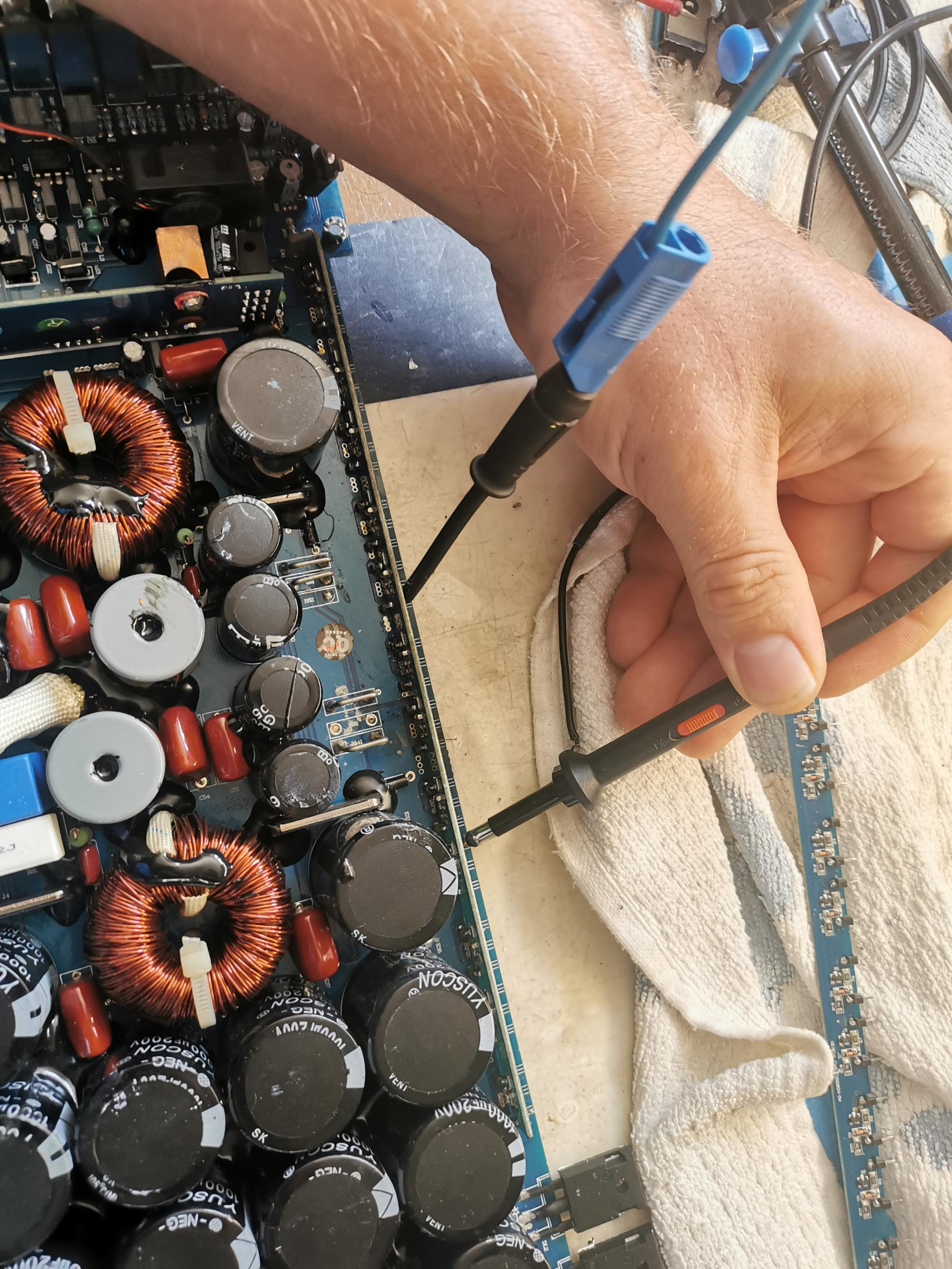

I got this hifonics with some output fets blown. Repaired doughter board. Drive board seems OK, and is buffered. On one side I don't get a signal, even no voltage.
One side is negative, the other side has only positive rail voltage. Black probe at sec center. Rail voltage are ok.. Maybe someone has an advice
So, I changed both drivers, because one was damaged. Left side of the board is high side, right side low side. Signal on low side is OK. But I don't have positive rail on the drive board. Also the driver buffer transistors shows 0v..this design is new to me.. Any suggestions?

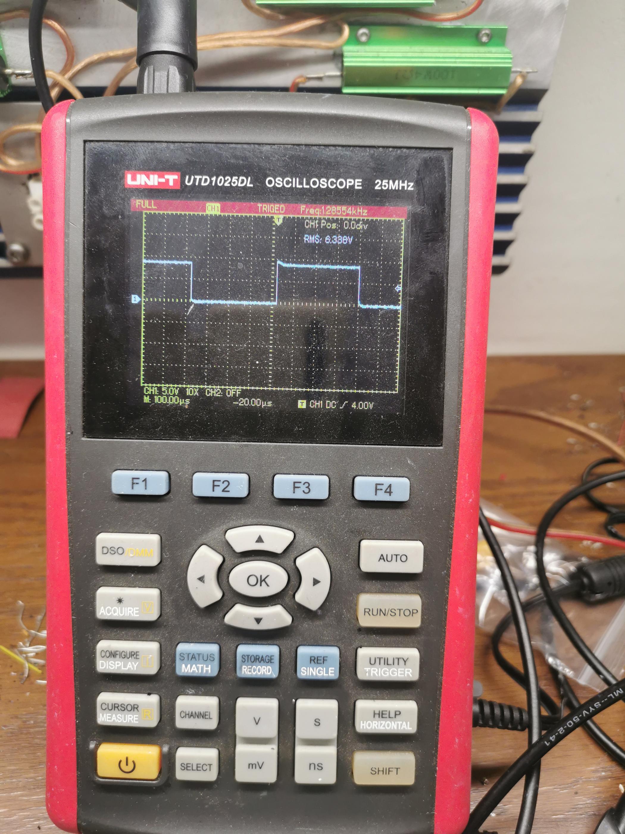

It seems, that the switching frequency is very low.. Maybe still some issues with the drive board.
If i inject audio signal, the frequency will even drop more down. If I inject 50hz,the signal also goes down to 50hz.. Very strange. I will check the drive board again.
These aren't typically clocked so the only reliable drive is the signal you drive into it.

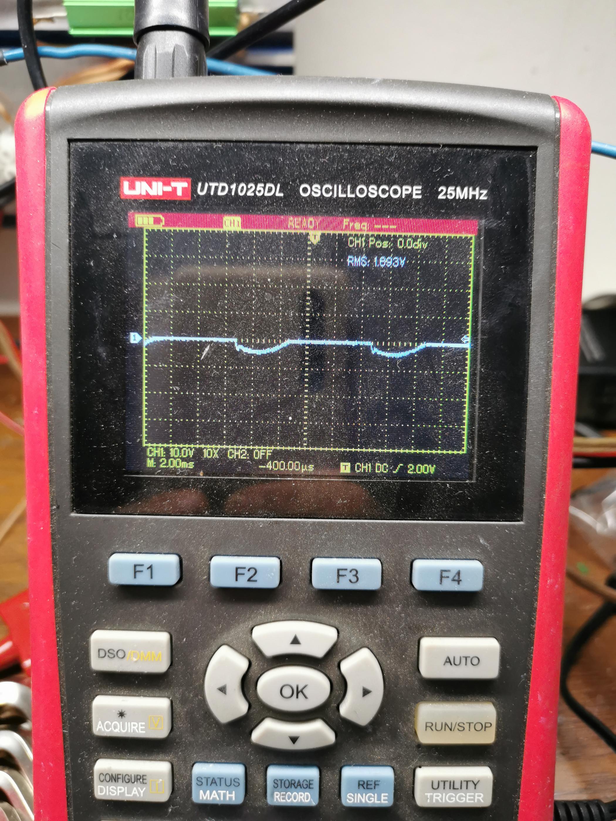

It seems so. I tested with a 2,4 ohm resistor on the audio out, with a 150 amps PS. If my input voltage drops to about 10v, the upper half of the sine drops.. But I think that's normal.
I think there is a voltage regulator, which drops below 10v and then the high side mosfets are not fully open anymore.. Or du you have another suggestion?
I would not expect it to lose only 1/2 of the drive.
The high and low sides are supplied by the 12v regulator referenced to the lower rail. The low side always has 12v. The high-side only has it when the FETs are switching.
The drive is dropping in very short cycles... I don't know if I can do something against that.. 9.9v is allready very low input voltage. And I don't know what can cause that, if the 12v regulator is bound to the rail voltage.
Measuring the voltage across the collectors of the drivers, is the high-side B+ dropping just before the high-side drops out at 10v? Don't try to measure this if there is a chance of slipping and shorting between any terminals.
The problem may not necessarily be at the output board but possibly at the power supply end in a low-voltage protection circuit. I don't think any 12v amp is expected to work at 10v in. That said, it's difficult to drag a healthy 12v battery down to 10v. Would the voltage get that low in the vehicle if the system was capable of supplying power to this amp?
