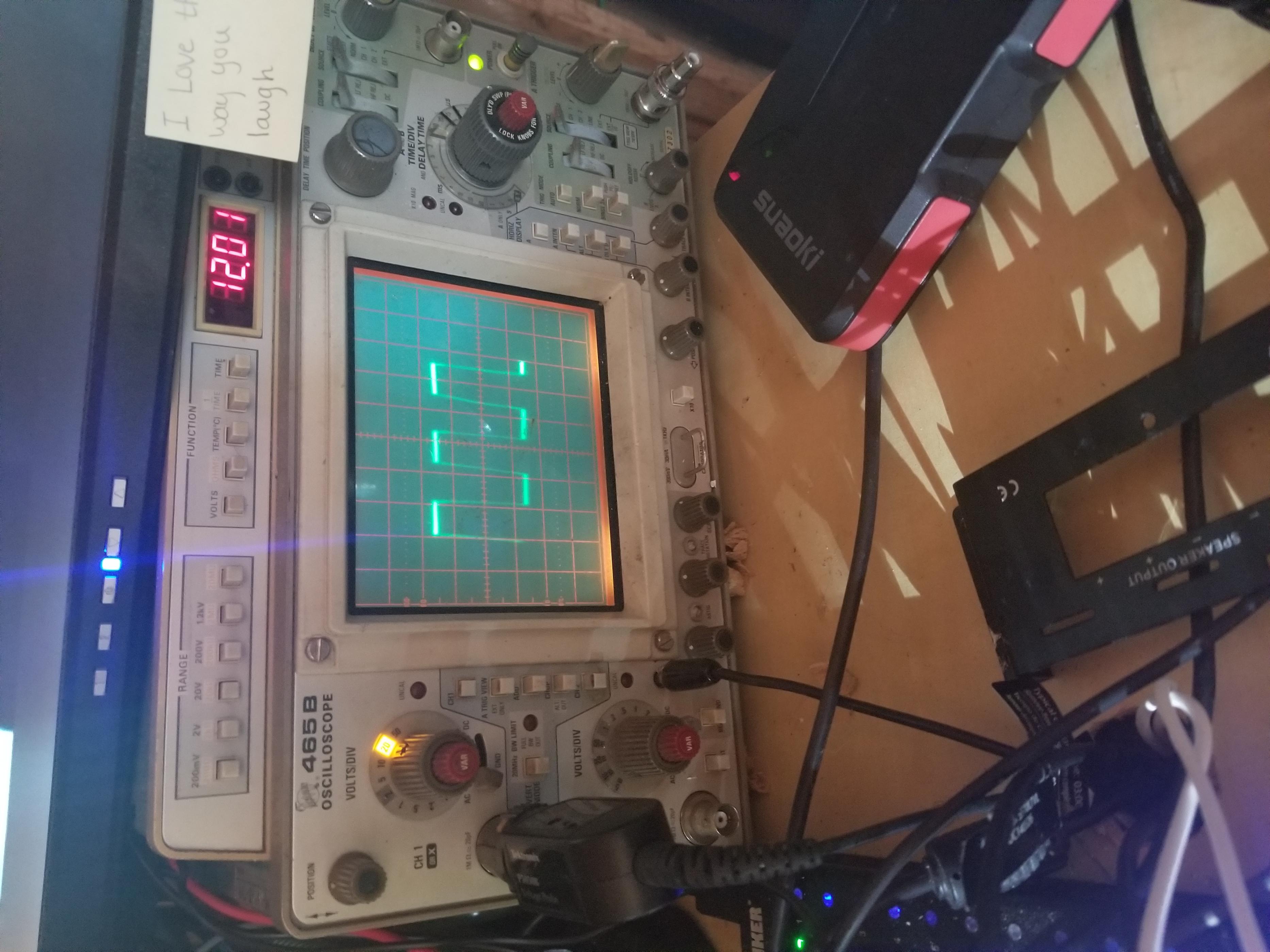

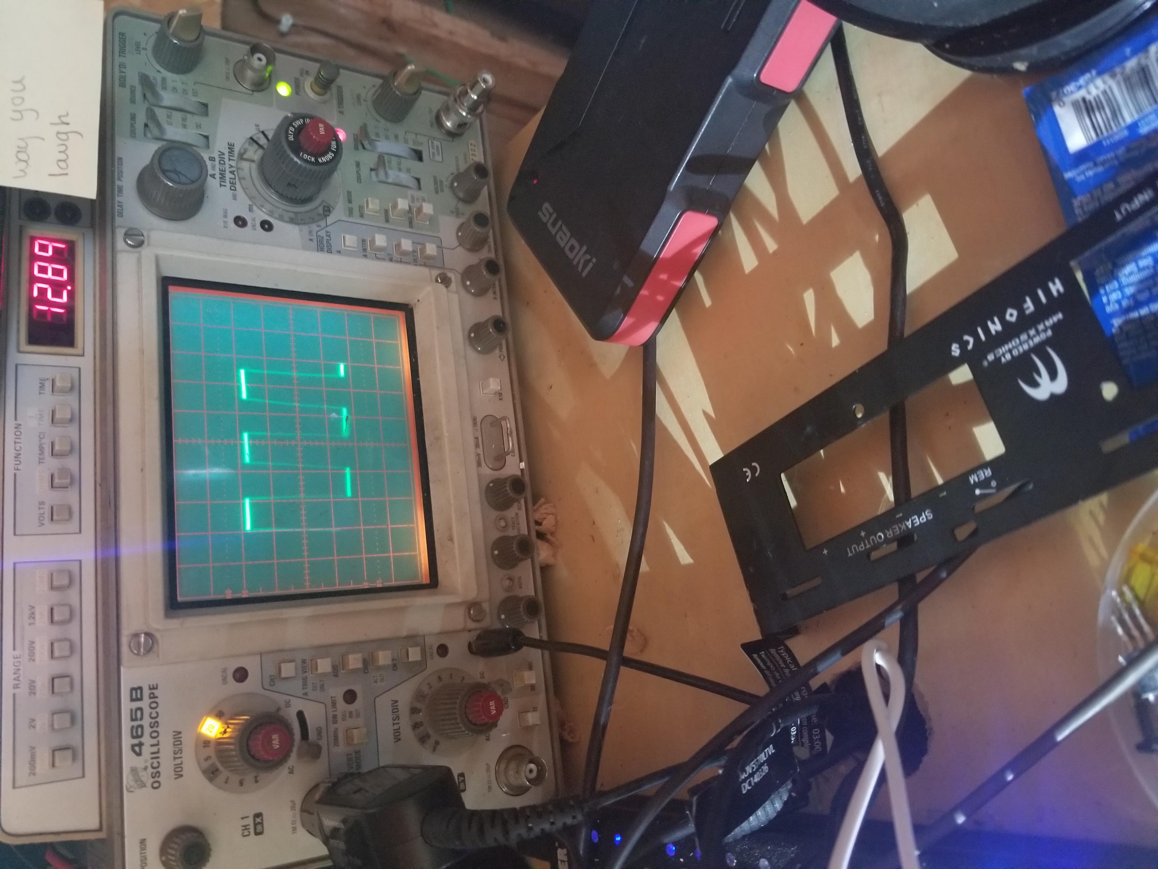

With your scope, look at the input and output of the rectifiers. Is the peak voltage into the rectifier essentially identical to the output of the rectifier?
Does that voltage remain relatively constant when the amp is driven hard?
At D32 FMG33R and at D33 FMG33S.
Voltage going into the amplifier is 12.89V
Under heavy load the voltage is drop for my power supply is about 1 volt.

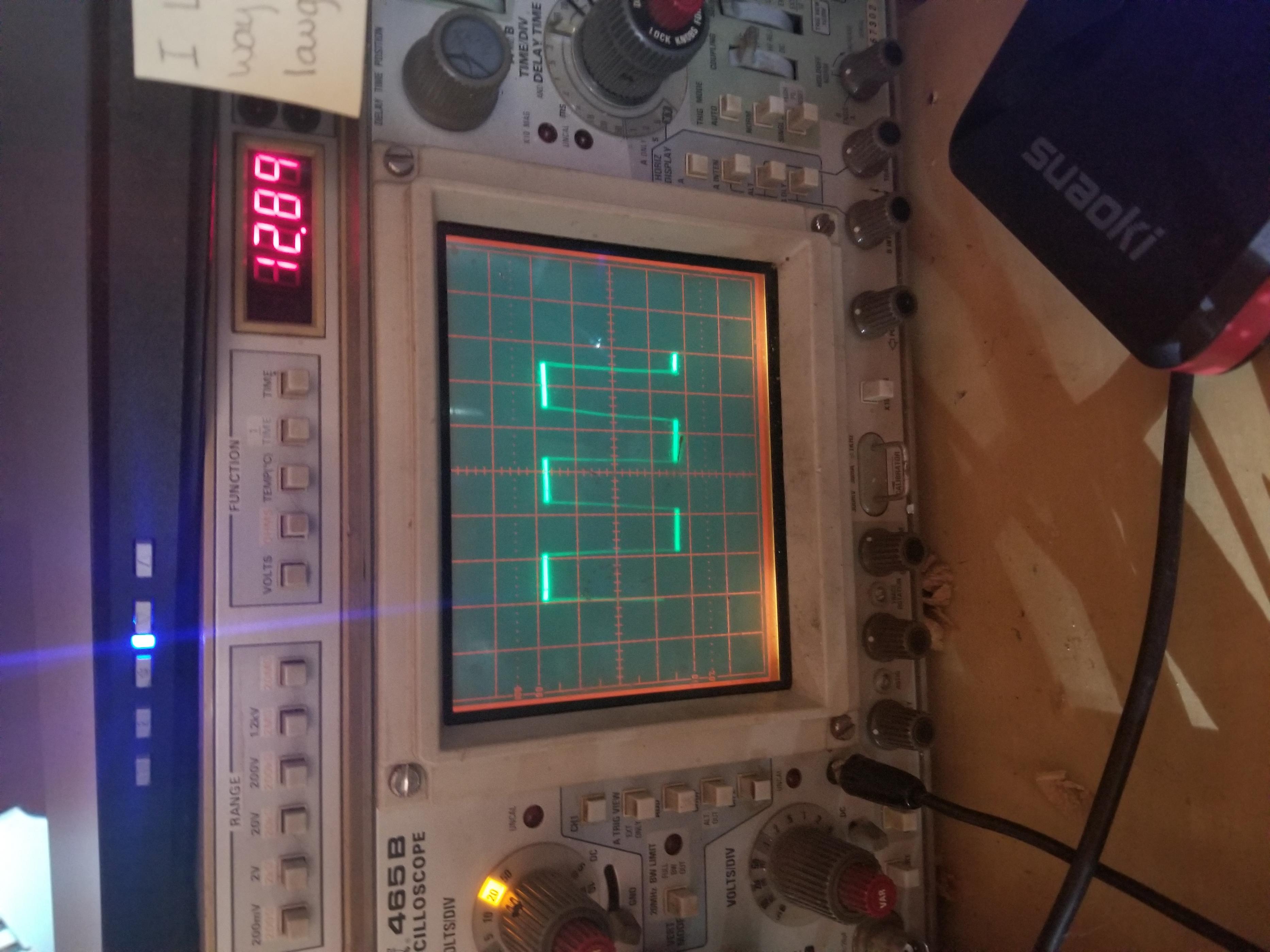

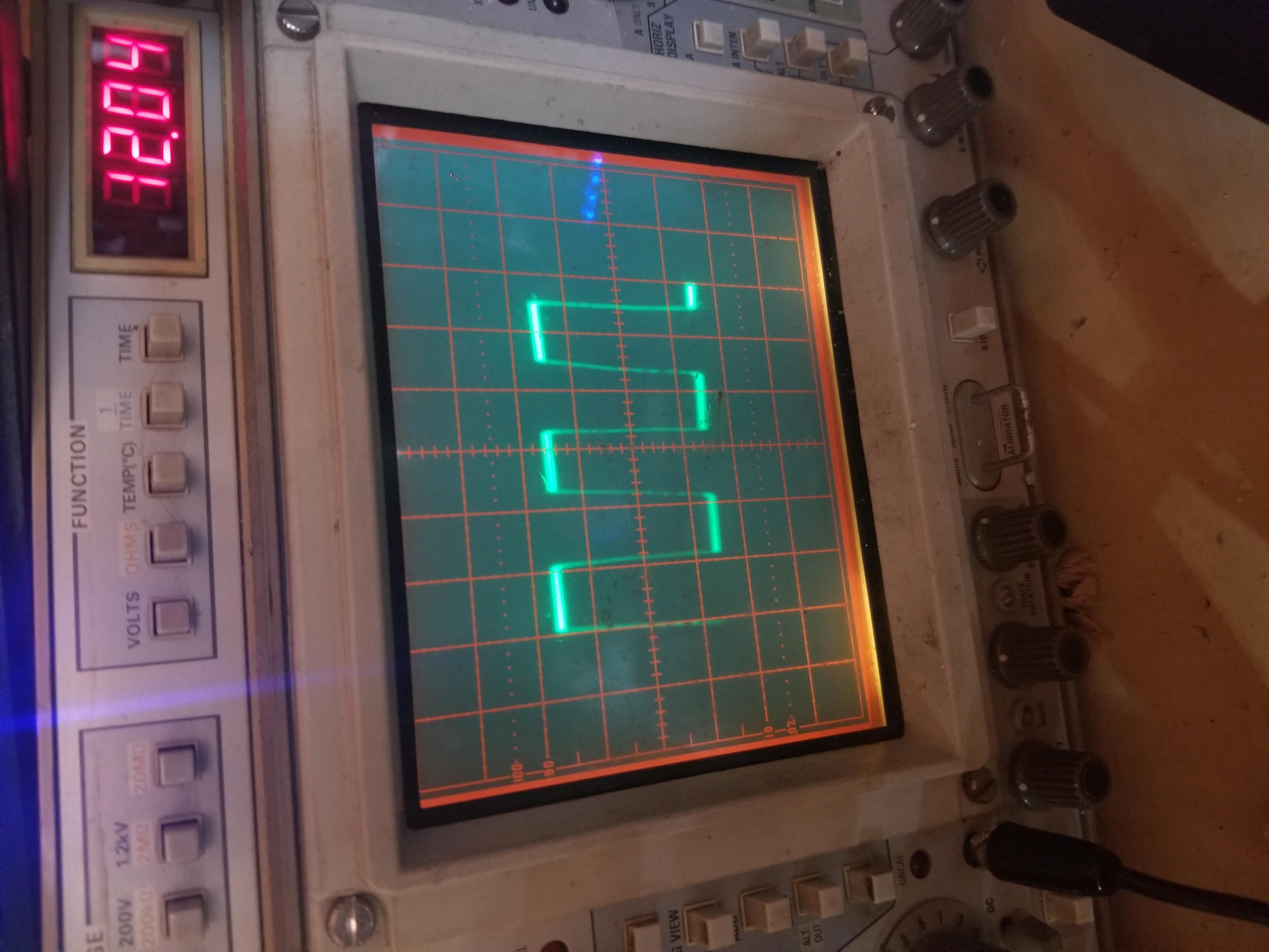

I have attached what I am seeing.
Rail voltage +-73 No Load and +- 65 under load.
