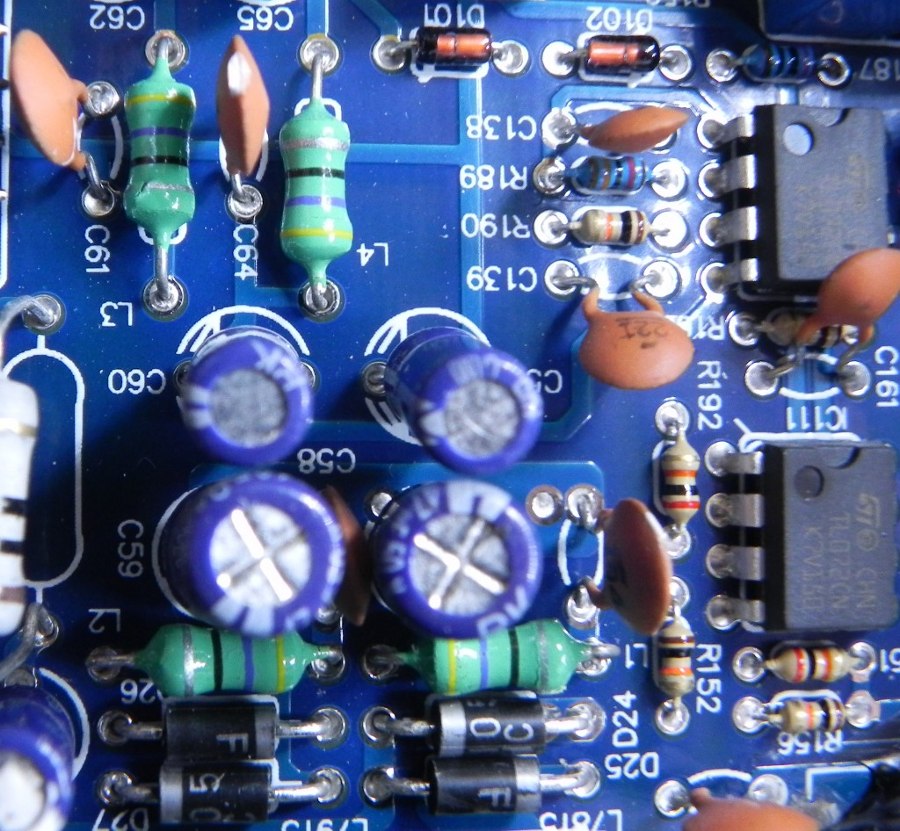

Just had this exact issue with my BRZ2100D.1D and could not find anything wrong. Came across this thread in my search and took another look at the board.
Close examination revealed L1 and L3 had visible damage and L1 tested open. Replaced it and my amp is working tonight. Thank you! I was just about to give up on this and buy a new amp.

Okay..now that you timwebb mentioned, this next GZ 1.4000 has a problem - output relay clicks but no output 😀
I changed a couple of op-amps from preamp, checked those inductors, +/-5V , 12V and 15V are ok..here´s a picture from board:

Yes I do have both +/- 15V on every opamp, I just tracked down the problem with scope and it seems that signal is going into output driver board but nothing is coming out - so the problem is on the driver board.
Looks like the fault is in U3 -> TL072C, signal goes in but no output at any of the other pins of that opamp.....
Okay..the problem is not in the driver board. I changed all 3 opamp´s on that driver board and have still no sound at output terminals.
I tested this driver board in another amp and it worked fine. Strange thing is that signal really seems to go in driver board but won´t come out, but still the issue is in main board 😀
Does anyone have any ideas for this one? I don´t know what to measure anymore..or were to look at. All +/-5, 12 (to rail voltages 88/100V) and 15V are ok.
