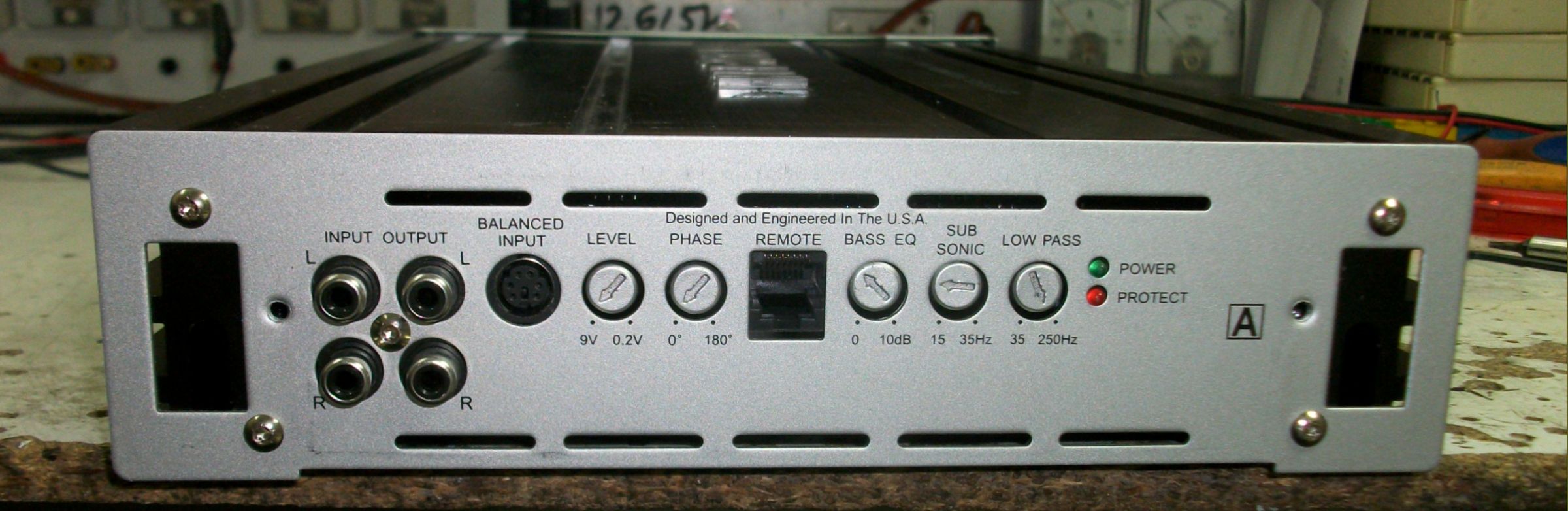

This amp came in for repair.
Upon starting up goes to protect instantly.

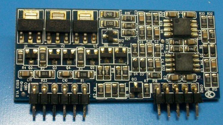

Tim's correct pull the output driverboard and the amp should power up fine..
Thoose amps are common for the SMD transistors failing on the output driverboard..
Good news, MMBTA42 and MMBTA92 came on Friday.
I also replaced the three SOT223, just in case.
Now, amp works fine.

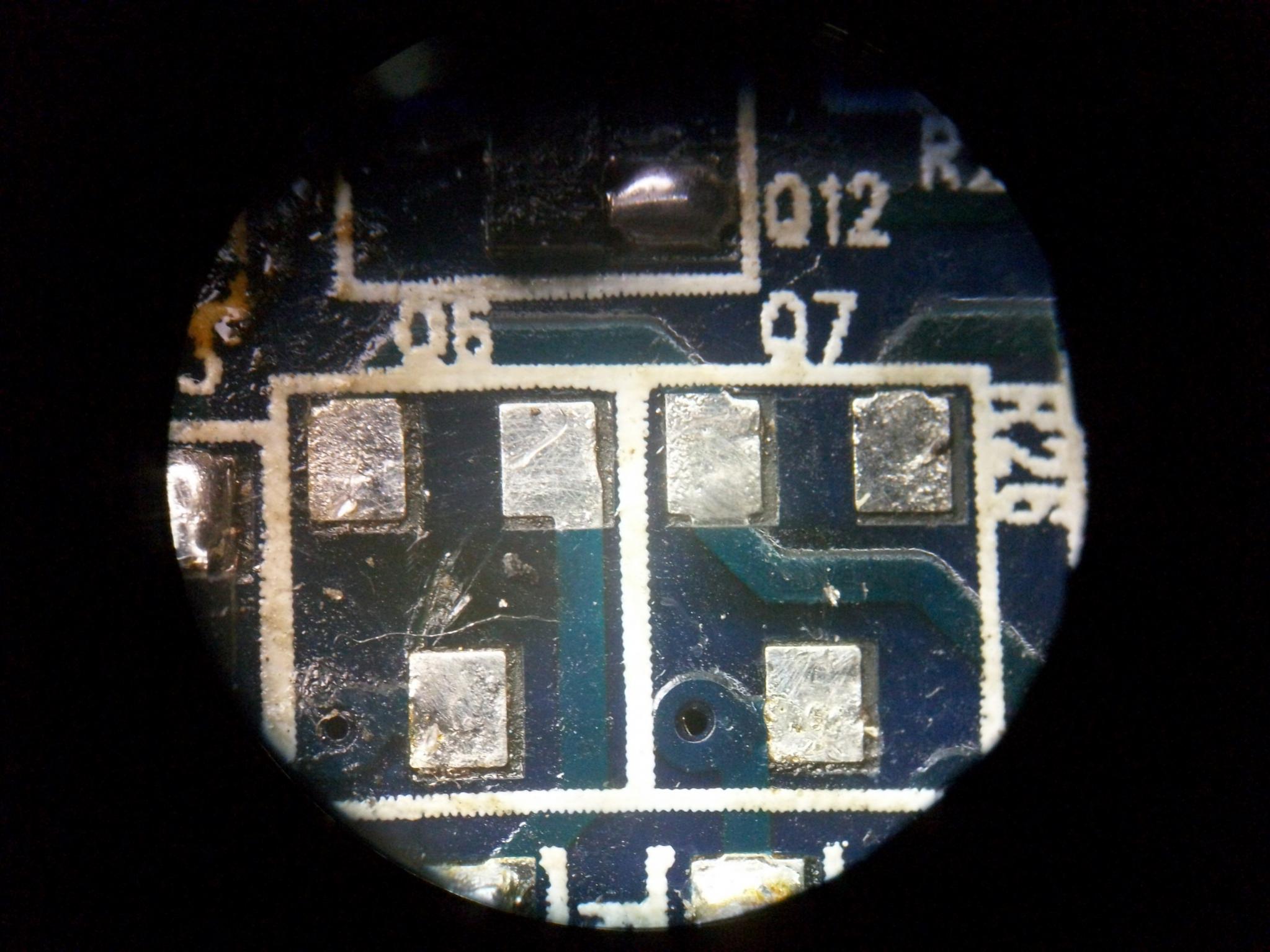

Q6 and Q7 (on this board) commonly fail and will fail again if you don't take steps to keep them cool. You probably noticed that the board was discolored under the transistors from heat stress. This is a common problem that's been covered in various other threads. On the other boards, Q6/7 are designated as Q1/2 but you can't see the Q1/Q2 designations until you remove the two transistors.

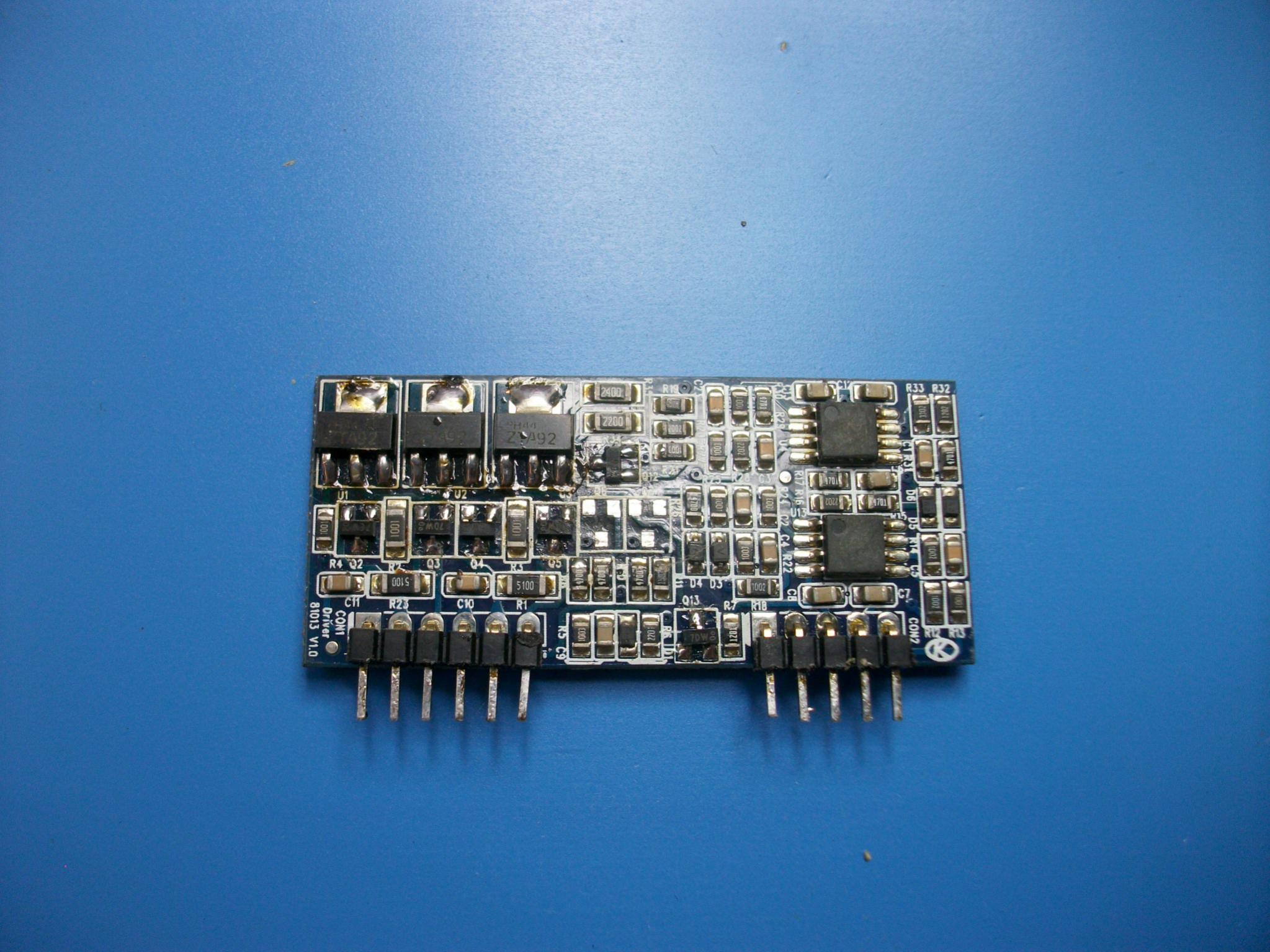

All 11 transistors were replaced on this board.
After removing the parts with a hot air rework station, and cleaning everything
with acetone, i checked the board with a strong stereo microscope,
and didnt see any signs of heating on the board.

Finally, you were right Perry.
It lasted only a couple of minutes.
So, whats the solution to keeping the transistors cool,
swap them with TO-92 devices?

They shouldn't fail that quickly. They fail but generally only after several months. If they fail within a few minutes, there is another problem. Q6 and Q7 are in parallel. Are you sure that they were both soldered to the board? I'm assuming that those are the ones that failed because they are the ones that most commonly fail.
The problem is different now.
With the rca connected the amp goes to protect.
Without them, it powers up fine.
I measured the output rca shield with the power gnd and showed 0 ohms.
This did not apply for the input rca. Upon grounding the input rca shield,
powers up fine.

With no RCAs plugged in, you should not read 0 ohms between the RCA shield and the amp's primary ground. If you do, the amp is likely to have a lot of engine noise.

It appears that the other smaller transistors have been replaced and the numbers are not the same as what's generally in those locations. Are the transistors rated the same as the originals?
Original MMBTA42 and 92 are marked 1D and 2D and are rated at 350mW.
my ordered MMBTA 42 and 92 that came from Farnell were marked 7DW and 7EW,
and are rated at 250mW.
I think of trying to fit TO-92 devices, rated at 625mW, put the module back, and check wether with the RCAs plugged and zero audio in, the amp goes to protect.
