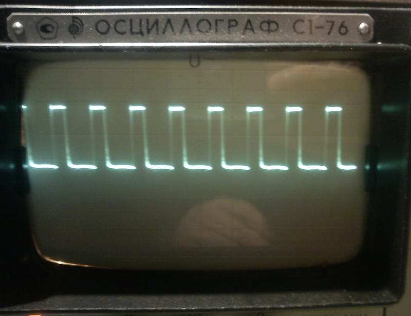

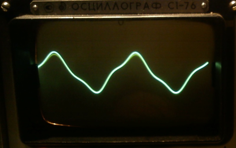

I got another Brutus BXi1600D. This amp powers up fine, produces audio but often I have to turn the volume pot for it to start producing audio. Also 100 Hz sine often looks more like a sawtooth but sometimes I can see clean sine on speaker terminals.

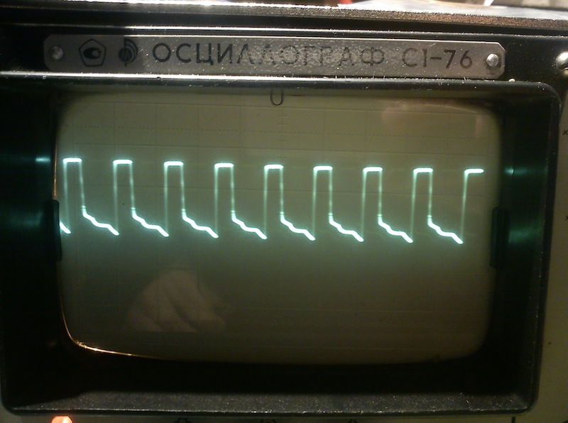

Amp has been repaired before, PS FETs drivers have been replaced with BD139 and BD140. Waveforms on drivers look nice but on the FETs they do not look so good, is this something to be concerned about? FETs are IRFZ44Ns with 47 ohms gate resistors.

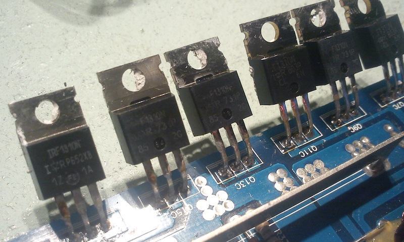

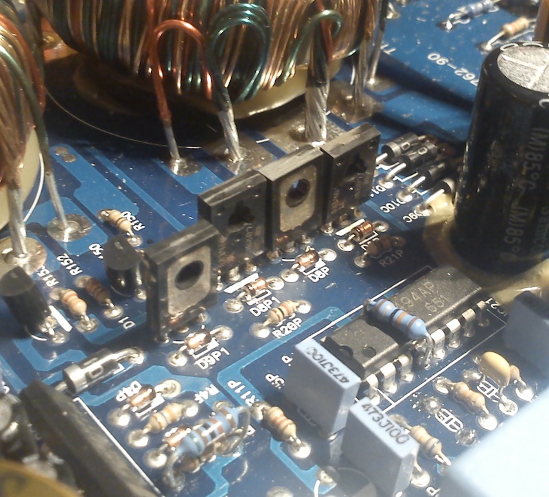

HIP4080 has been replaced, for some reason socket has been removed and HIP4080 is installed without it. Two banks of outputs have been replaced with IRF1310N, other two banks are IRF3710.
I have 10 good IRF3710s, which worked in another Brutus, left. Right now all I can think of is that those 1310Ns are causing this.

Replaced the IRF1310N with IRF3710s. Do not get me wrong, I know that if I would order new parts and bought IRF3710, they would not work. Instead I used IRF3710s from another Brutus, in that amp some of the outputs had broken legs, it was for a paying customer so I replaced them all with IRF3710Zs. I did not throw out the old ones because I knew I could use them for troubleshooting in this kind of situation.
Anyway that did not solve my problem. I started to check for audio on opamps and measured DC voltage on their pins. DC voltage did not show anything unusual, each had very similar voltages. Last opamp before 330uF cap did not have any audio on any of its pins, replaced it and for now amp is working, producing clean and loud output.
If the outputs are swinging cleanly from rail to rail, even when the output is distorted, the class D section is likely OK.
I'm assuming that you've checked the zener and it's at about 6v, even when the signal is distorted.
Did you follow the signal through the op-amps (starting at the RCAs) to see where the signal becomes distorted?
Zener was OK, 6,1V across it. Waveforms on 4080 were also good.
I think there was something wrong in the preamp, and to get some signal on the speaker terminals I had to turn the gain pot very close to maximum, I think I drove it to clipping and that is why the output was not so clean. Could it be the case?
