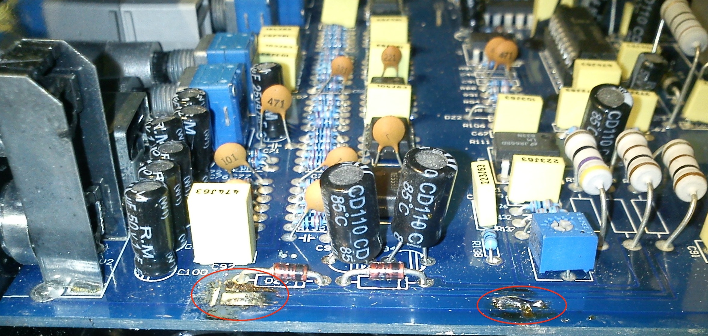

The transistors etc. have not been replaced but there was a fixed trace, it seems to me that it is just ground trace leading nowhere, see attached picture.

It appears that that area got hot. It wouldn't have gotten hot if it didn't go anywhere. Is there a via that goes to the other side of the board?

The fixed trace is connected to RCA shield.
There are 15V Zeners, maybe they got hot. One opamp appears to be defective, it has 0,3V on output, 0,18V on one input and 0,10V on other input. I will replace it and see if it will have any effect on the current draw.
Replaced the opamp and current draw is down to 1,53A without the rail caps, output transistors and 8 out of 12 PS FETs installed.
