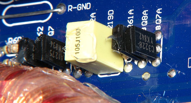

Im back to this amp i took the drivers out for the fets. And forgot what was in there Wondering if you know what drivers they are using for this amp ??

So Q7 A is c3228
Q8A : a1275
Q7: 1275
q8: c3228
Correct?
So Q7 A is c3228
Q8A : a1275
Q7: 1275
q8: c3228
Correct?
Original:
http://www.keccorp.com/data/databook/pdf/KTC/Eng/Ktc3228.pdf
Sub:
http://www.fairchildsemi.com/ds/KS/KSC2383.pdf
Mouser: 512-KSC2383YTA
I don't have a source for the originals but the transistor above should be a good sub.
