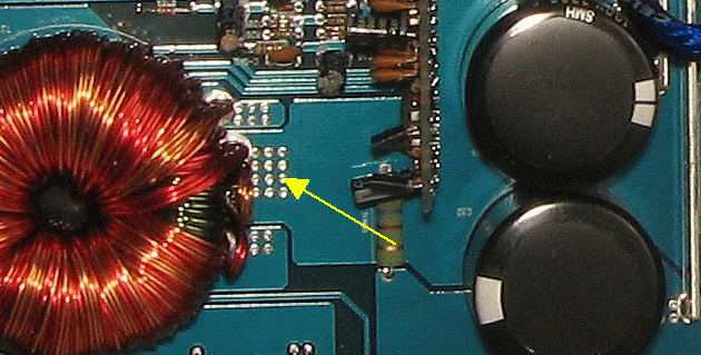

What is the resistance between the B+ terminal of the amp and the point indicated in the photo below? No power applied to the amp.

the resistance is 991 without power

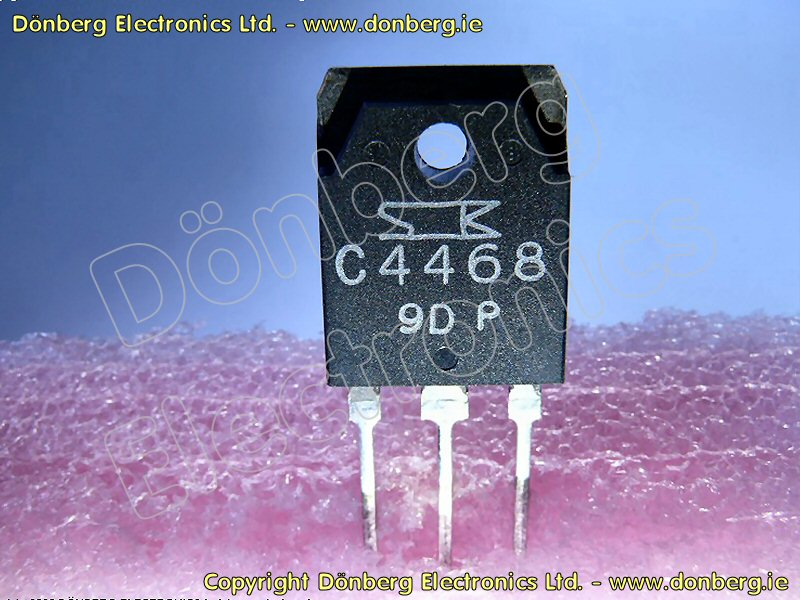

Can you post a photo of the transistor you removed?
Was the Q4469 or )4469 silkscreened on the board or was it on the face of the transistor?
Its apparently not a o or a q, but im assuming its a C
Because it looks exactly like this : http://www.electronic-spare-parts.com/pics/2/2sc_4468-1.jpg
The C4468 is the only mosfet that looks to be out of place on the board, Everything else looks correct.
