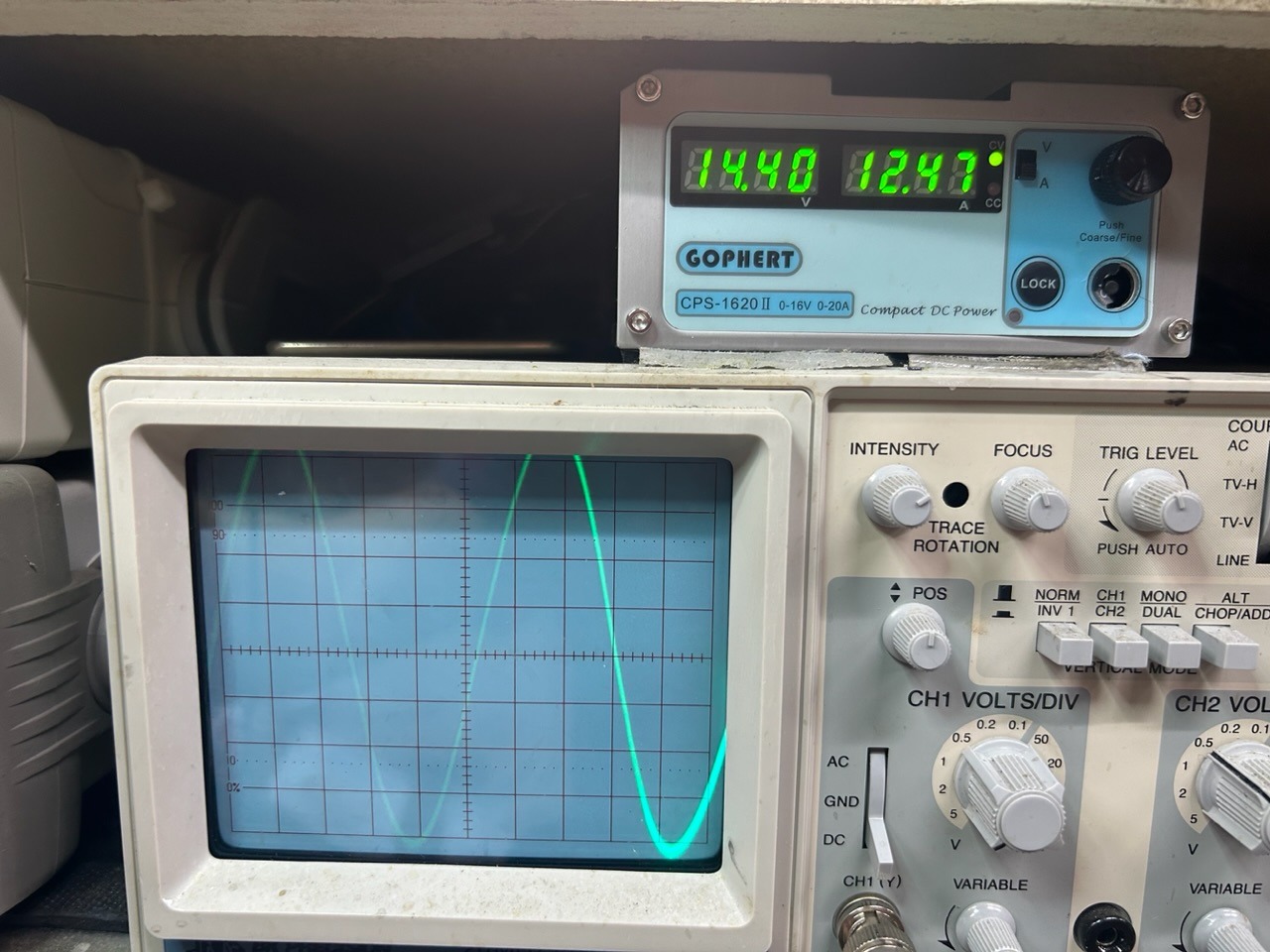

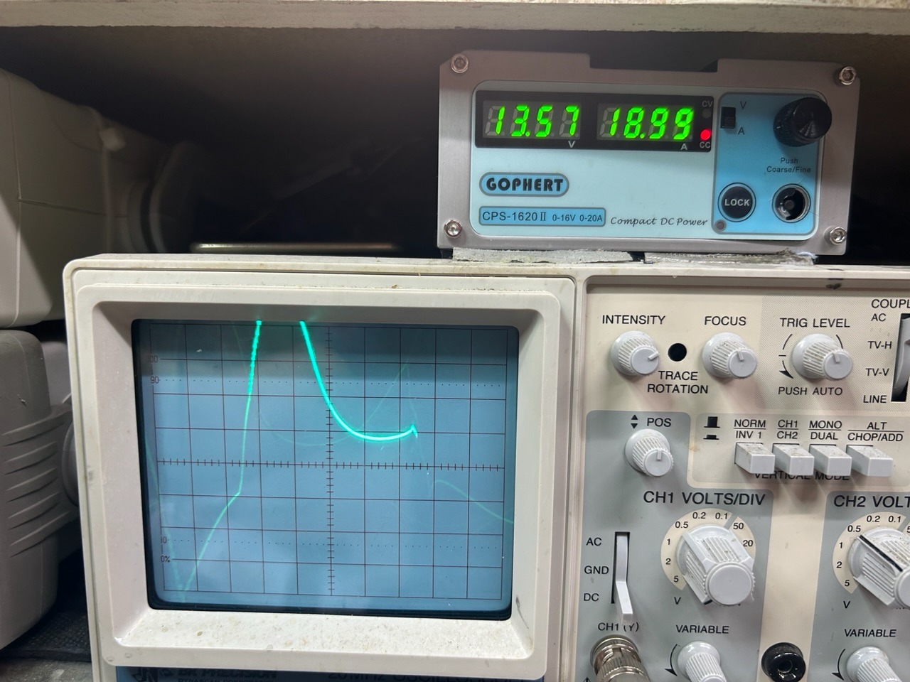

5v/Div. 100hz sine wave. Quite a bit of input voltage. You see the first photo the output gets badly distorted and pulls over current. The second photo is clean at ~13A.

Once the amp gets to distort, I cant bring it back down by lowering the input voltage. I must power cycle the amp.

Ahhhh I solved this one. My Gophert 1620 limiting PS.... I love it, but sometimes it acts up when supplying amperage close to it's limit (20A). Its a 16v/20A adjustable, limiting supply which is pretty nice, but in this case was not providing this amp with enough current. Usually that doesn't happen... Maybe 10% of the time it acts funny with hungry or in-efficient amps. Thats what I get for using a chinese PS. Its nice enough though. Not many in-expensive bench top supplies can provide that much adjustable/limiting current. I do recommend this supply for functional repairing though. Usually an amp won't start to totally freak out until it draws about 18~19A from this supply.
I moved this Brutus to a 100A supply and it worked fine out to clipping at 2-ohm load pulling about 75A
