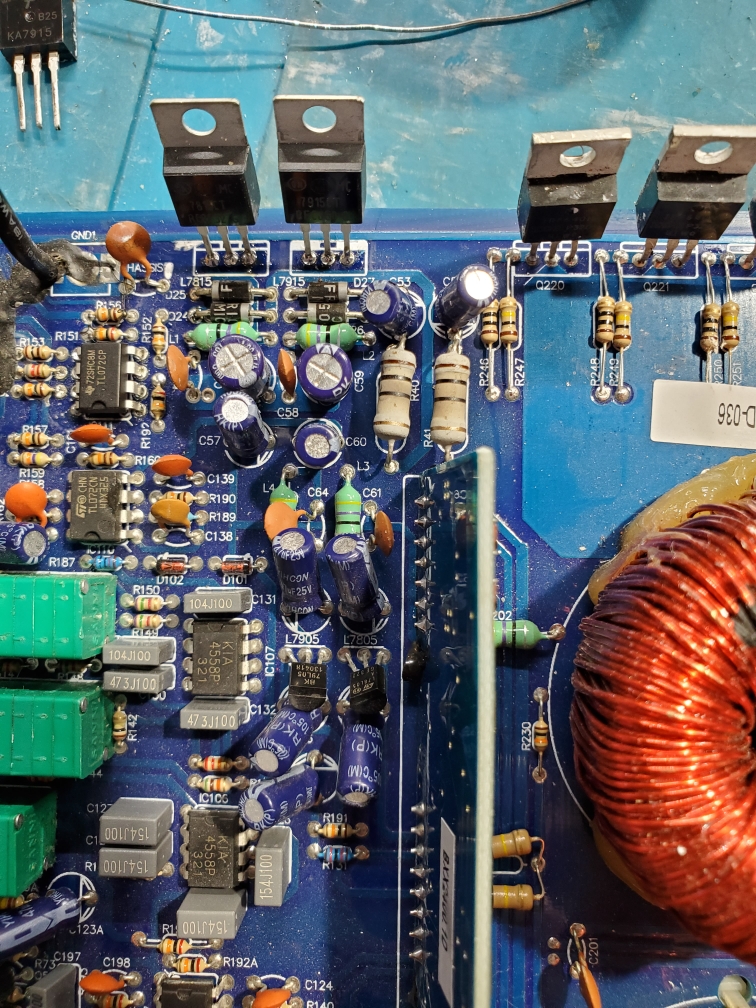

So without the rectifiers installed the 2 10R resistors near the +-15 regulators heat up very fast. They are connected to a transformer secondary winding it looks like.
All of my regulated voltage seems off. Should all the voltage regulation still function without the output driver card in circuit?
No rectifiers
I figured out one of the opamps an tl072 was in circuit in place of an RN4558, this caused a short across the -+15 circuit.
No rectifiers
