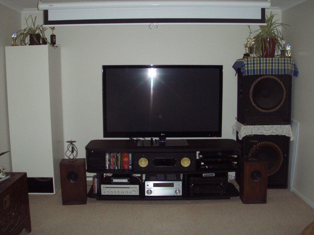

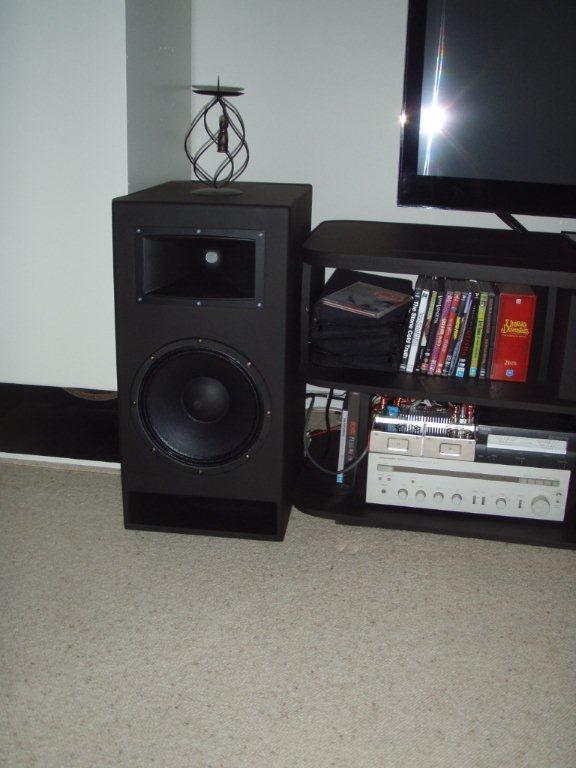

Have currently got two T3's running from SMPS's at 49V. One is driving a TH with a 15" 8 Ohm driver the other runs a pair of 18" ported cabinents in parrallel for 4 ohms.
Not having the T4 to compare all I can say is i consider the T3 to be a great little module that provides great bang for buck.
You can see the TH and bins in the attached photo.
The second photo shows one of the new fronts we have built that is currently passively crossed but we ultimately be driven by multiple T3's.
As you can see i haven't yet built a case around the amp modules.

I had the same dilemma with T3/T4 for my mixed sub setup and future use with active LCR setup. After pouring over the specs and doing costings i decided the basic T3 board was the better choice with the ability to better drive 8 or 4 ohm loads making the module more versatile over time with various drivers.
