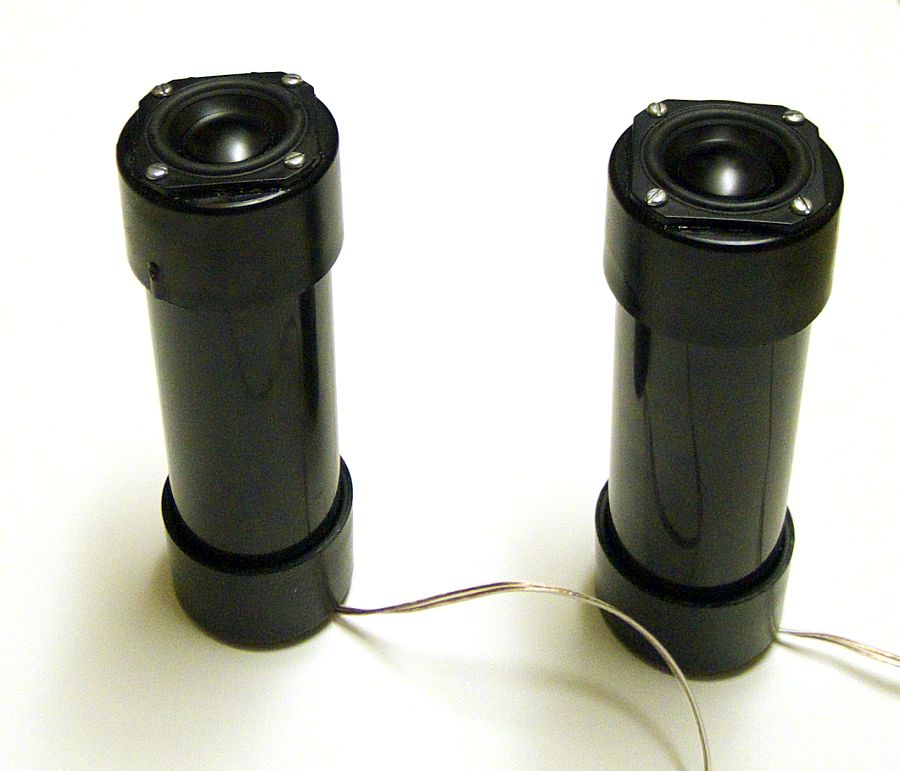

At the risk of you all laughing uncontrollably, I am currently testing the subjective audio quality with my two superb Peerless 2 inch 830983 widerange speakers in Linkwitz-inspired omnidirectional enclosures. My old TA2024 just didn't quite have enough power to handle the amplitude-compensation applied by my miniDSP 🙂 The T2 sounds clean and clear.. (speaker photo below)
These speakers form the basis of my traveling kit - HiFi for the frequent traveler 🙂 I intend to replace the T2 with a lighter-weight TDA7492 amplifier when it arrives 🙂
