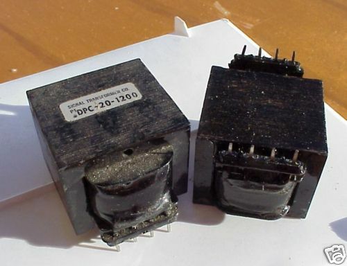

I haven't done any testing as of yet. I have a big box of Signal Transformer DPC-16-1500 Xfmrs that I got cheap (no pin #s marked on them). These are 120V/120V - 8V/8V. 1500V isolation, 24 Watt. Got them and several other voltage output models a few years ago when they were cheap. (not so cheap on EBAY now) Collecting dust, hence some creative thinking.
Several means of testing them come to mind. One could drive them P-P in class A and look for how constant the B+ current is versus the neutralization current.
Or one could put the same neutralizer circuit on both primary and secondary sides and just drive one side with a signal generator, observing the other side on a scope for flat-topping versus DC current match.
Another way would be to check primary inductance versus DC current (equiv.) matching between primary and secondary.
The C1 and C2 caps have to carry the AC signal current, so need to be big. (the LV power supply likely will already have a big cap on its output)
They can be eliminated however, by using four xfmrs (or secondaries) with two secondaries replacing the C1 and C2 caps. A bridge circuit then. (with the dual secondary DPC xfmrs, one can get away with just two xfmrs and no caps using the bridge form, on primary or secondary sides for DC testing)
With the secondaries effectively coupled together, one may approach interleaving effects, maybe. (leakage Ls effectively in parallel, but distributed capacitance in parallel too) Will have to frequency test the scheme. RC snubbers on the primaries would probably be a good idea though.
One could also add a little AC HF bias this way to mimic the HF bias of the magnetics on a tape recorder. (removing hysteresis and maybe magnetizing current too?)

Do I understand you correctly that the plan is to use ungapped transformers with standing DC current in the primaries, at least partially balanced with a roughly equal ampere-turns of DC in the secondary?
Yes, no gaps. DC flux cancelled at idle most likely. The one problem I see is 2nd Harmonic distortion in the output tubes will cause standing DC current to increase at higher signal amplitude. This could be minimized by using local N Fdbks to linearize the tubes.

The DPC-16-1500 Xfmr measures 0.6 Ohm and 0.7 Ohm on the 8V secondaries. (meter lead R compensated) The primaries measure 71 Ohm and 78 Ohm.
4 Xfmrs (24 Watt each at 60 Hz, series/parallel in the bridge config.) would allow 30 Watts at 20 Hz. Using some 6L6GC in P-P class A, they would be idling around 70 mA each. With 110V/110V to 8V/8V we can rig windings for 220V to 8V giving 6050 Ohm to 8 Ohm, approx, ( 8V windings would be more like 9.5V to account for 1.5V drop at full load of 1.5 A on each to get 8V out)
So 4290 Ohm primary to 8 Ohm secondary actual. 70 mA idle current would translate to 23 x .07 = 1.62 Amp equiv. at secondary. Then 1.62 x 0.65 Ohm (sec in parallel) would lead to 1 V IR drop for DC. (the full P to P Zprimary used in calcs accounts for the -two- 70 mA idle tubes I think)
Then for the bridge configuration we have 2 secondaries in series in each side, and 2 sides in parallel. So 2V drop at 3.24 Amps for the DC power supply. Not unreasonable if you use a 2V power supply. 6.5 Watts for DC.
One might want to use 6X Xfmrs to get the primary Z up to 6435 Ohms. (and 45 Watt audio rating) Then the DC supply would be 3V at 3.24 Amps. 10 Watts for DC.
The E-I lamnation internal gaps might handle the 2nd harmonic increase in DC at full power alone. But local N Fdbks may be needed anyway to drop the output Z.
The 2X 6L6GC giving 23500 Ohm /2 Rp reduced by the OT to 22 Ohms Ri for 4X Xfmrs or 14.6 Ohms Ri for 6X Xfmrs. Some local N Fdbks would be welcome to drop the output Z down another 5X to 10X, reducing 2nd harmonic DC by a similar amount.
So it seems practical for class A. Cost me $3 or $4 each in quantity for the Xfmrs as I recall. (like 10 years ago) It does require rather more wiring up, but these are PC mount. (NOT so practical however with EBAY pricing on them currently, $7.80 to $15.50 each, but maybe a quantity deal can be found, there are lots of other surplus types out there.)

The double primary and double secondary configuration of the DPC Xfmrs allows one to interleave the primary sections into each tube current path, as some have been doing with toroid power xfmrs lately. So that balanced DC operation can be obtained in the conventional way on the primary side. This does lead to higher distributed capacitance typically, when more Xfmrs are used in series. (dual primaries usually don't have great insulation between them, and can even be wound bifilar. )
The Signal Corp DPC-16-1500 Xfmrs I have measure 265 pF common mode between the two primaries. And 220 pF common mode between dual primary to dual secondary. Some EWC DPC-40-600 Xfmrs I have have higher primary to primary capacitance, 379 pF. (and 330 pF primary to secondary)

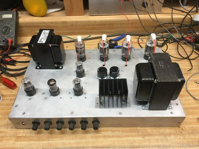

By the way, I just got in some Edcor 60 Watt 3.3K to multiple secondary OTs, for those TV Sweep tube enthusiasts out there. Should be on Edcor's standard product list soon, after they finish a revamp of their website in progress. I wanted something available for the smaller to mid size Sweep tubes, like 6DQ5, 6HJ5, 12GE5, 12JN6, 21HB5, 17KV6, 12GT5, 17JT6, 22JR6, 22JG6, 21LG6, 6EX6, 6CD6..... The bigger Sweeps already have a 100 Watt 3.3K and 2.5K OT available. There is a 60 Watt 4.2K OT there already too.
The 6DQ5 tube actually belongs to the "big" tubes according to the output power criteria, because I got 100W of output power with it in a practically realized amplifier. This amplifier has been operating for years without failure and the need for frequent changes of output tubes (which speaks in favor of not being overloaded in real amplifier operation) with Ua ~ 600V, Ug2 = 150V (stable), -Ug1 ~ 45V, Ia ~ 2x30mA (without signal) with primary transformer output impedance Raa ~ 3800 Ohms. In practice it is a 200W amplifier with 4 pieces of 6DQ5 and an output transformer of Raa ~ 1900 Ohms, and the excitation on G1 is without lattice current (Class AB1) with Ug1 ~ 2x40Veff.
In the beginning, I started this amplifier with 6HF5 tubes, but they are relatively difficult to find at reasonable prices, so I replaced them with 6DQ5.
In practice, I did not notice any differences between these tubes in this amplifier, although the manufacturers state that for 6HF5 the anode and G2 dissipation is higher (Pa = 28W, Pg2 = 5.5W) than the 6DQ5 tube (Pa = 24W, Pg2 = 3.2W).
I guess the 24+ Watt rated tubes like 6DQ5, 6HJ5, 17KV6, 21LG6, 6CB5 ....
can do over the 60 Watt level for P-P without much trouble. (600V B+ helps the efficiency!) All depends on how conservatively they are run. I think George gets some hefty Watts out of those dingbat cheap 15 Watt 6DN6s (later ones rated 20 Watt apparently) and unreasonable Watts with little 6GF5s too (hopefully with some cooling fan).
By the way, I've seen a few of those "odd" winged 6DQ5s go by on Ebay in the last 1/2 year. I asked at Vacuumtubes.net if they had any, but they said they hadn't seen any.
18 Watt sweeps are probably fitting the 60 Watt P-P OT better. There was an obvious hole in Edcor's OT lineup for 60 Watt before without the 3.3K model. Although 4.2K was there for the 18 Watters. Another hole remains at 5K 60 Watt.
They had the 26DQ5 at.vacuumtubes.net earlier this year. Bought my spare set for this and a couple more to play with. He said he still had some left.
6 volt are always more expensive, so I didn’t inquire. Custom trafos give one the opportunity to use whatever heater you can get.
