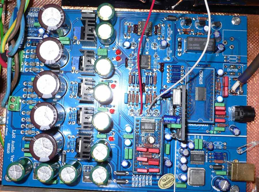

The receiver chip is indeed a CS8416, mounted on its own removable board. The DAC likewise, though the board is double sided, very small signal paths, so I doubt I'd be able to rattle up an equivalent. That leaves me with unsoldering the dac and soldering in a new one (assuming its the dac that's fried). There are the two OPA 2604au on the underside as well. Sounds like I'll likely fry the new DAC doing this (given my abilities).
Here's a snap of the board. I found zilch about it on the web (but only from a cursory search on Google).

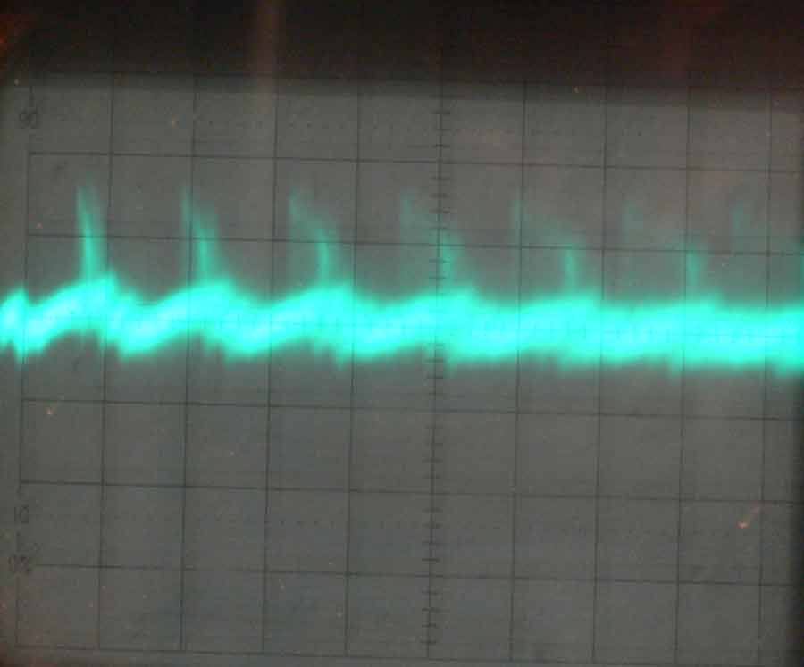

Attached is also a bad image of the I-out output signal. My scope is having a bad morning, and I couldn't hold the probe (discharged this time), camera, and adjust intensity/focus all at the same time. Apologies. The chip is seeing whatever load the manufacturer put on it. The settings are 1 microsec/div, and 10mV/div. The basic pattern seems to be the same on both channels and on the Vout as well.
I suspect you are on a loser with this tbh...
But never say never... if it helps, SMD is workable but practice on something else first.
